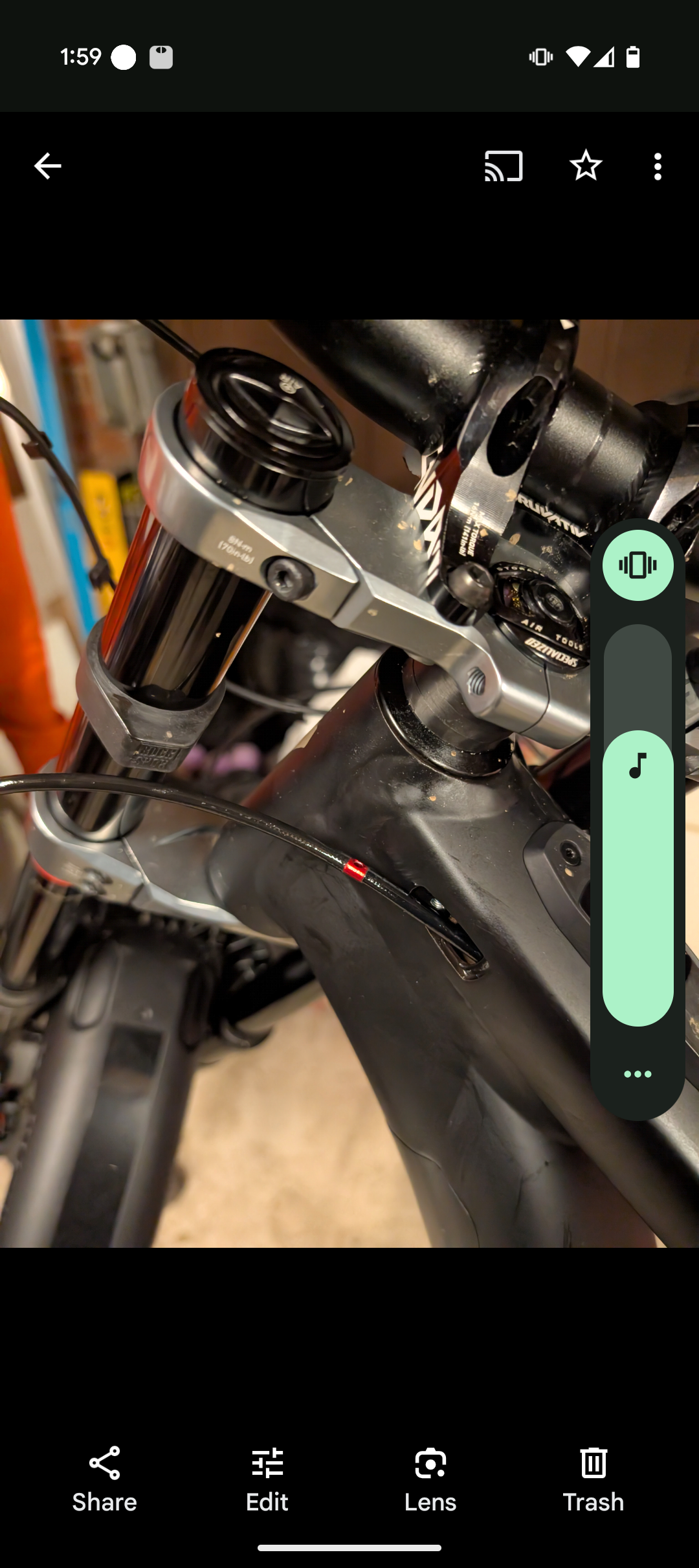

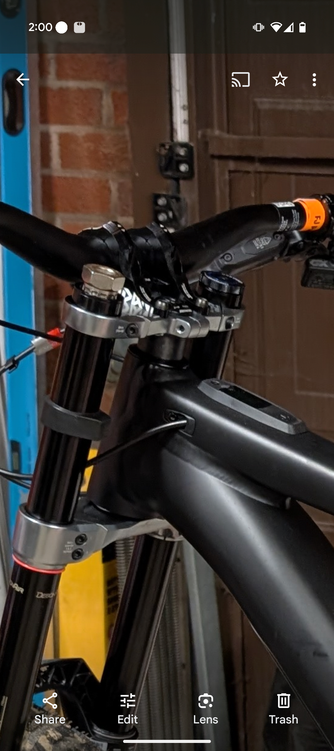

On a slight tangent...
Does anyone know if I can fit another spacer under the top clamp here to raise the effective stack height?
I've been quietly sweating that I've sized too small, but reach is 6 mm more than my M-L Slash, which felt perfect.
Stack seems to be the issue, as the stated numbers give the Slash 15 mm more. I think it had slightly more build up as well. I don't think the stem is any shorter.
Do I need different bar clamps/stem?
Don't really want to change the bars.
Screenshot_20250321-135815.png Screenshot_20250321-140039.png Screenshot_20250321-135936.png Screenshot_20250321-141351.png
better to space the stem / handlebar clamp up from the top-crown (would need spacers & longer bolts x4) especially as the steerer-tube looks to have been cut short & possibly flush wth the top of the crown???
Rich.
Rich.
Oh 5#it yea of course.
I'll see what I can do with the new fork.

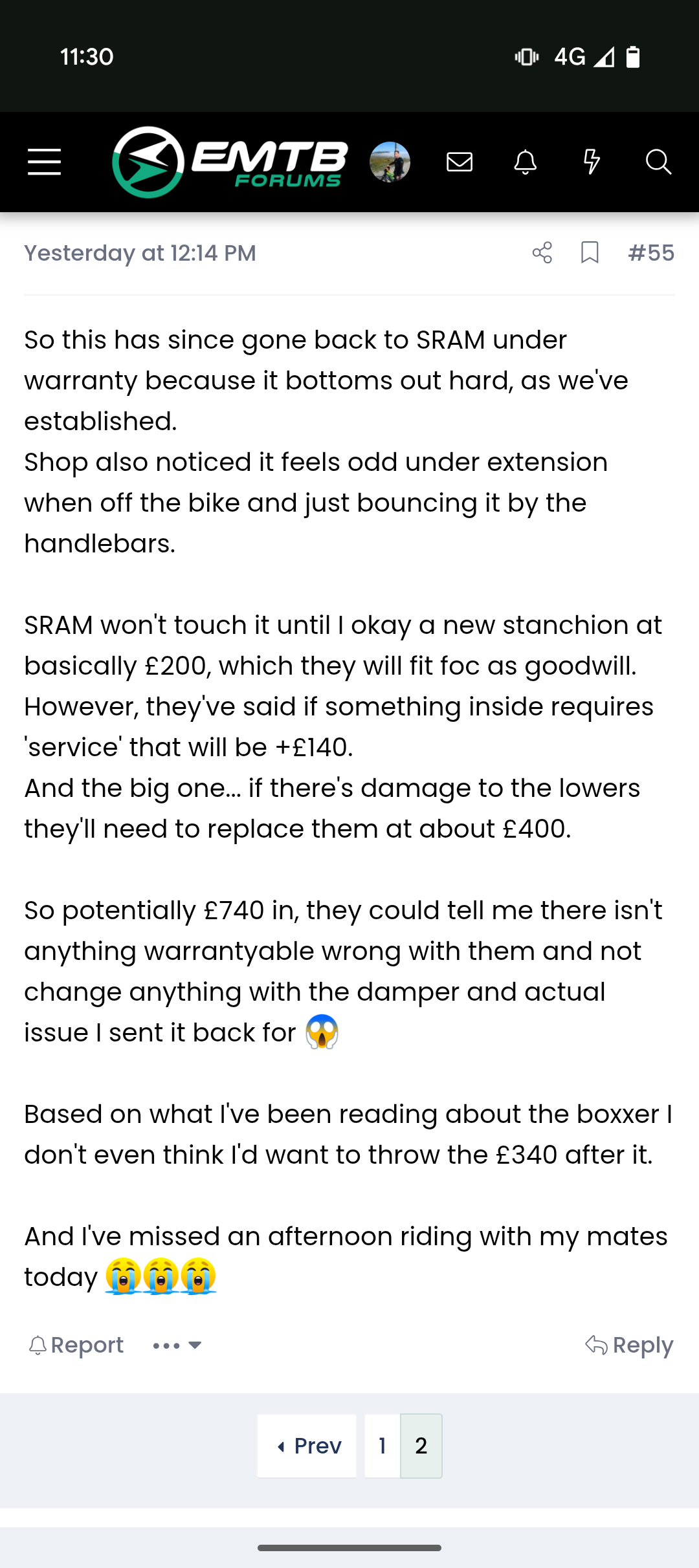

From what a RockShox have said now they've got the boxer back, I think I'm going to bin it 😭

That's 100% exactly what I have from them in writing.
They say this is on grounds of safety, as would be assembling and sending back out a faulty product.
Can see what they mean I suppose, but its a lose-lose situation.
