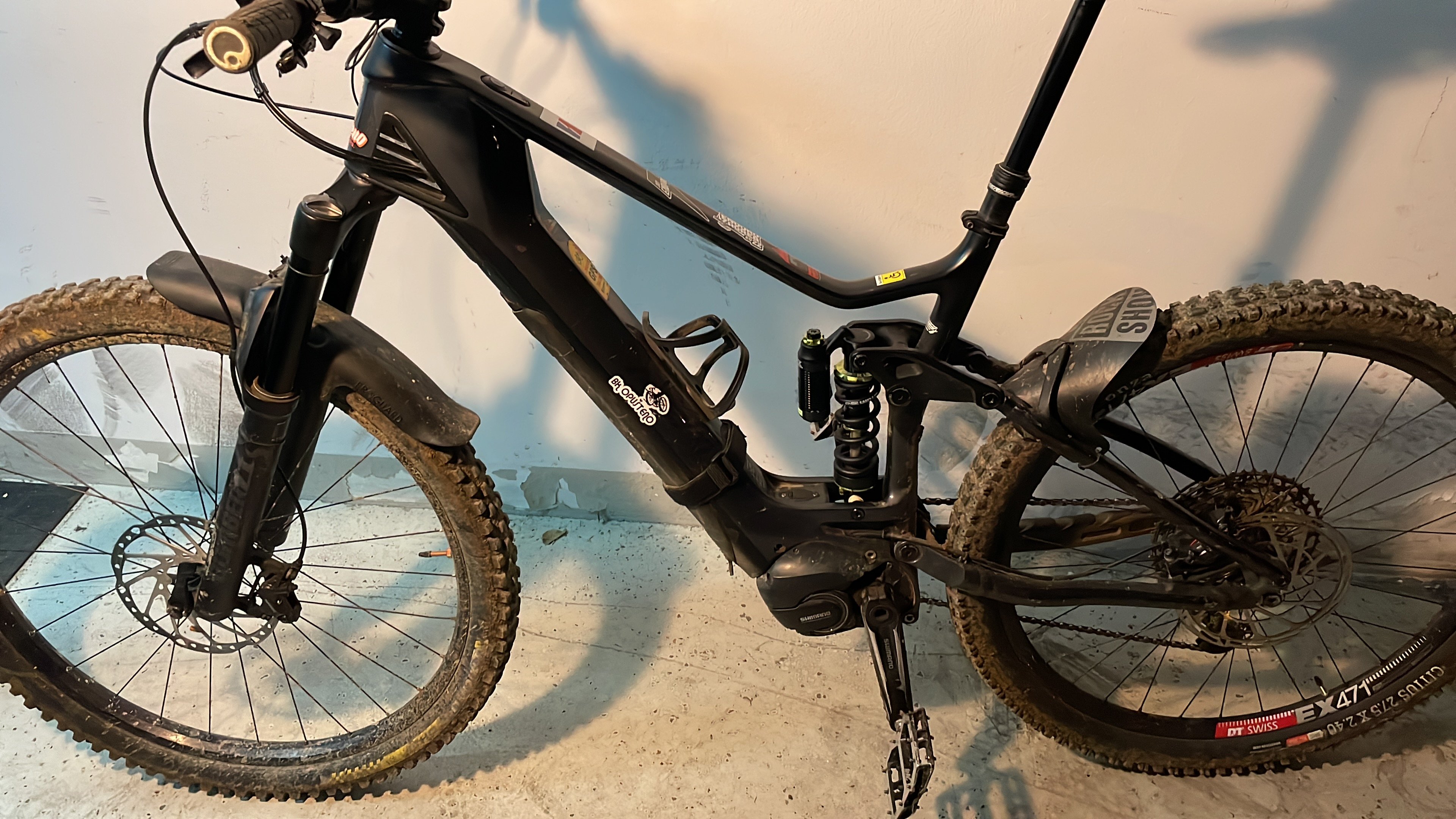

Got one fitted to my 900e yesterday.
Few small challenges. Thanks to covid I could only get a 205x60, this isn't a huge problem. Under the bump stop is a 5mm delrin spacer. Carefully snip that off.
Well, that didn't go 100% to plan, I accidently knicked the damper shaft resulting in a small scratch. Fixed that up, some 1500grit sandpaper and some nail varnish. Should keep the seal in check.
The preload adjuster and spring comes close to the downtube, but it clears by 4mm which is fine. A longer spring (I'm using a fox 500lb steel at 140mm) could hit the frame.
So far, the driveway test was very impressive. People think i'm nuts for replacing a fox X2 with a cheap marzocchi but we will see.
So far, the driveway test was very impressive. People think i'm nuts for replacing a fox X2 with a cheap marzocchi but we will see.View attachment 40343View attachment 40343

This post got me thinking and this is the result:
