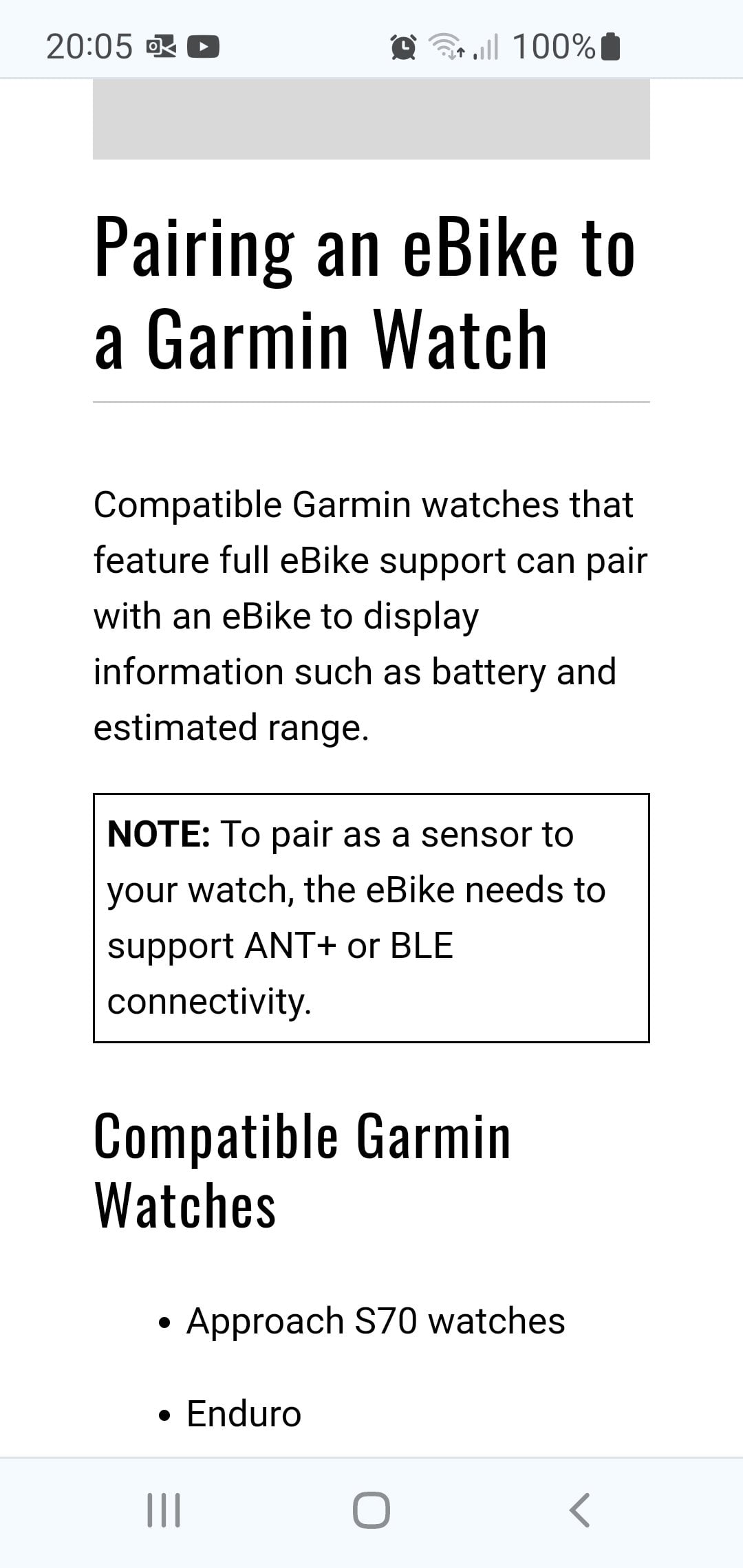

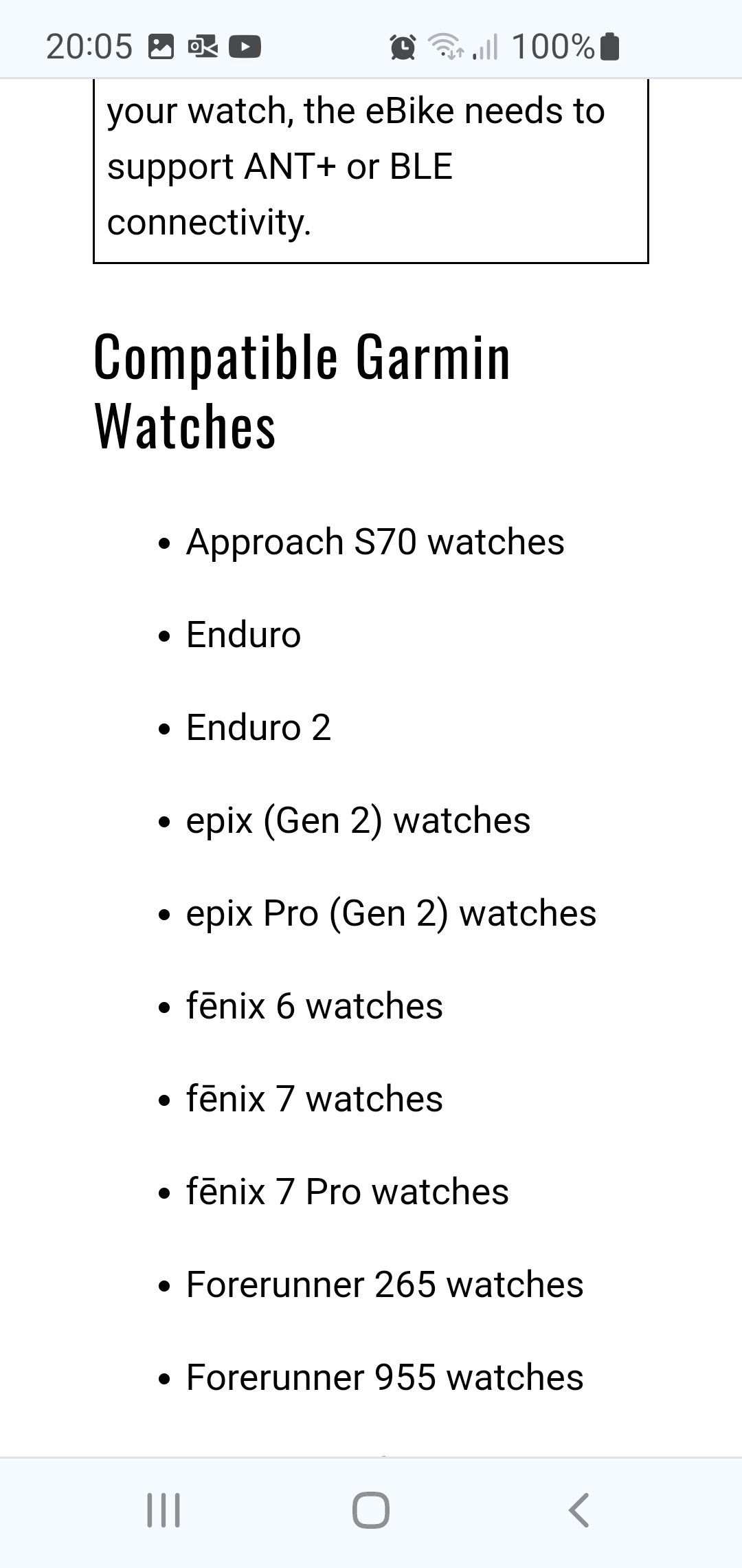

Didn't know that ANY watch can show your BIKES battery level, got the top of the line Garmin Epix and only shows how much battery life the watch itself has left. Think it shows gears on the bike IF I had electronic shifting :ROFLMAO:
Epicx gen 2 and epix pro have rbike fields that show battery%
Range. And speed and distance etc.
Just found on garmin site
Just had a look but can't seem to see it anywhere in their owners manual pdf on line. If your still on line can you give me a clue as to where you saw that info ples
Off tinterweb
