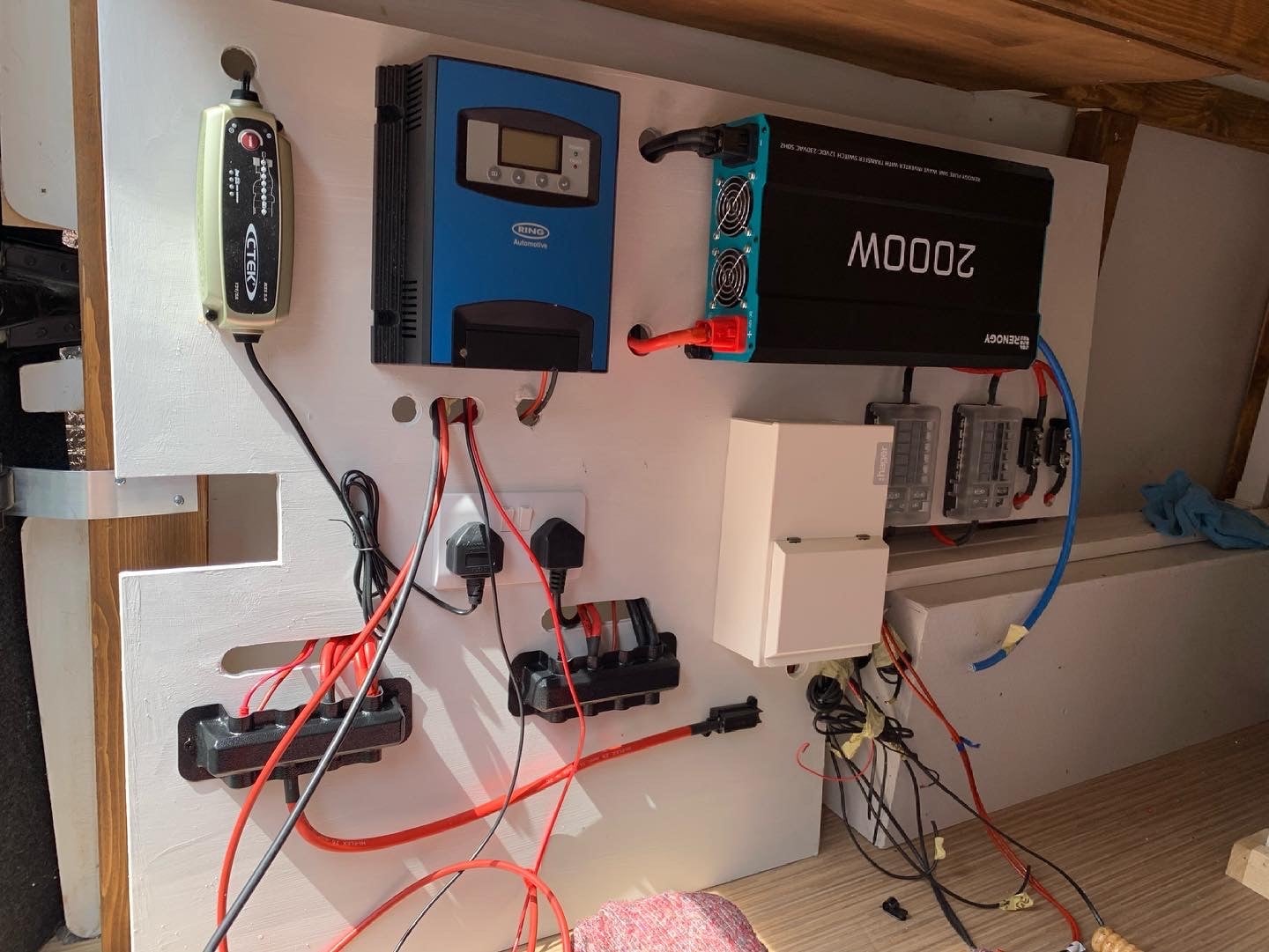

We are in the final stages of a camper conversion so Ill be charging from a 2000Watt inverter with 2x 100ah batteries, with solar and b2b charging to top it up
