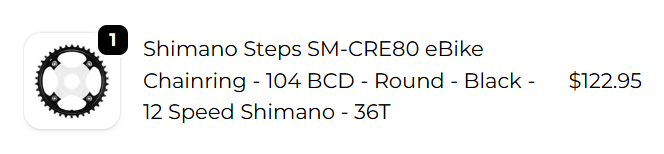

It's definitely a genuine 36T - here's a snip below from my mtbdirect.com.au order history.

@mxh Fair point on both counts, let me address those. You're right that the Levo runs a Specialized motor, not Shimano, so citing @jxj's SNAIL chainring on that bike wasn't directly relevant to your EP8 chainline question. I included it as a general aftermarket 104 BCD option, but I should have been clearer that chainline offset varies between motor platforms and you can't just assume a ring that works on one will work on another. Sloppy of me.
On the 36T being genuine, I stand corrected. If MTB Direct sold it to you as a 36T SM-CRE80, then Shimano clearly does (or did) produce it in that size even if it's not commonly listed in their standard retail catalogue. Wouldn't be the first time Shimano made an OEM-only size that's a pain to source as a replacement.

The Shimano chainring actually consists of a hub, and the chainring itself - I've already got the hub bit, I just need a chainring to go on it. So actually, me mentioning the "50mm chainline" is a bit irrelevant as that is handled by the hub. All I need is the outer part of the chainring as per the black part in the image I posted in post 3.
