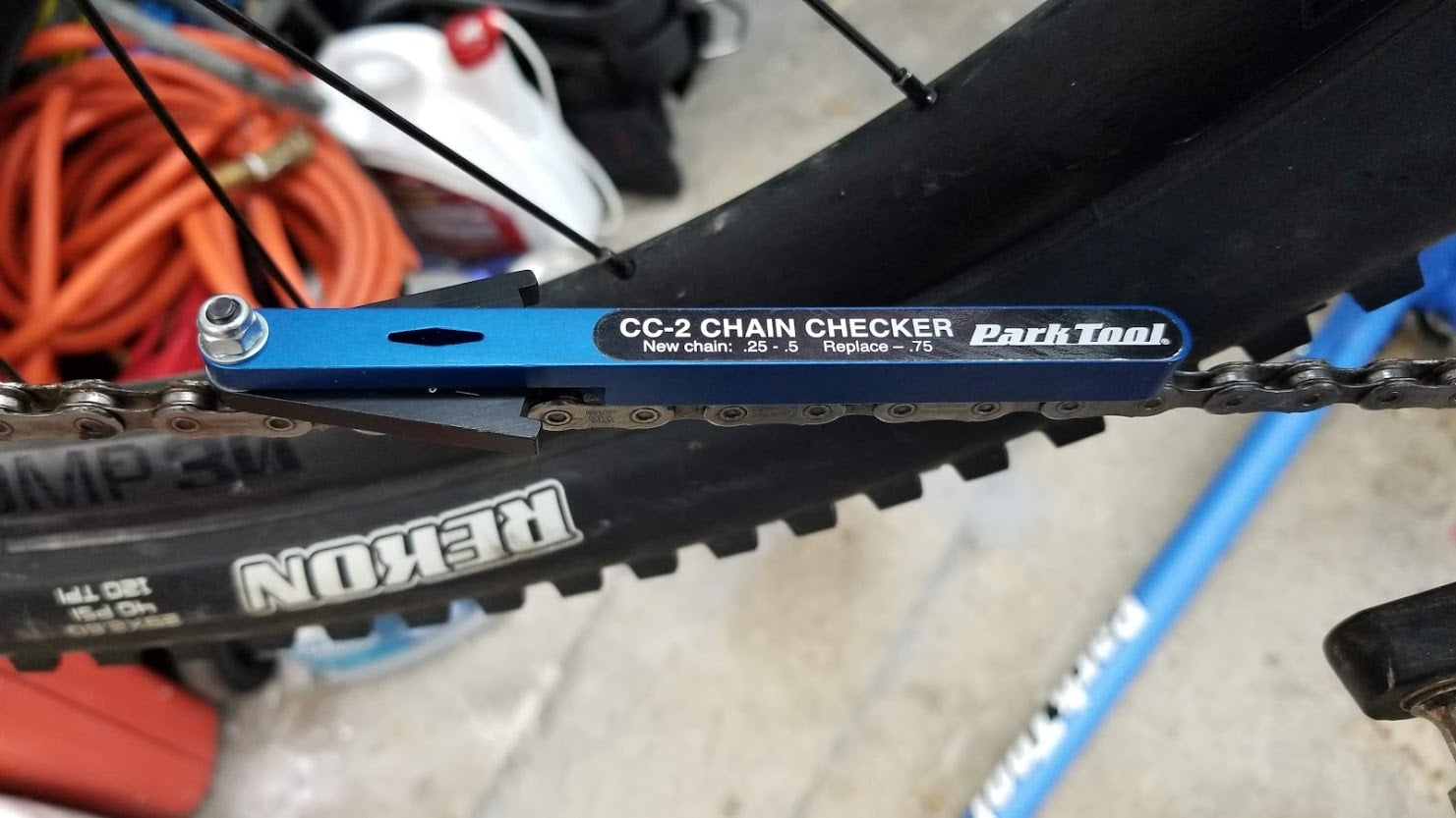

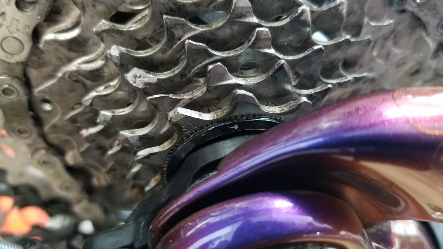

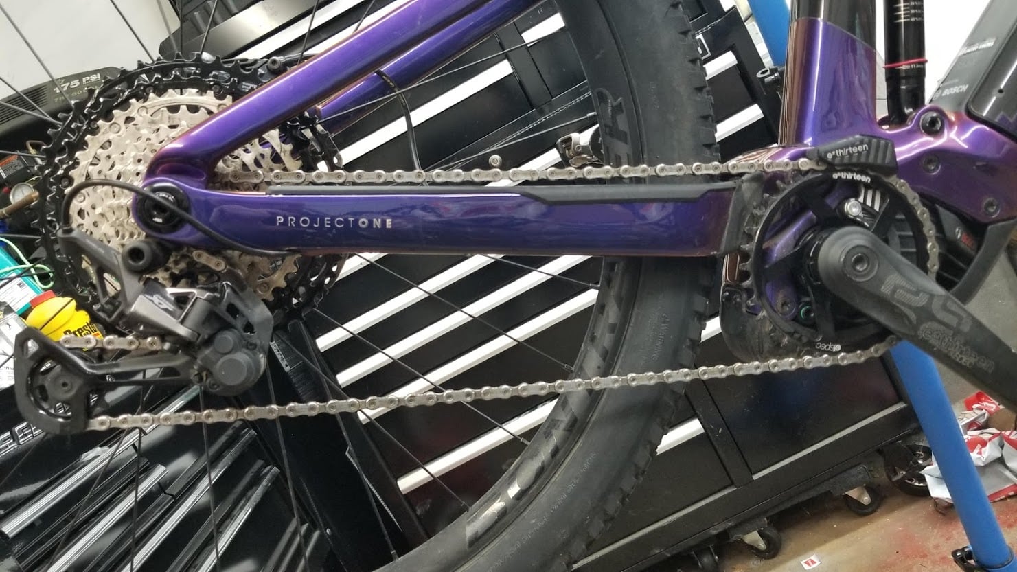

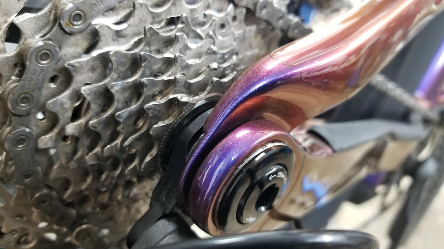

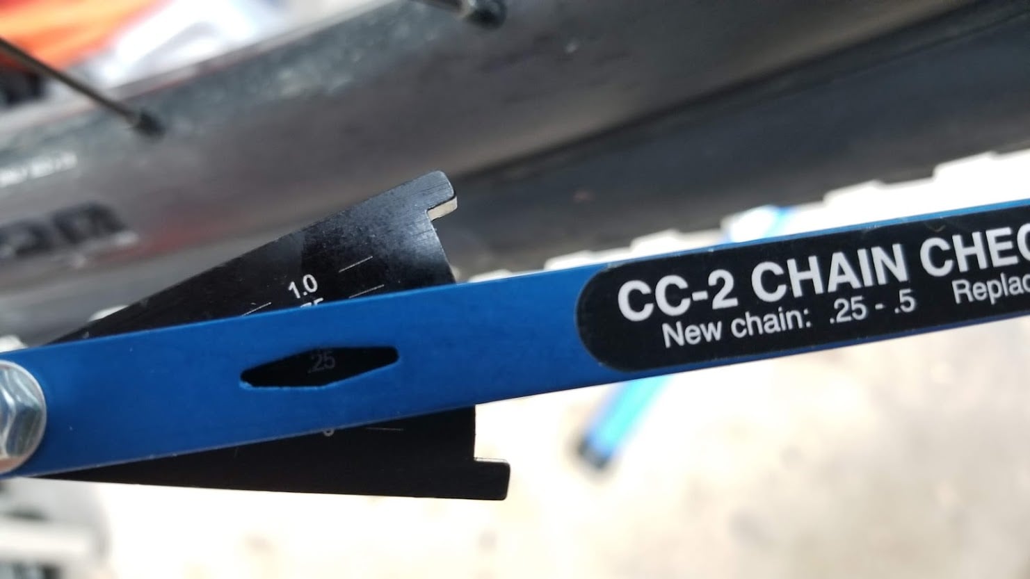

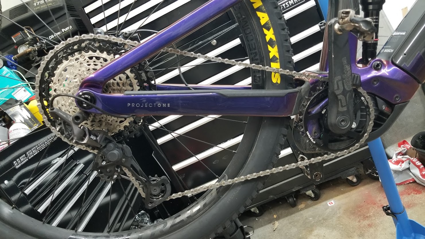

View attachment 60566 View attachment 60567 View attachment 60568 View attachment 60569 View attachment 60570 View attachment 60571
How have you done that to a cassette in 300 miles POWERING up step hills in turbo?
I have 1k miles on my orginal chain and cassette with hardly any wear and I ride in the Welsh mountains ⛰
Phantomx0_1
Feb 22, 2021
27
Berkshire
Another 30 miles in and the slip is back. It's definitely chain slip. Check out the video. Ignore the rust and the sandals. It was a spur of the moment gopro clip just after washing the bike tonight and was about 35C outside.
Knackered cassette from the pics below. That's some serious wear in 300 miles ?.
