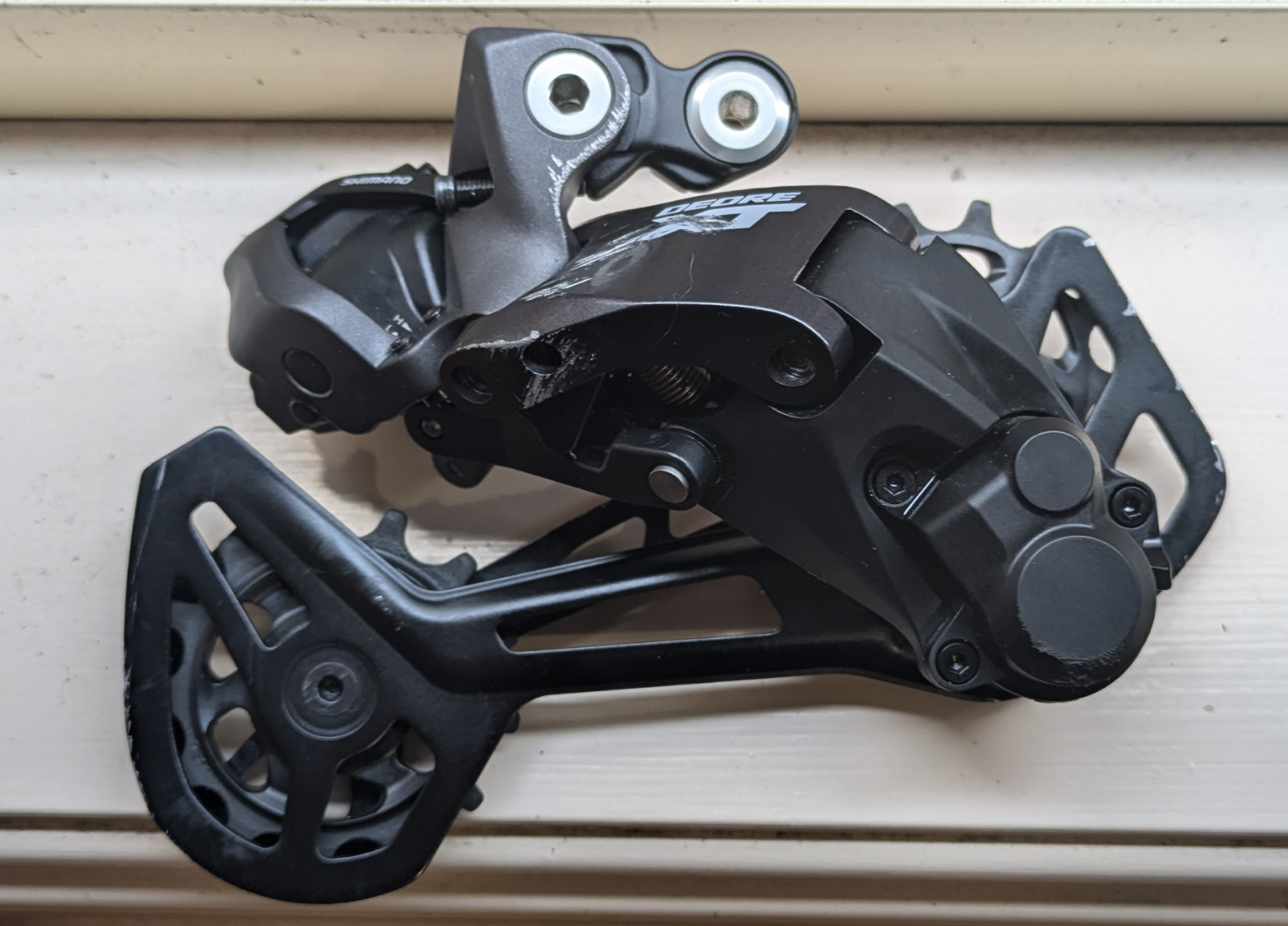

I also thoroughly cleaned and lubed the Electronic Derailleur, including the Electrical Connection.

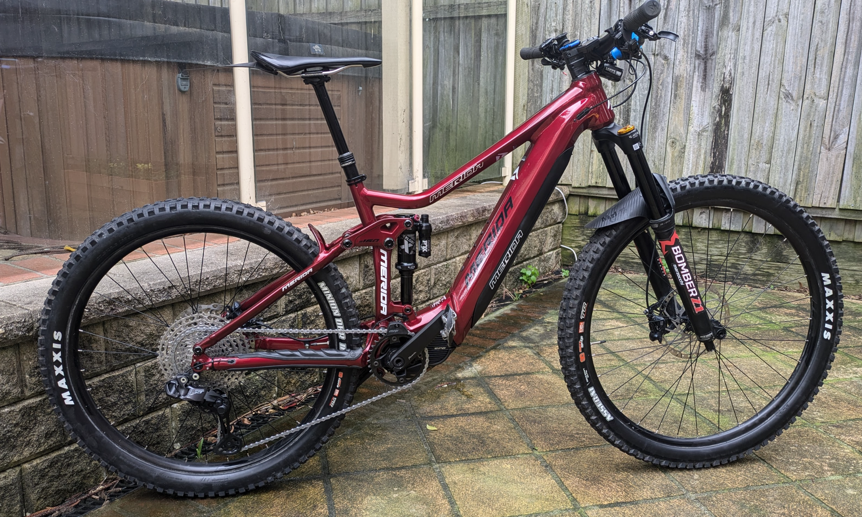

Then reassembled it all, and lubed it with Squirt. The chain, chainwheel and cassette were gleaming, and I expect them to stay that way ...... :LOL:

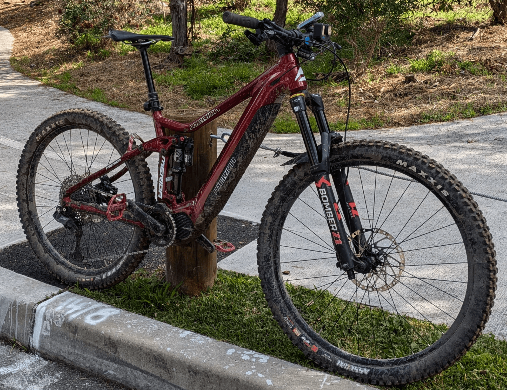

This is what the bike looked like yesterday. So ........ much effort has gone in.

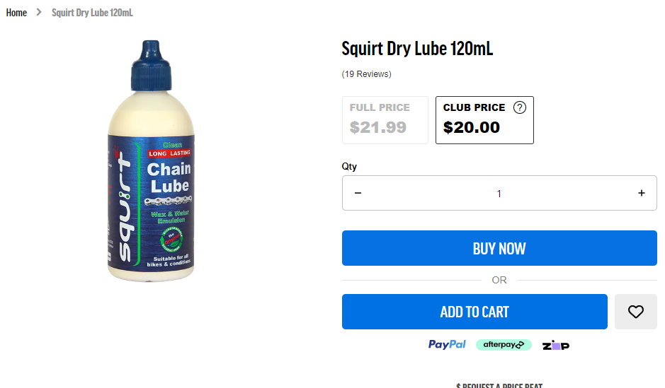

The bottle of squirt cost AUD$20. It should last a long time.

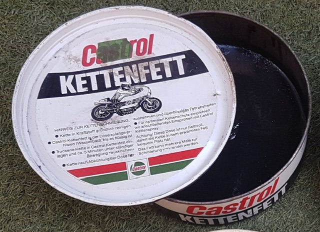

Chain grease in a tin
