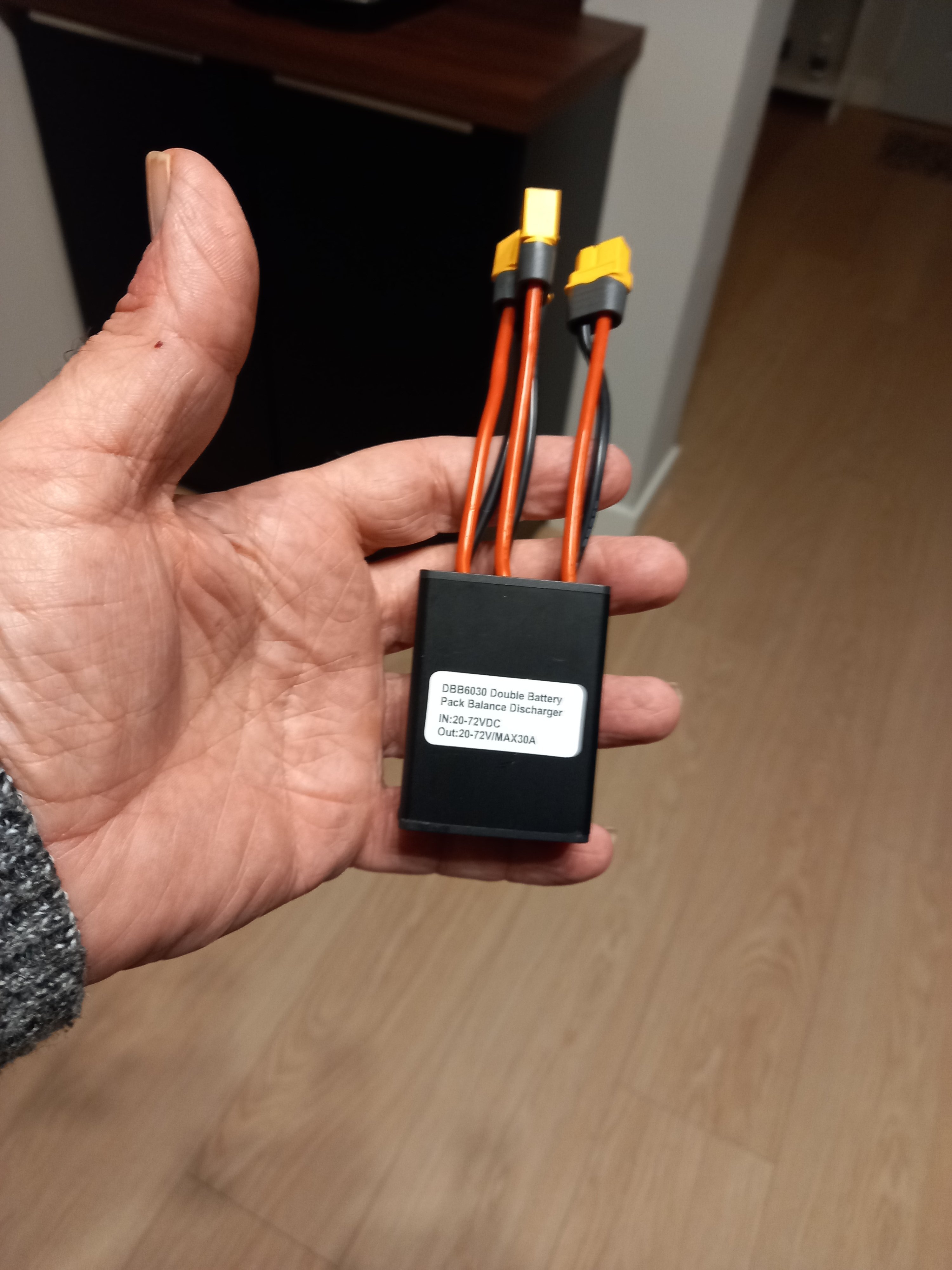

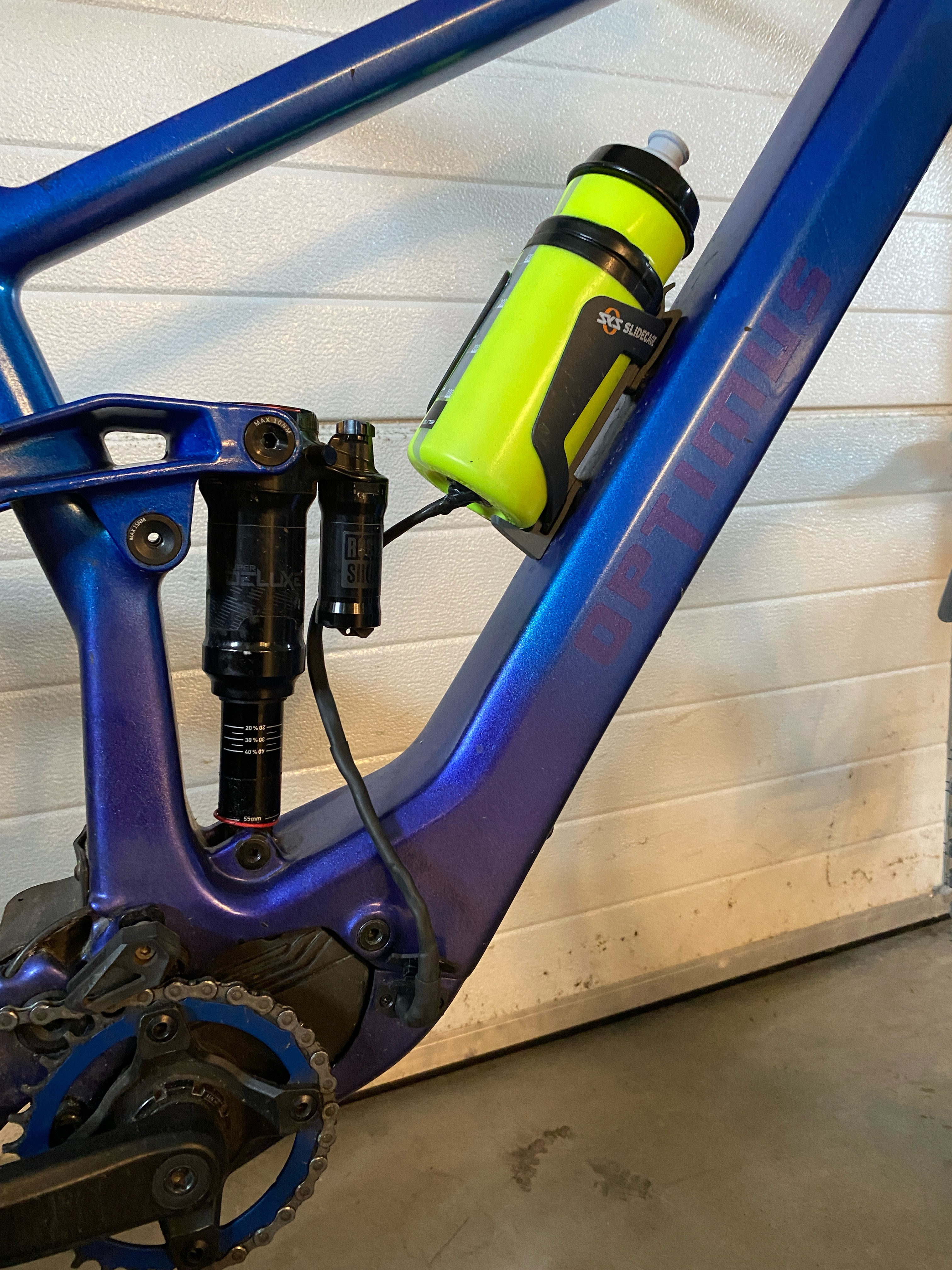

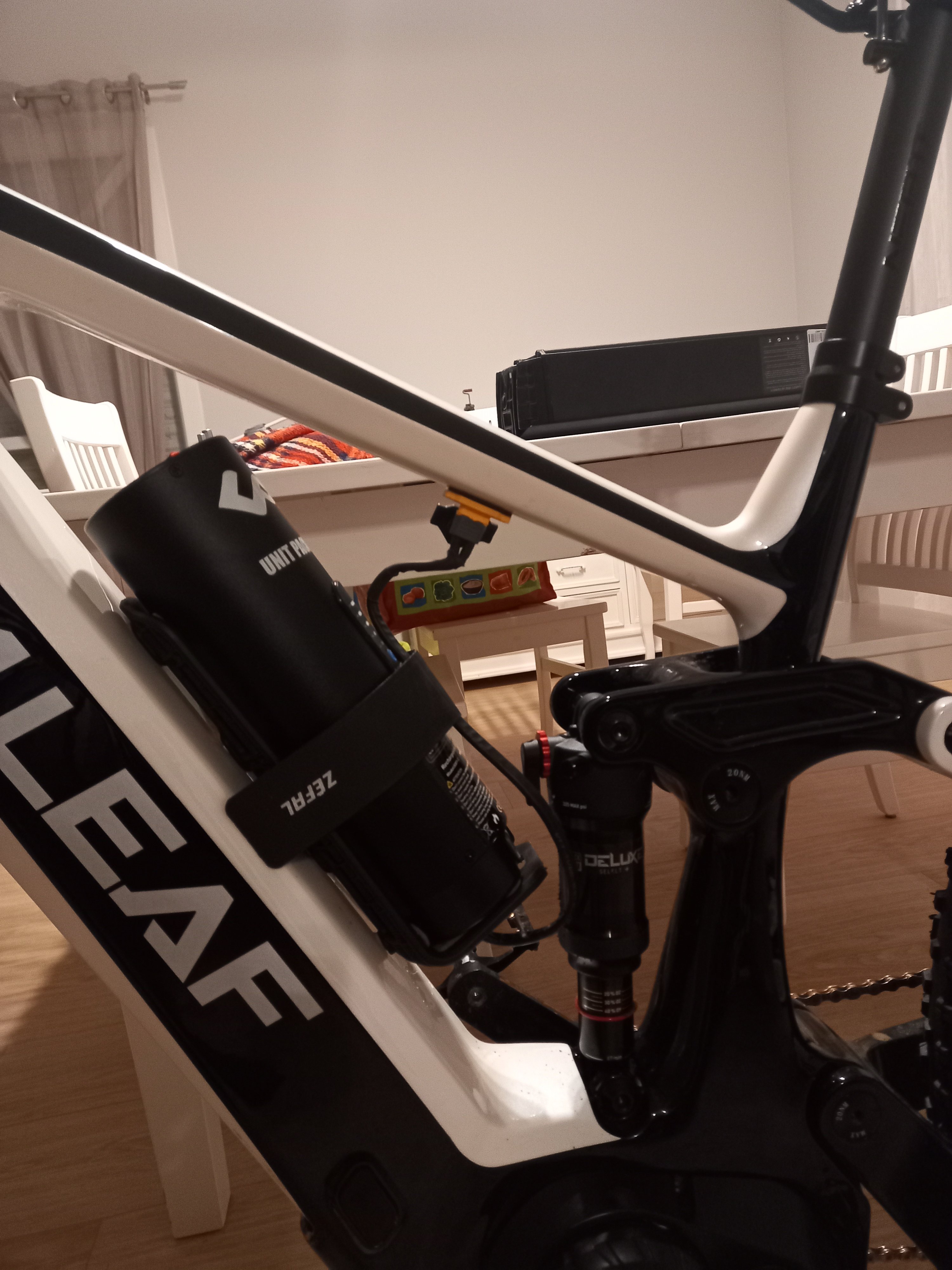

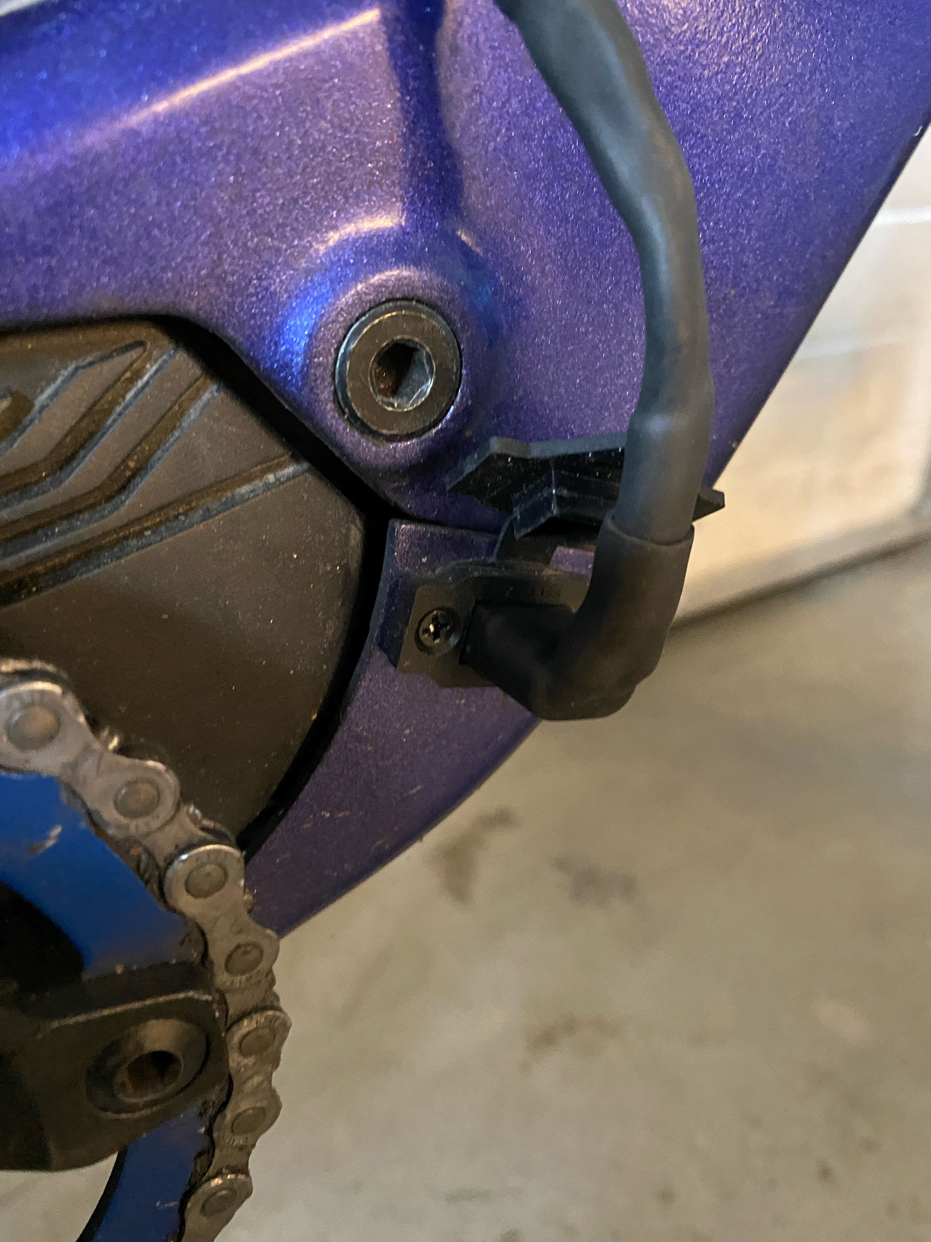

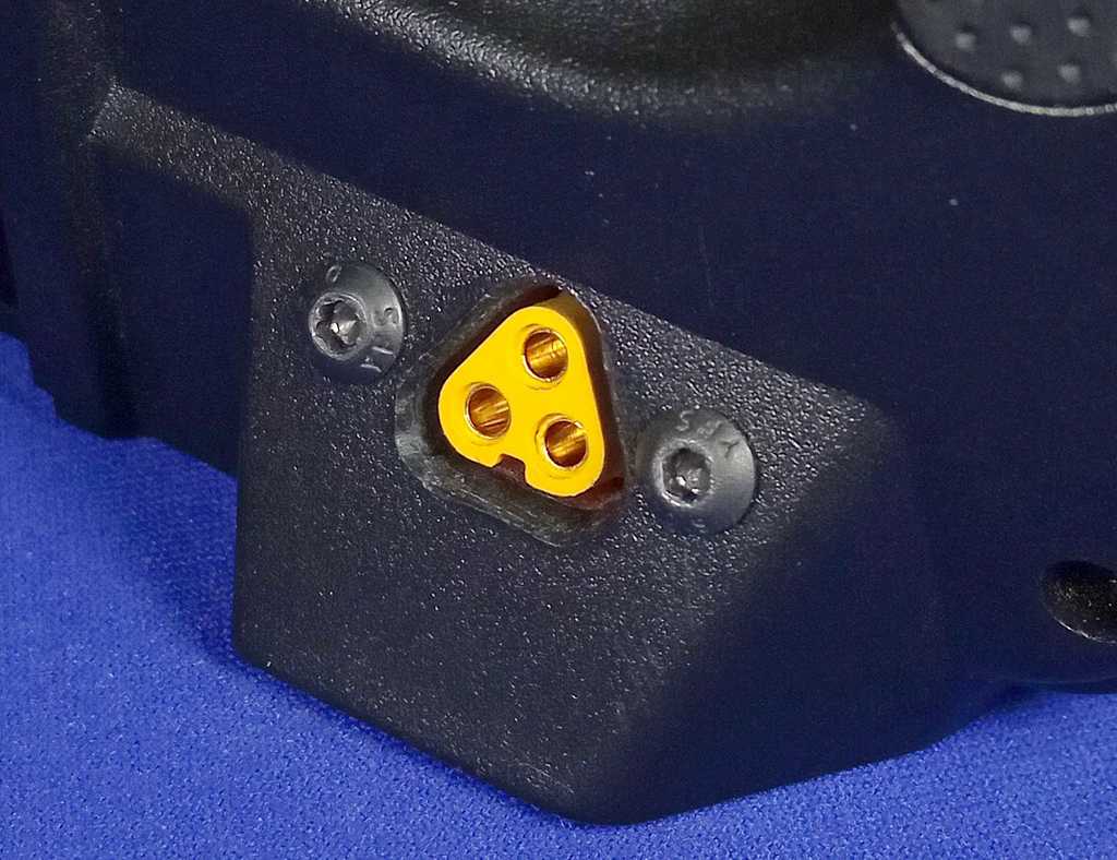

Off-topic, but I finally built an extender for my LCE930. It is a 13S1P battery with 2170p cells. Connected with a battery balancer between main- and extender battery to motor.
I didn’t want to make additional holes in the frame and connecting via charging port seemed too complicated, so I made a hole in the motor cover. Might well work on the Cef50 as well, it has been a lot of discussion about those!
Cable could be a few centimeters shorter for perfect fit. One benefit from a smart bms on the main battery is that I can switch it off and run only extender if I want to.

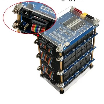

Looking at the attached PDF had me questioning whether we need 4 ports or whether we could make do with 3. In the diagram the diodes are only controlling the positive sides and the 'main' negatives bypass the circuit boards.
Is the any reason I cannot connect the charging negatives with the main and extender negatives?
Therfore I end up with a socket in the frame that has 3 ports, 1st port is a common negative shared by main battery charging and extender -ve, 2nd is the charger +ve to the main battery BMS, 3rd port would be the extender +ve.
Obviously the Extender battery plug would have 2 wires and so would the charging plug, common negatives but different positives.

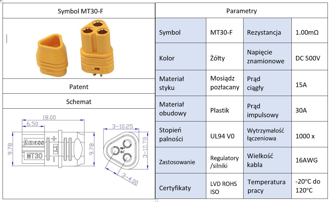

An Amass MT30 socket could be installed in the existing charging port with a bit of 3D printing trickery.

Since you are not charging and using the external battery at the same time you can probably get away with that. But you need a connector that supports big enough wire for the current required and the connector is not going to be designed to solder two wires to the same point. You don't want to do anything that causes a bad solder joint that acts like a resister.
Thank you.
Good catch on the cable sizing, XT30- 16AWG max. The M820 has an XT30 socket for the battery I think.
Plan is for a 13S 2P battery which in theory will give a continous 25A max.
People are reporting seeing 550watts in Boost, maybe allow 600w using 48V battery on a 43V motor/firmeware.
600w/48v = 12.5A, 16AWG seems possible but feels counter intuative.
I am not sure where they are getting those numbers. Lets face it, it is a 250w motor. The question is can you get two 16g wires in one of those sockets with a solid solder job.
I think the whole 250w thing is similar to the VW diesel emmisions fiasco. Even allowing for gearing etc. I doubt alot of these ebike motors quoting 75nm+ are only doing it with 250w.
Not a 'cat in hells' chance of getting 2 wires on those terminals, was not planning to either, an XT60 inside or an extra connection on the BMS or combination of both etc.

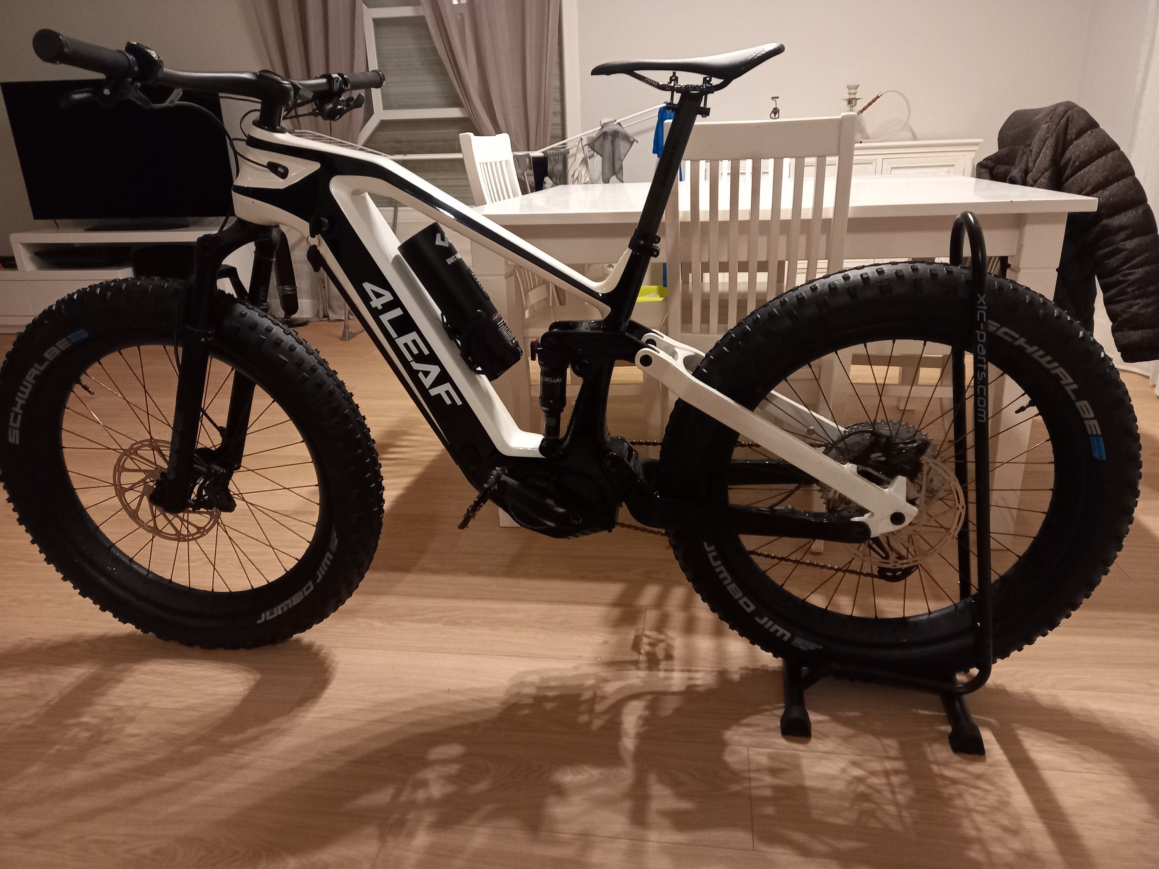

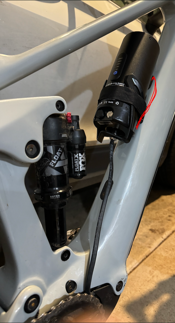

A couple of further thoughts. With my new 720wh battery came a battery-off switch that fits in the top tube opening of the stock frame. With that you can simply solve the dual battery problems with just turning off the internal when you switch to the external and vice versa.

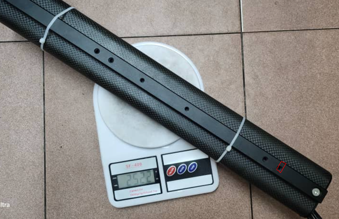

Also for traveling I am working on an external that using a frame made for individual 18650 cells. You can't take emtb on airplanes with internal batteries but you can take individual cells on the plane in the cabin. So I have a battery box that holds 30 cells and the frame that I assemble at the destination which has the battery holders and all the BMS etc for a battery pack.

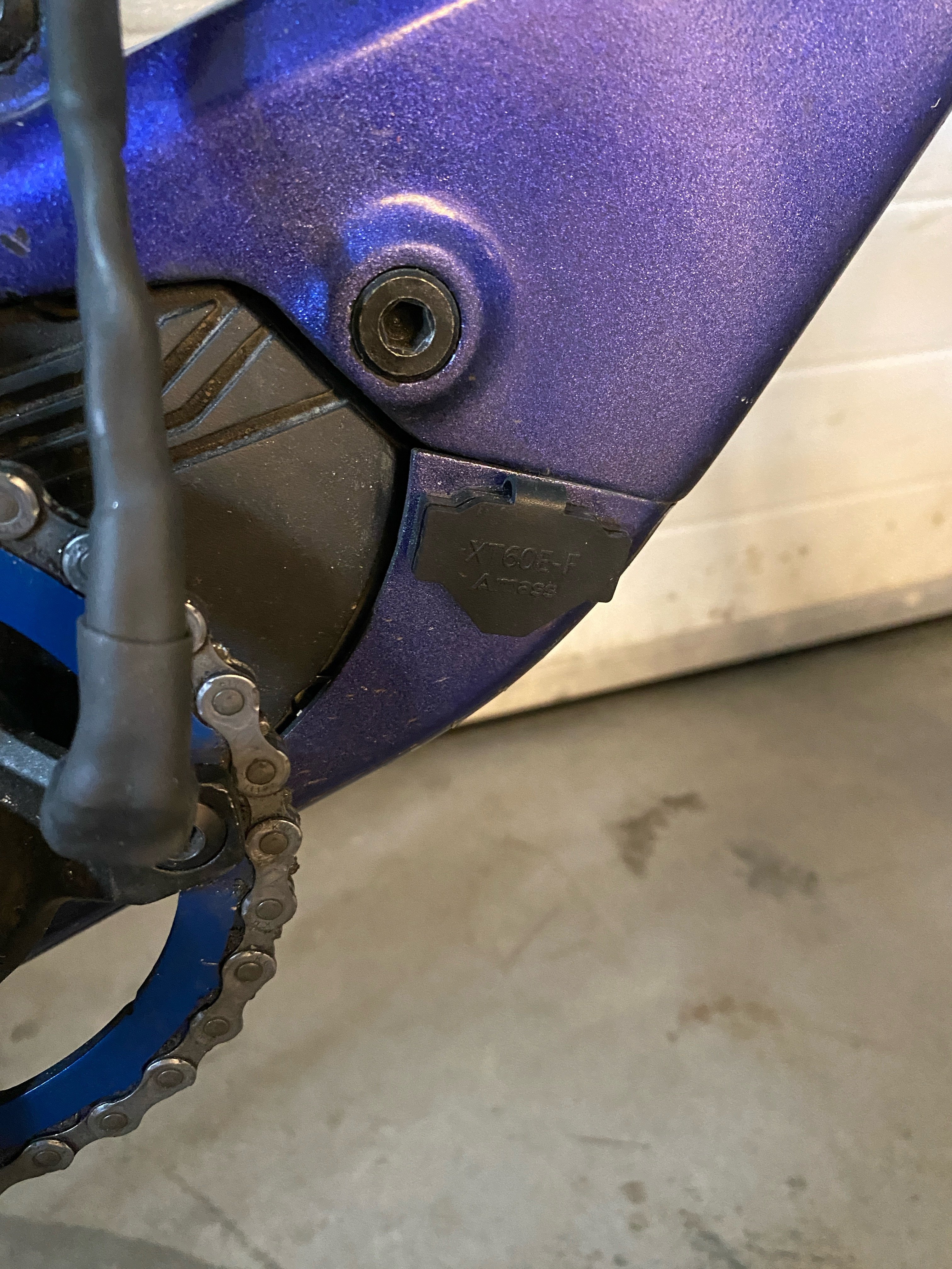

Personally, I find the right-angled outlet near my foot quite dangerous. I would be afraid of snagging my foot on it, hence my search for alternatives.
I don't want to remove the entire bar either, just clear a path for two cables.
Or maybe one could go back to @Myalteregohamish 's approach.
He has routed a cable directly into the bottom of the engine panelling.
Here I have the alternative idea of routing the cable out of the UPPER mounting and stowing it nicely on the bottle cage until you use the range extender.
The choice of connector would be free and could also be IP65 compliant.
