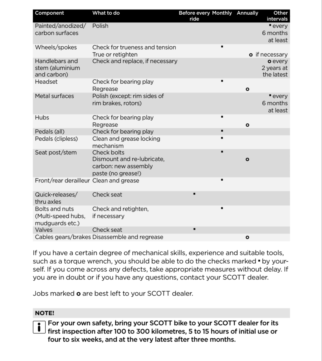

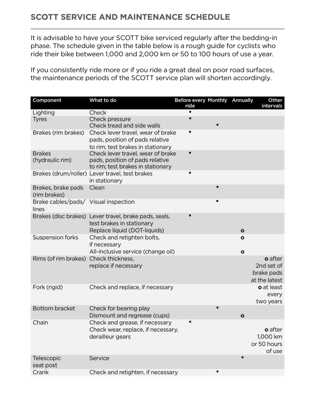

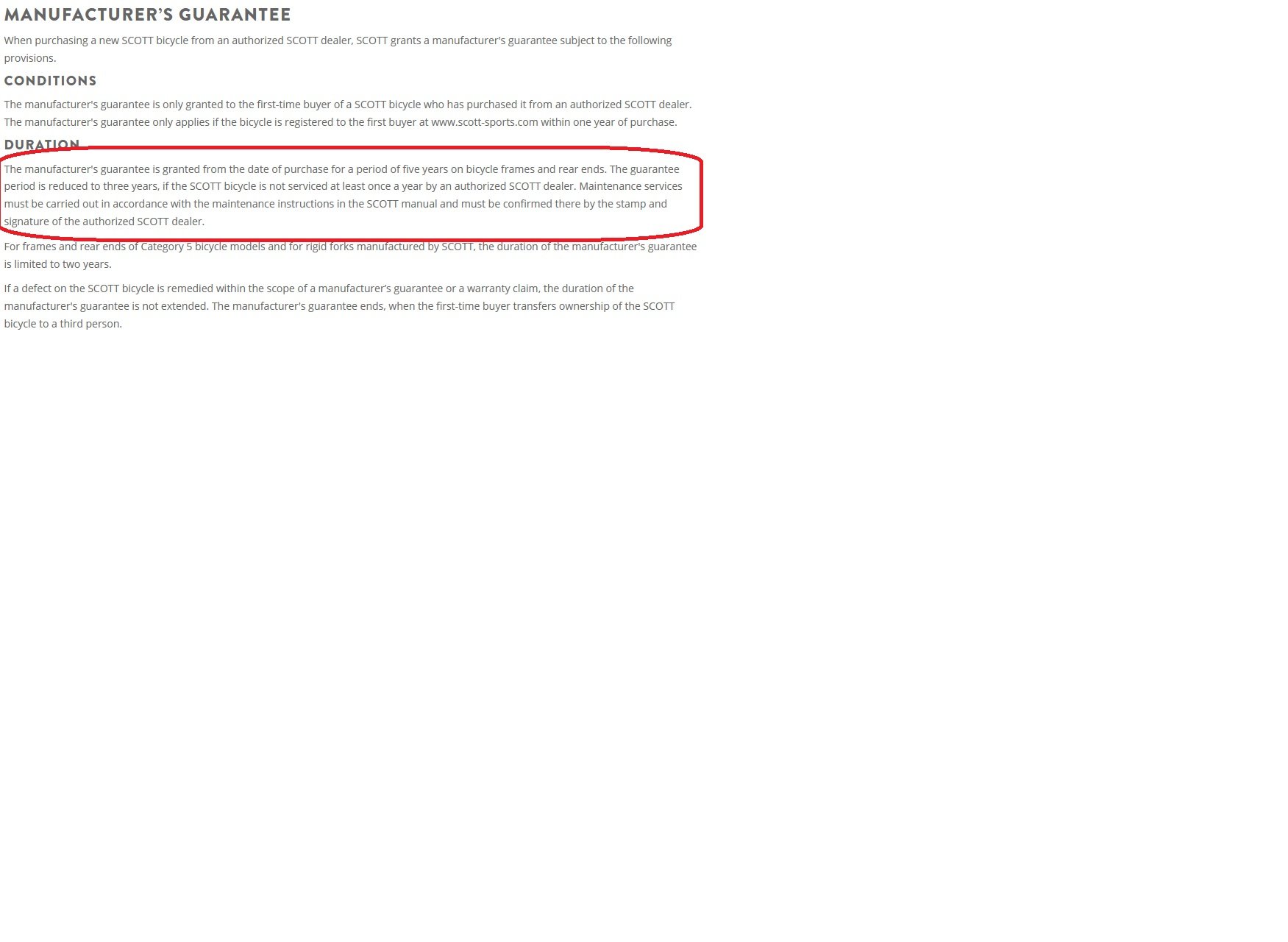

So what are "the maintenance instructions in the SCOTT manual"? That's what is important here. The point being that if there isn't a periodic inspection of the carbon frame then the service requirement is moot and would be a good argument in court.
From his manual:
Screenshot_20250507-071912~2.png Screenshot_20250507-072407~2.png Screenshot_20250507-072412~2.png
So, he's getting a £1000 best case bill
£700 for the frame*, £300 for the work to swap everything over and service
*Guestimate from the shop, that price is if Scott is being nice
