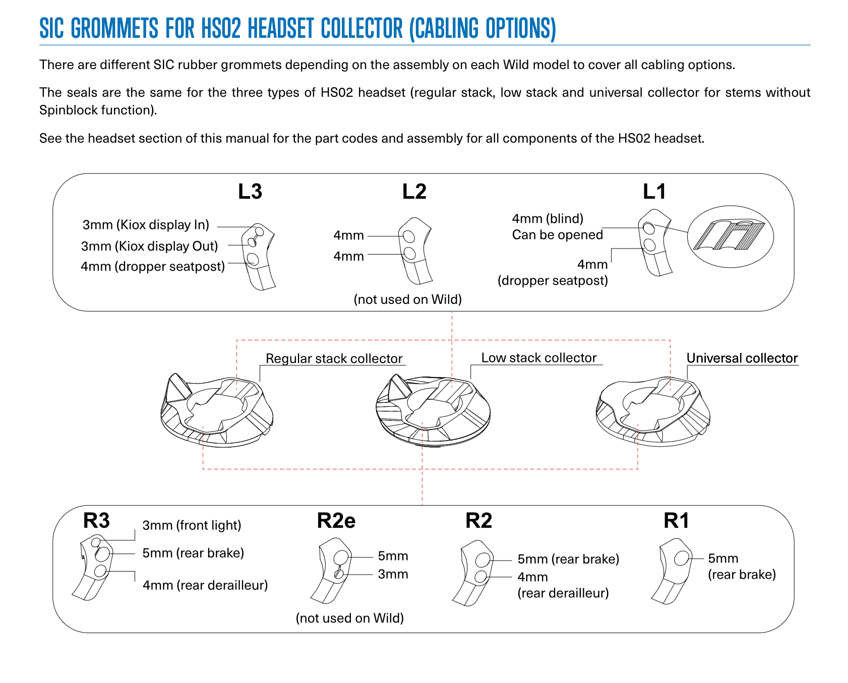

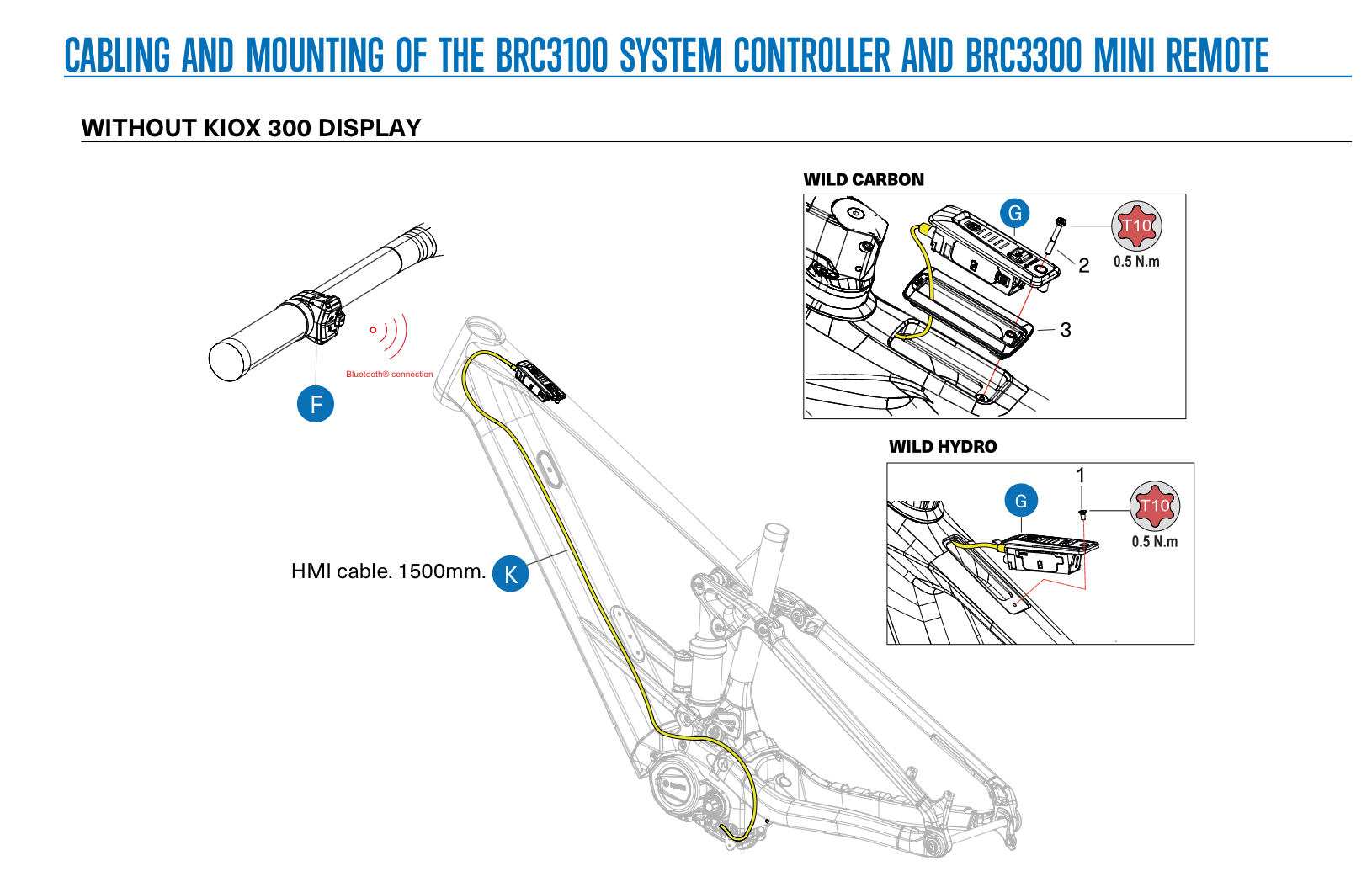

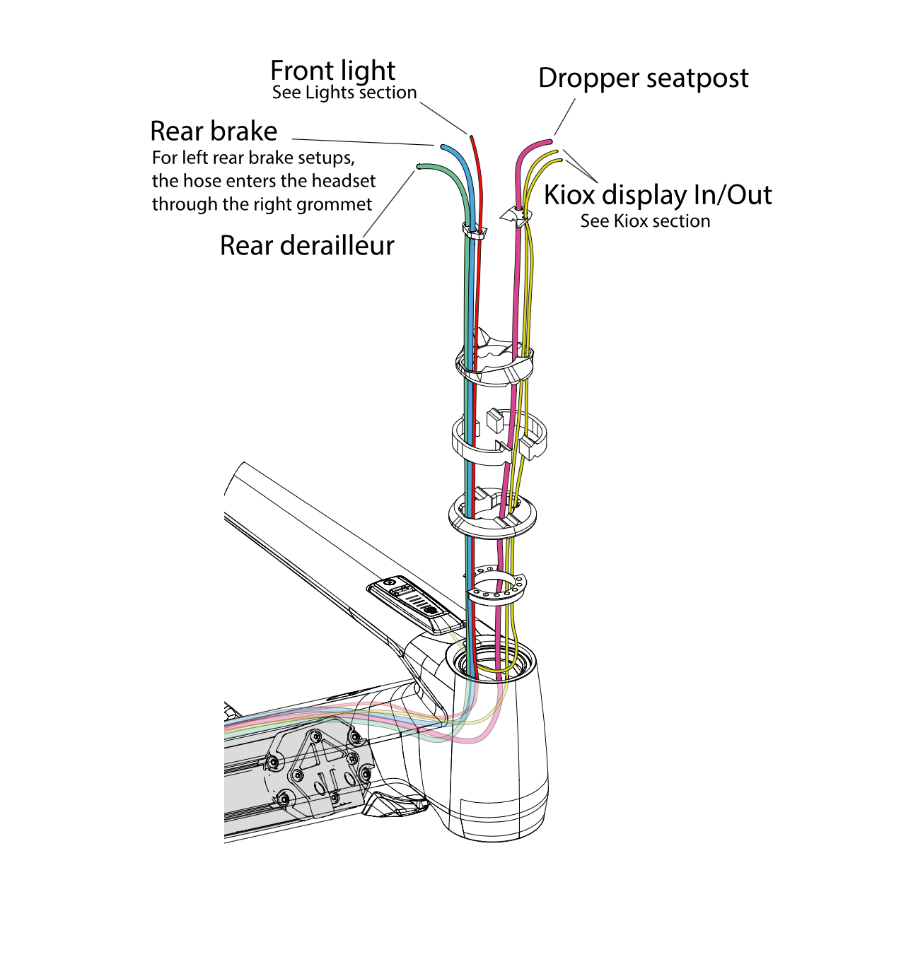

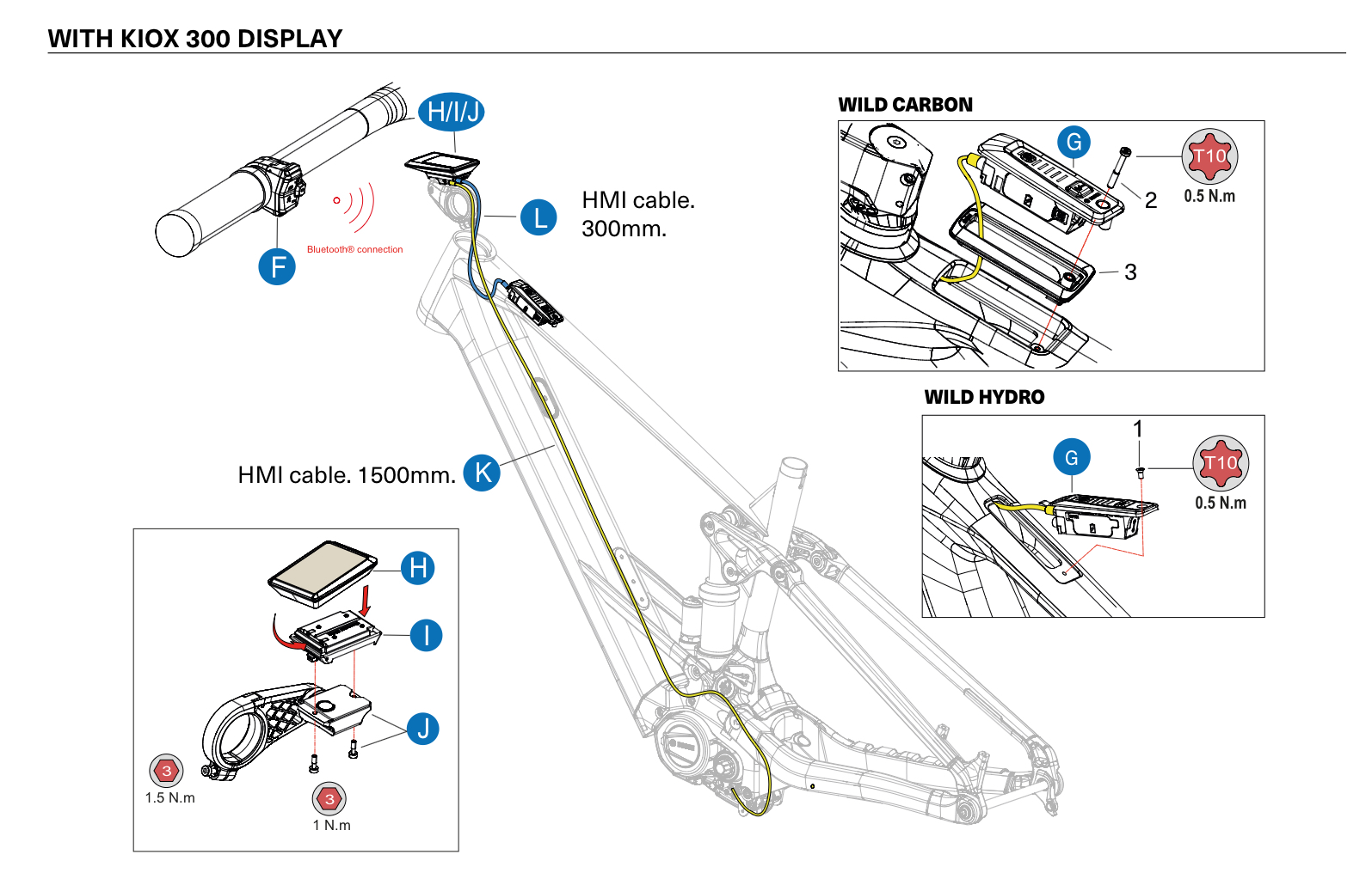

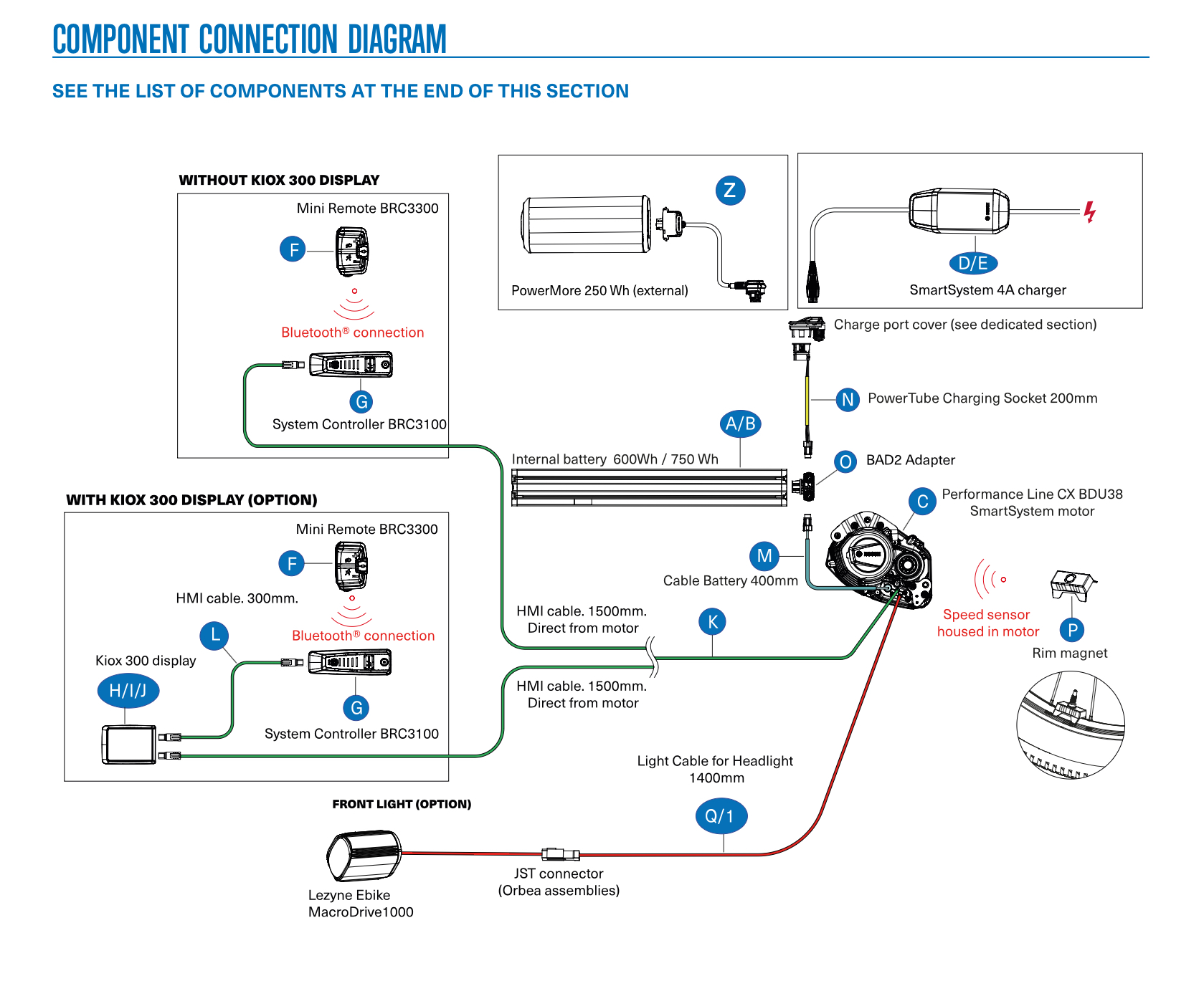

According to the newest Orbea Wild blue paper this is not correct.
As mentioned by @MrPeaski the main motor cable is routed from the motor to the system controller. Orbea uses for the Wild with or without the Kiox 300 option identical 1,500 mm long cables. This will be long enough to reach the Kiox through the headset. An aftermarket Kiox 300 or 500 upgrade kit includes the additional 300 mm cable needed to connect the Kiox display to the system controller. You will have to route both cables through the headset. The one used by Orbea has enough space for additional cables.
See the relevant diagrams from the blue paper below. You can find the full version here: Dash
