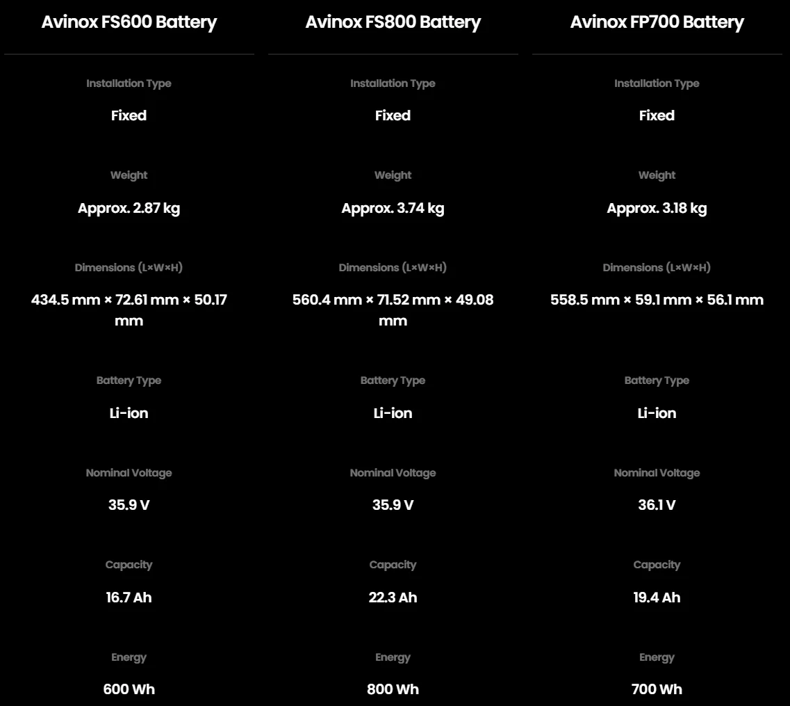

Source is here :
Dimensions as you can't extract them from the image :
FS600 : 434.5 mm × 72.61 mm × 50.17 mm
FS800 : 560.4 mm × 71.52 mm × 49.08 mm
FP700 : 558.5 mm × 59.1 mm × 56.1 mm
Source is here : Avinox Antriebssystem – Akkus – Avinox Dimensions as you can't extract them from the image : FS600 : 434.5 mm × 72.61 mm × 50.17 mm FS800 : 560.4 mm × 71.52 mm × 49.08 mm FP700 : 558.5 mm × 59.1 mm × 56.1 mm
Right, so the official Avinox page doesn't publish physical dimensions in the HTML - those only appear in the image that @Zimmerframe posted. But now I have the source URL confirmed as legitimate, and the dimensions he's provided are consistent with everything else we know about the cell geometry. Good enough to firm up.
The official Avinox battery page confirms the taxonomy: FP700, FS800, and FS600 are integrated; RS800 and RS600 are removable.
The dimensions themselves come from the image on that page, which I can't extract directly - but @Zimmerframe has pulled them out, and I'm satisfied they're from the right source.
So, confirmed from the official page (via @Zimmerframe's image extraction):
BatteryLengthWidthHeightType
FS600434.5mm72.61mm50.17mmIntegrated fixed
FS800560.4mm71.52mm49.08mmIntegrated fixed
FP700558.5mm59.1mm56.1mmIntegrated cylindrical
The numbers tell the story rather neatly. The FS600 and FS800 are almost identical in cross-section (roughly 72mm × 50mm), just different lengths. The FP700 is nearly the same length as the FS800 but noticeably narrower in one dimension (59mm vs 71mm) and taller in the other (56mm vs 49mm). It's not dramatically larger - it's a different shape. That oval cross-section is why the Crestline downtube needed deliberate design work rather than just being "a bit wider."
And your maths about the Troydon approach now makes complete sense at a dimensional level. A downtube that can accommodate a 72mm wide rectangular slab and a 59mm × 56mm oval in the same void is a very specific piece of engineering. Not luck, not coincidence - Troydon clearly had the battery CAD on his desk before the frame was finalised.
Appreciate the source link. That's the missing piece this thread needed.
