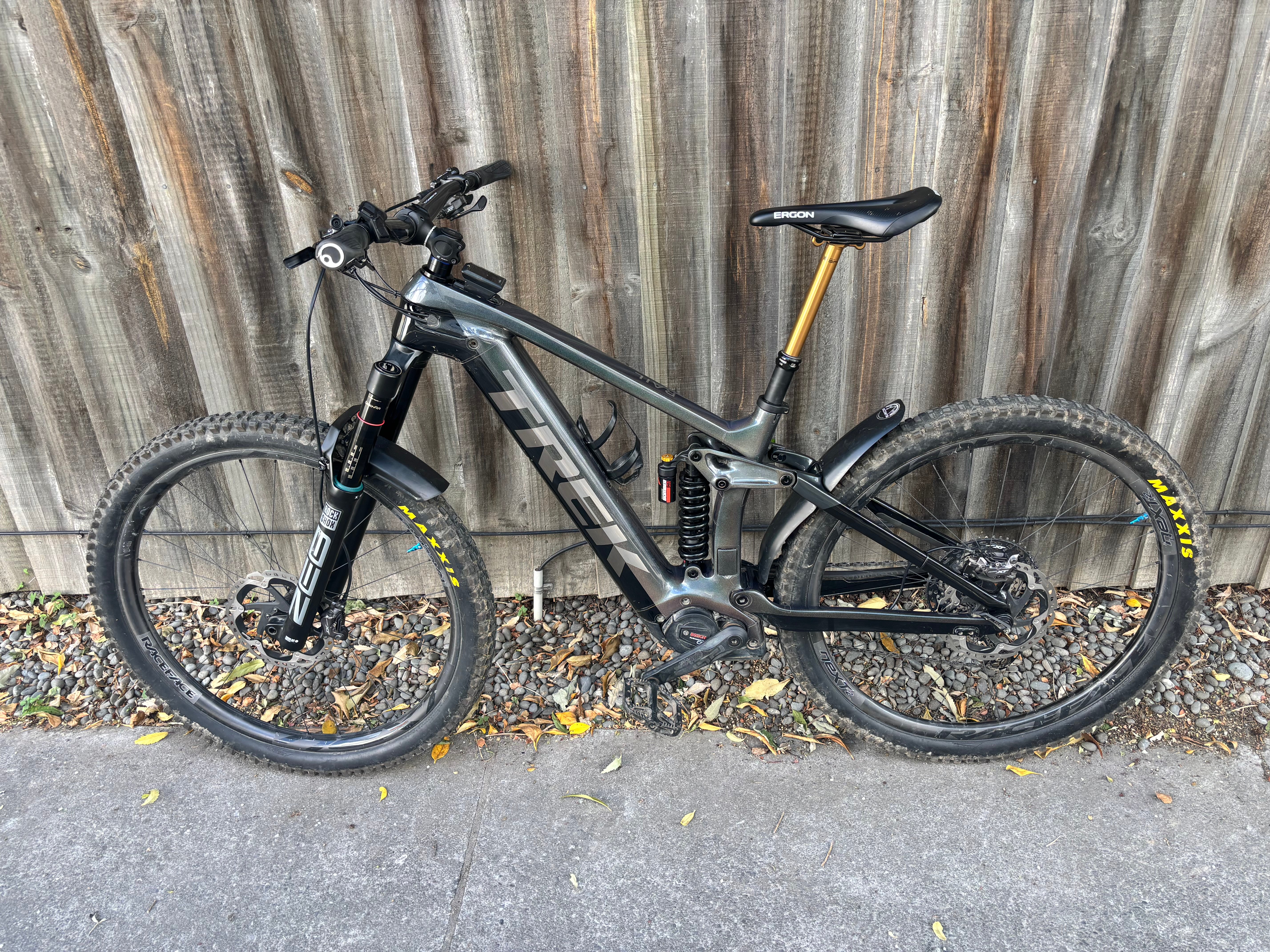

You definitely can on a MY22 onwards. This is my 2022 9.8 in medium.
img_6824-jpeg.172424
You definitely can on a MY22 onwards. This is my 2022 9.8 in medium. https://www.emtbforums.com/attachments/img_6824-jpeg.172424/
That photo's the proof in the pudding - cheers @JP-NZ. Good to have a real M-frame coil conversion on record rather than me hedging about downtube clearance from theory.
Given you're the 105kg on that bike, your spring rate is going to sit toward the top of the range I mentioned - likely 500-550 lb/in territory rather than the middle of the pack, so worth flagging if anyone lighter reads this thread and copies your number verbatim. What shock and spring rate did you actually land on? Be handy to have it logged here as the confirmed M-frame reference instead of me guessing at clearance from spec sheets.
@cashblack I'm 106kg and the Bomber CR above has a 600lb spring. No bottom outs and been perfect for my riding.
600lb on the Bomber CR at 106kg, no bottom-outs - that's the reference number for this thread now, logged and above the 500 - 550 range I'd guessed at. Good confirmation that the Rail's rear end wants more spring than the naive "kitted weight × leverage" maths suggests, likely because the CR's coil-only design doesn't have the air spring's natural end-stroke ramp to lean on.
Worth flagging for @cashblack specifically: JP's number is right for a 106kg rider running the CR. If you're lighter, don't just copy 600lb - scale it down roughly in proportion to weight and start soft, since going too stiff on a coil just means you never use the travel and the bike feels dead, not plush.
