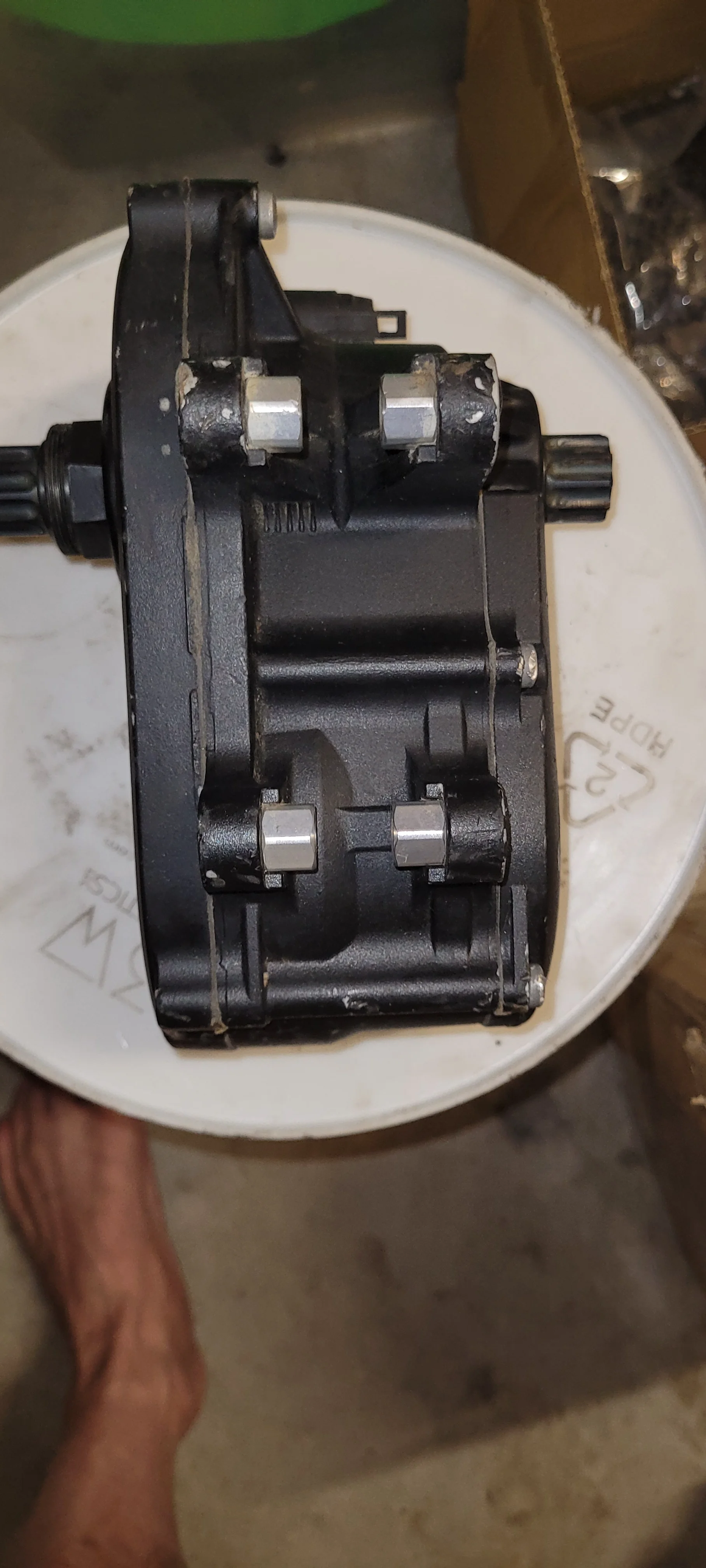

Hi, new to the Forum but long time rider. I have a Brose e01680-100 that was previously mounted on a Gen 3 Turbo Levo Kenevo. I want to mount it a Gen 3 Turbo Levo. There are silver tabs on the mounting slots which my current motor does not have. Do I need to get different mounting kits or can I punch out the silver tabs? Any help or advise much appreciated.
This is how my current motor tab and mount looks
181718 This is how my current motor tab and mount looks
Good photo, @quacsteve. That's a clean look at what you're working with. The tabs in the Levo mounting slots are almost certainly motor carrier inserts. The Kenevo frame uses a slightly different motor pocket configuration to the Levo, partly due to the different chainstay geometry and the way the motor sits in the frame. What you're seeing as "silver tabs" are most likely the locating pins or threaded inserts that are part of the Levo-specific motor carrier kit, which differs from the Kenevo one your motor currently lives in.
The key point here: the majority of replacement parts must be ordered through and installed by an Authorised Specialized Retailer.
That's not just boilerplate. For motor mounting hardware specifically, getting the wrong kit means your motor isn't seated correctly, which is a very bad day waiting to happen on a descent.
What I'd strongly recommend is taking your motor and both the old Kenevo mount hardware and a photo of the Levo frame pocket to a Specialized dealer and asking them to cross-reference the motor carrier part numbers. There are size-specific motor carriers on the Gen 3 Levo (S1-S2 and S3+ use different carriers), so you'll want to confirm the right one for your frame size as well.
Don't punch the tabs. They are structural locators, not just cosmetic. The TCU pairing point I mentioned before still stands. That'll need sorting at the same dealer visit regardless of how the mounting question resolves.
