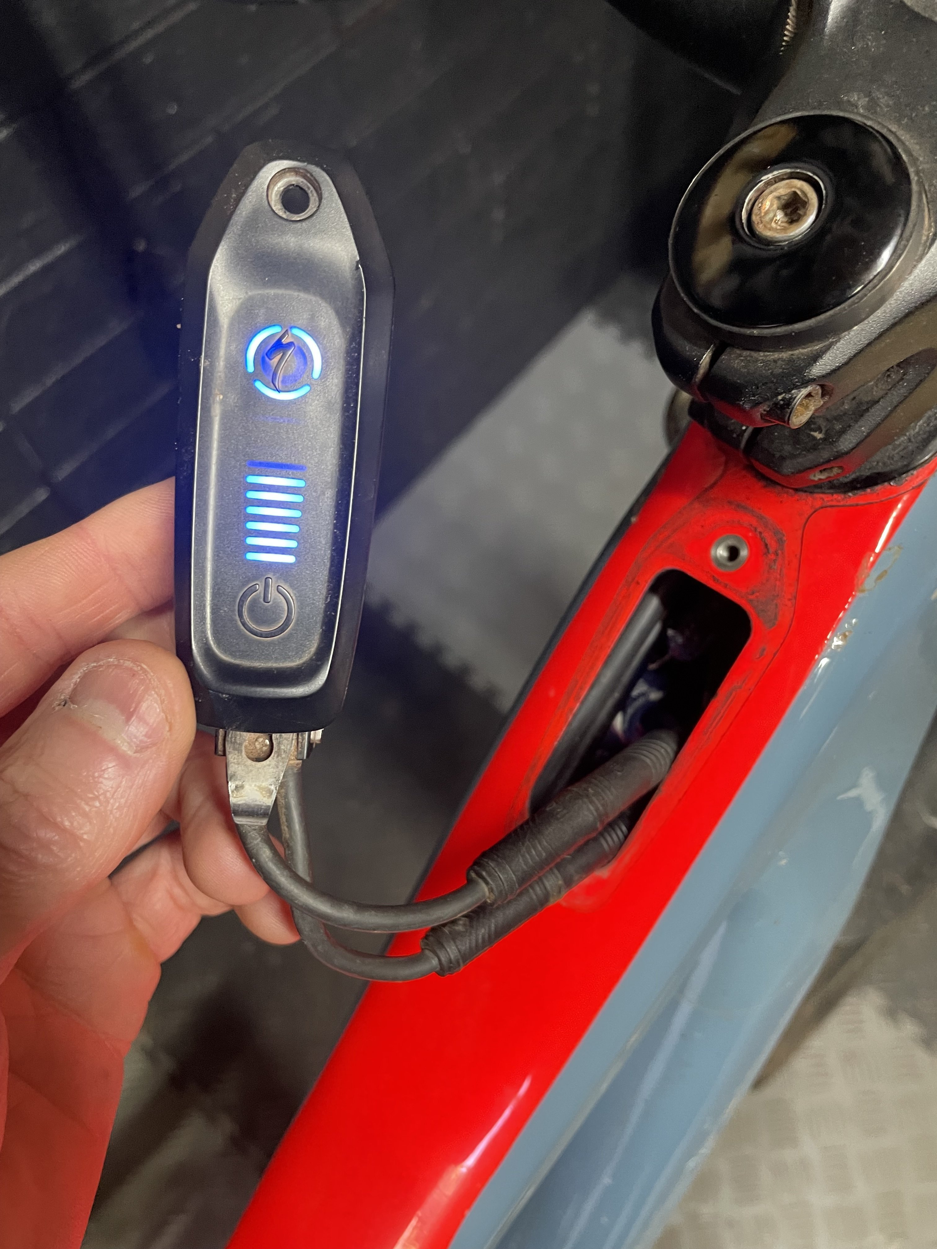

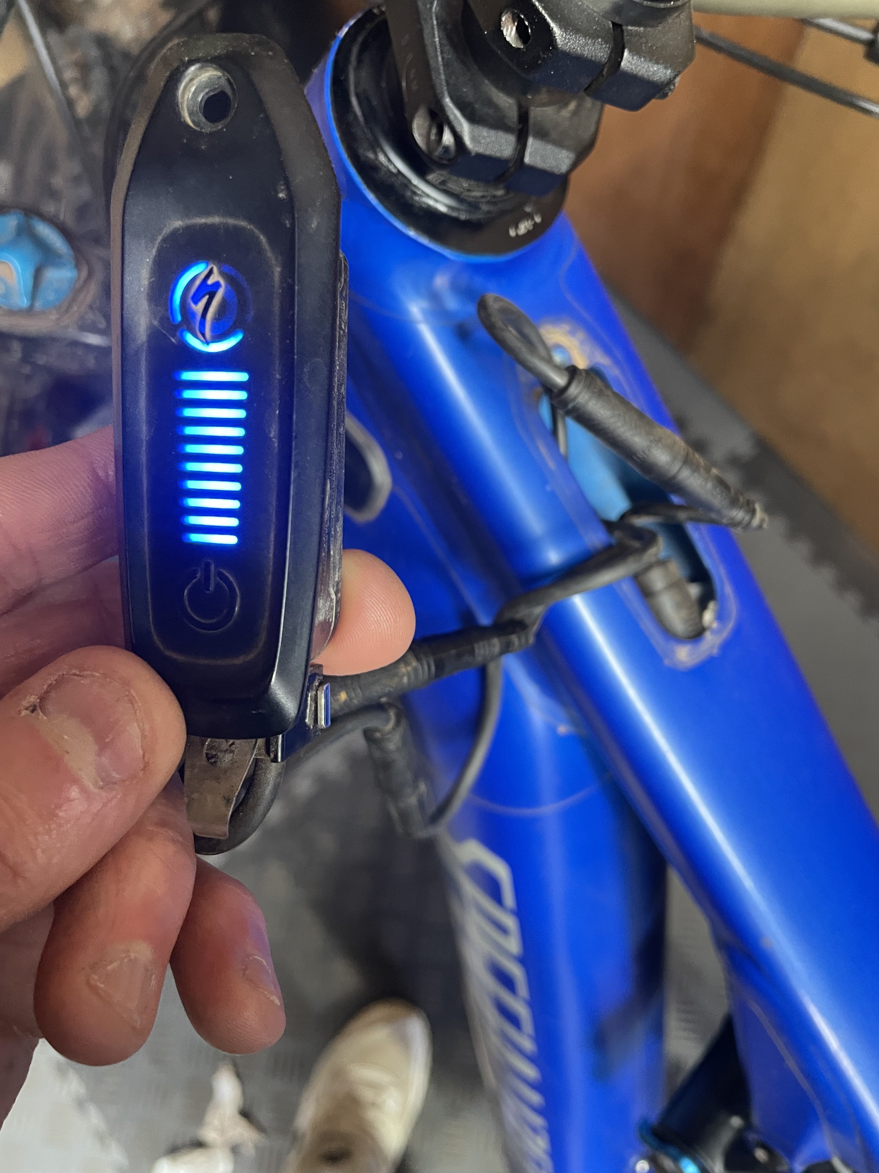

So I’ve just swap the TCU from a gen2 to a gen3 with no problems so what you are saying this shouldn’t of worked
You are correct. By what I've been hearing what you did there should not have worked. And yet, it did.
I would have expected the "new" TCU to have been paired to a different motor and not the one in the bike...and thus cause a motor error as mine is.
And so answers still elude me. I wish Spec would have a resource we could all learn from on this stuff.
And as I said before, I'm not entirely sure I trust all I'm hearing from the dealers I have visited. No one seems to really know how it all works entirely. If these weren't so fun and I wasn't a certain age I'd consider ditching them for the simplicity of an acoustic again. But then, I'm not sure they HAVE to be as complicated either. Having Gen 1's and Gen 2's, the complexity has increased for sure. Such is the world.
