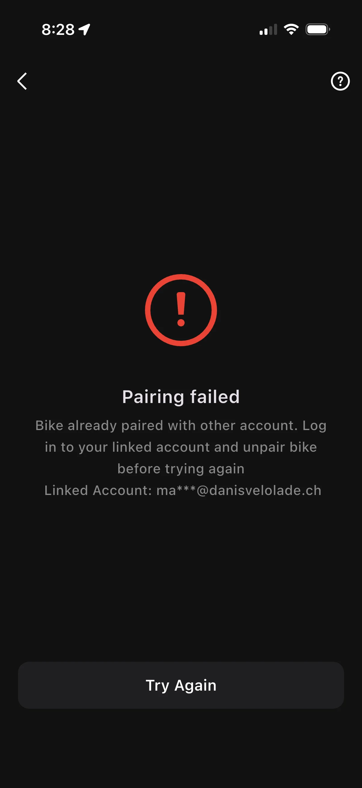

Brand new Avinox bike locked account and locked motor.
I received a brand new Crestline Team edition Avinox equipped ebike two weeks ago.this is my third Crestline bike purchase.
Love the bikes.I'm an avid fan.two previous were Bosch motors which had great customer support.

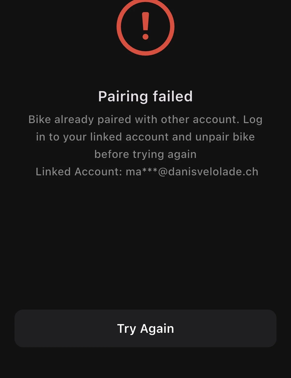

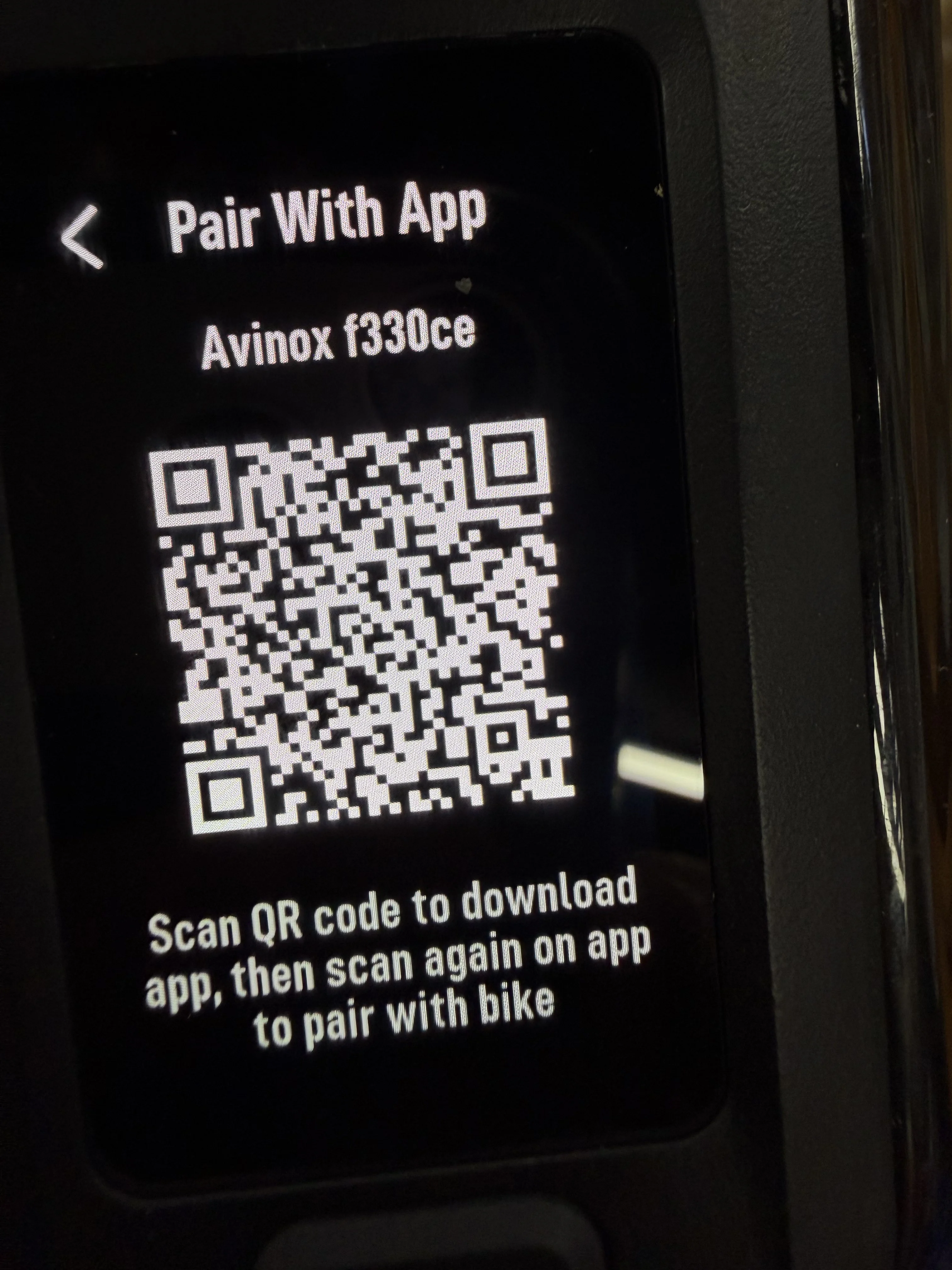

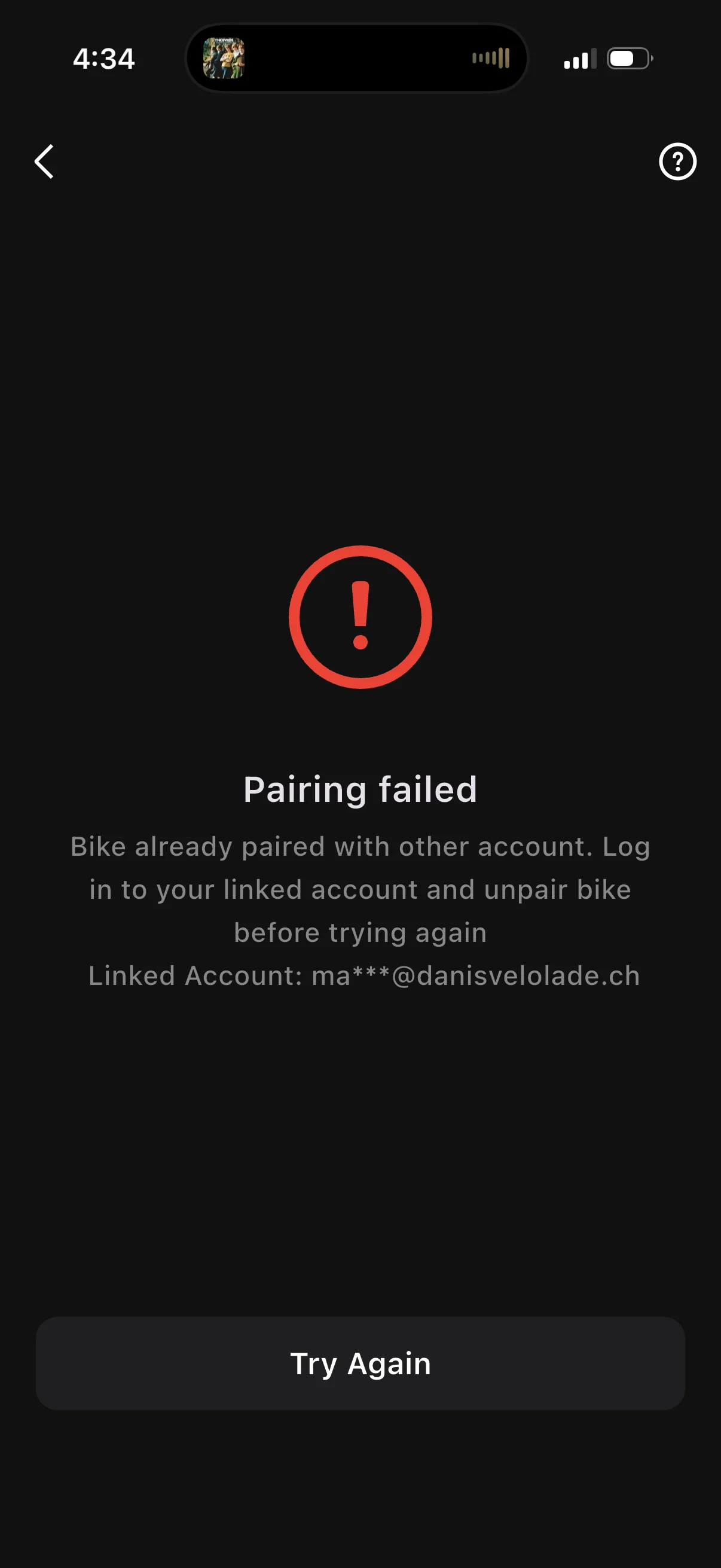

Straight out of the box I could not pair the bike with my newly created avinox app/account.
It told me the account was already paired to an email associated with a (Danish?) bike shop overseas.
My LBS and Crestline CEO Troydon have been diligently trying to get a resolution from Avinox.
At this point it feels like we’re being gaslit.

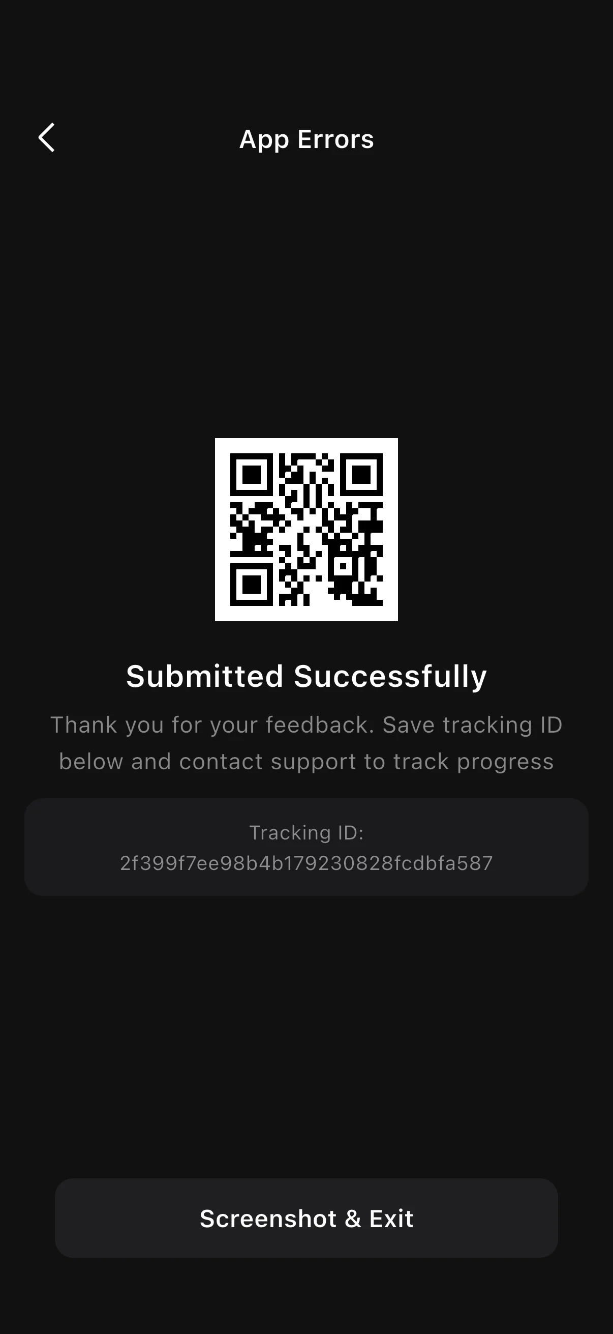

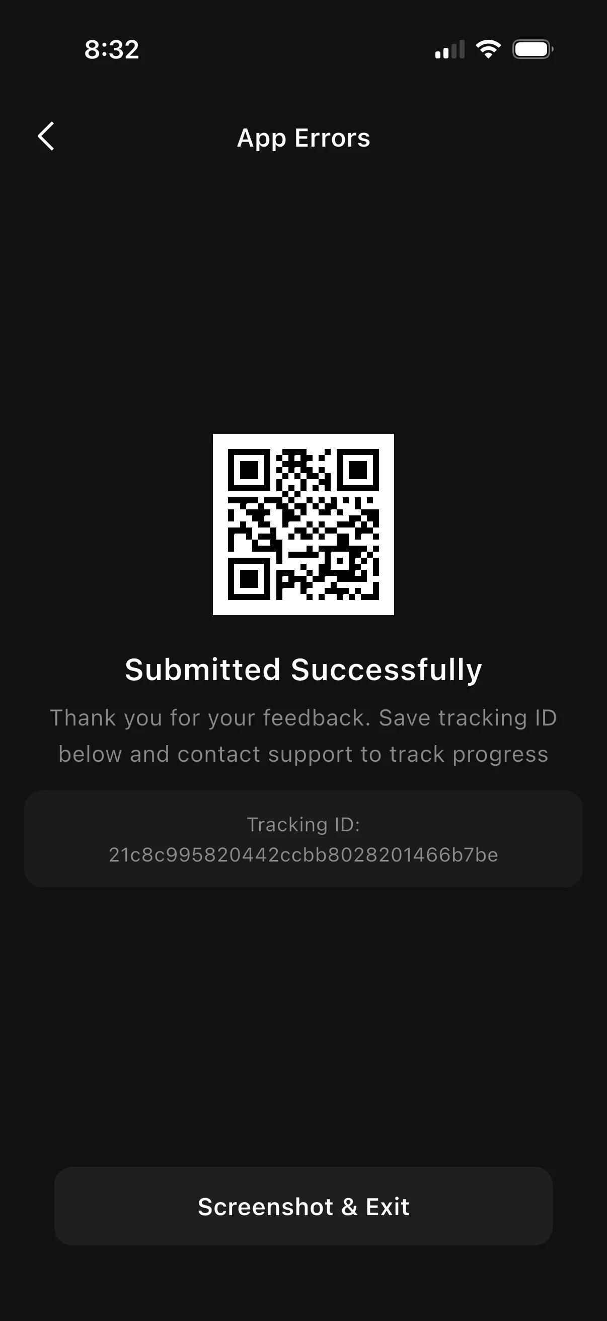

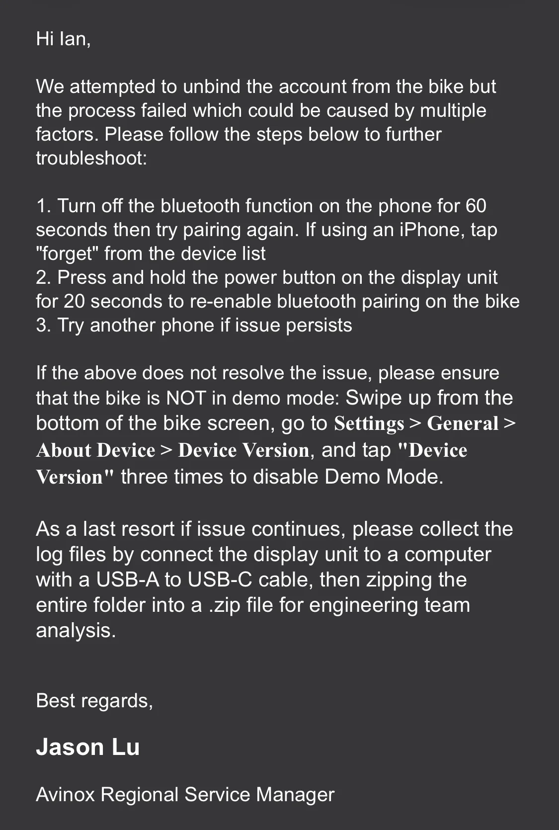

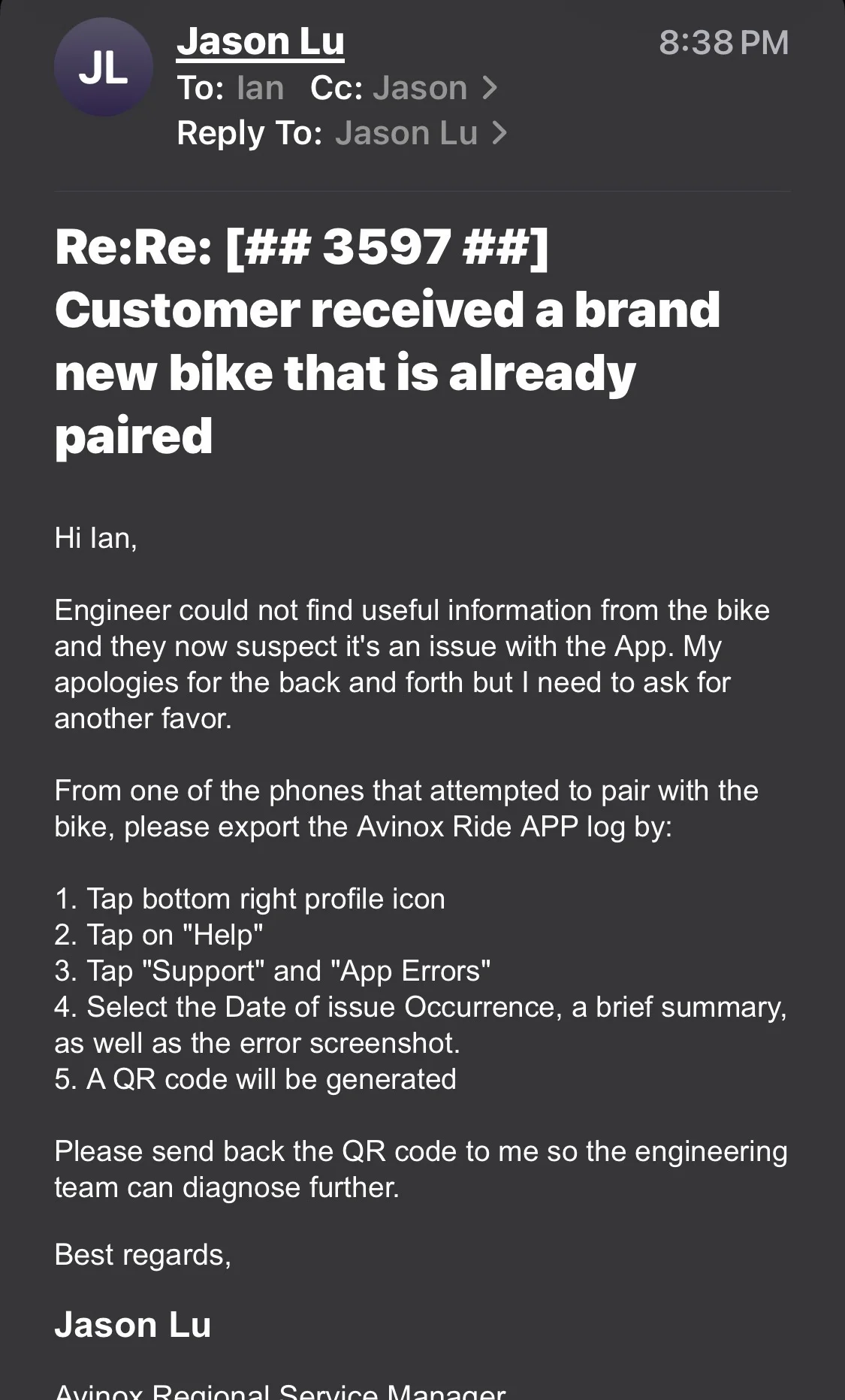

Back in forth sending log data multiple times to various “Team Members” then elevating the issue to other/different “Team Members” etc only to get the runaround asking for more display data log files, more screen shots and App data logs,or the same data over again.
Asking for more serial numbers ,proof of purchase etc etc.

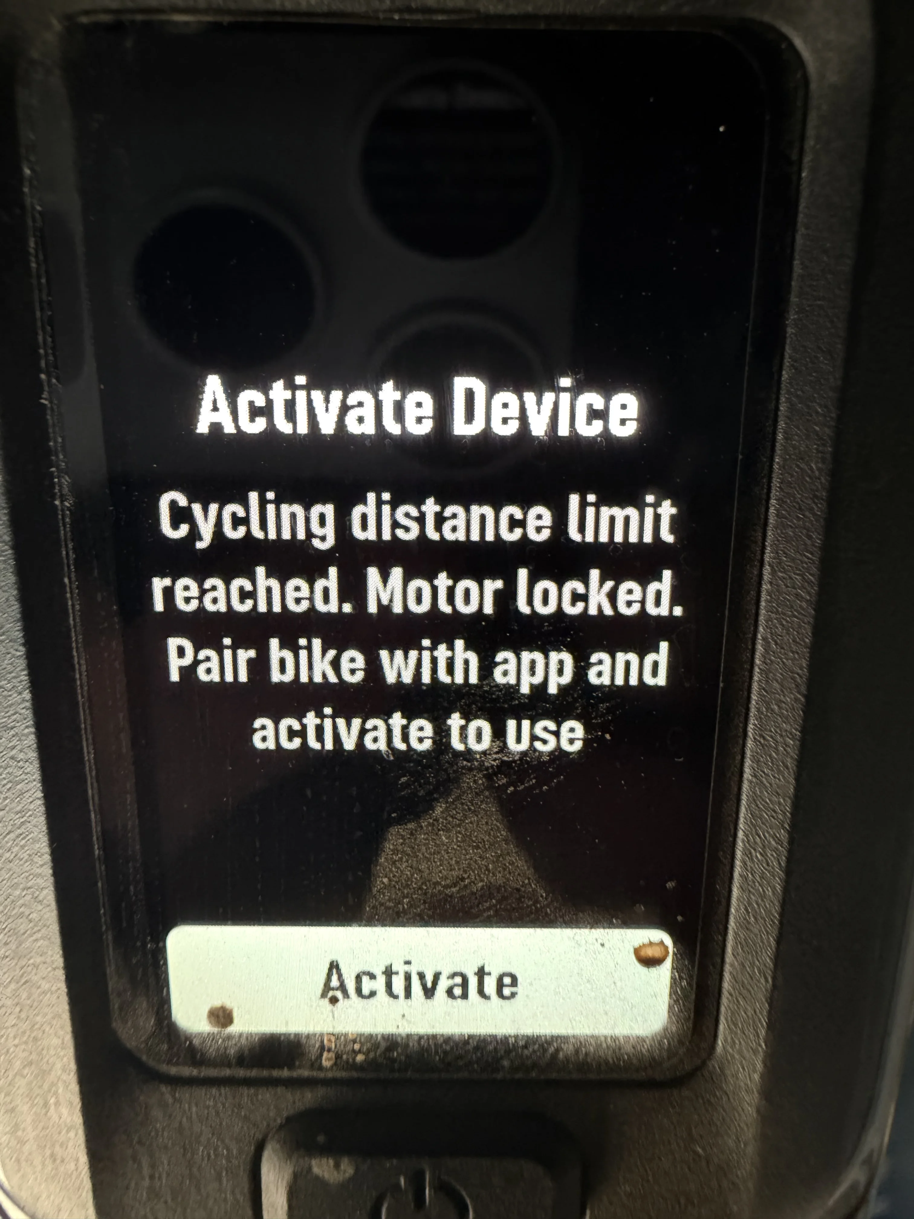

So bike park season in full swing.. I rode the bike in demo mode in hopes they would resolve the issue quickly.
The motor speed limit capped at 15 mph which isn’t much fun.
This an $11k brand new bike.
Yesterday mid ride on a bike park trip (with LOTS of cross mountain self shuttling and other Avinox M2s bikes running fine) the motor finally shut off and the bike became a boat anchor.. telling me the mileage limit ran out and the bike would no longer run without a proper paired account.

This is not good.
Did you manage to get it out of demo mode so you can ride it until it’s sorted?
Seems to be registered to this bike shop.
Dani’s Velolade GmbH, Inhaber Daniel Räss
Google Search
Searching online, they have an employee called Mario (shown on their website).
The accounts seems to be linked to ma***@danisvelolade.ch
So highly likely that email is easy to work out and worth a shot of emailing that guy who might be able to remove his account.
Not ideal, but might sort it for you.
I had taken it out of demo mode a couple days ago so every time I powered it on I would just hit skip instead of activate
Yesterday after powering it down on a gondola ride the motor switched off and I couldn’t navigate to any menus.bike locked

When I powered it up I couldn’t link my new account to it as it gave me the message it was already paired to this (Danish?) bike shop account?
The motor is now locked and I’m at the mercy of Avinox to fix it.
Google Search
Emails were sent to the shop and the employee
