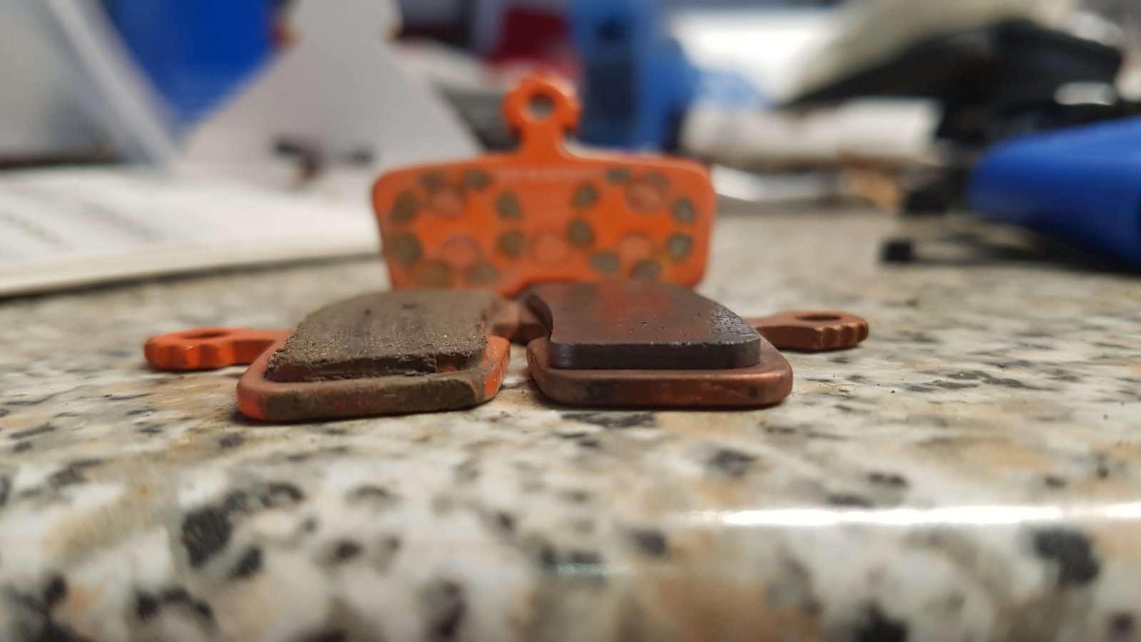

Alright thx man. I read a few comments about excellent stopping power but short life.
840 on the left, sram on the right. Maybe 50 miles on the sram, 300 odd hard miles on the 840. Rear pads, I drag them a lot on the steeps ;)
