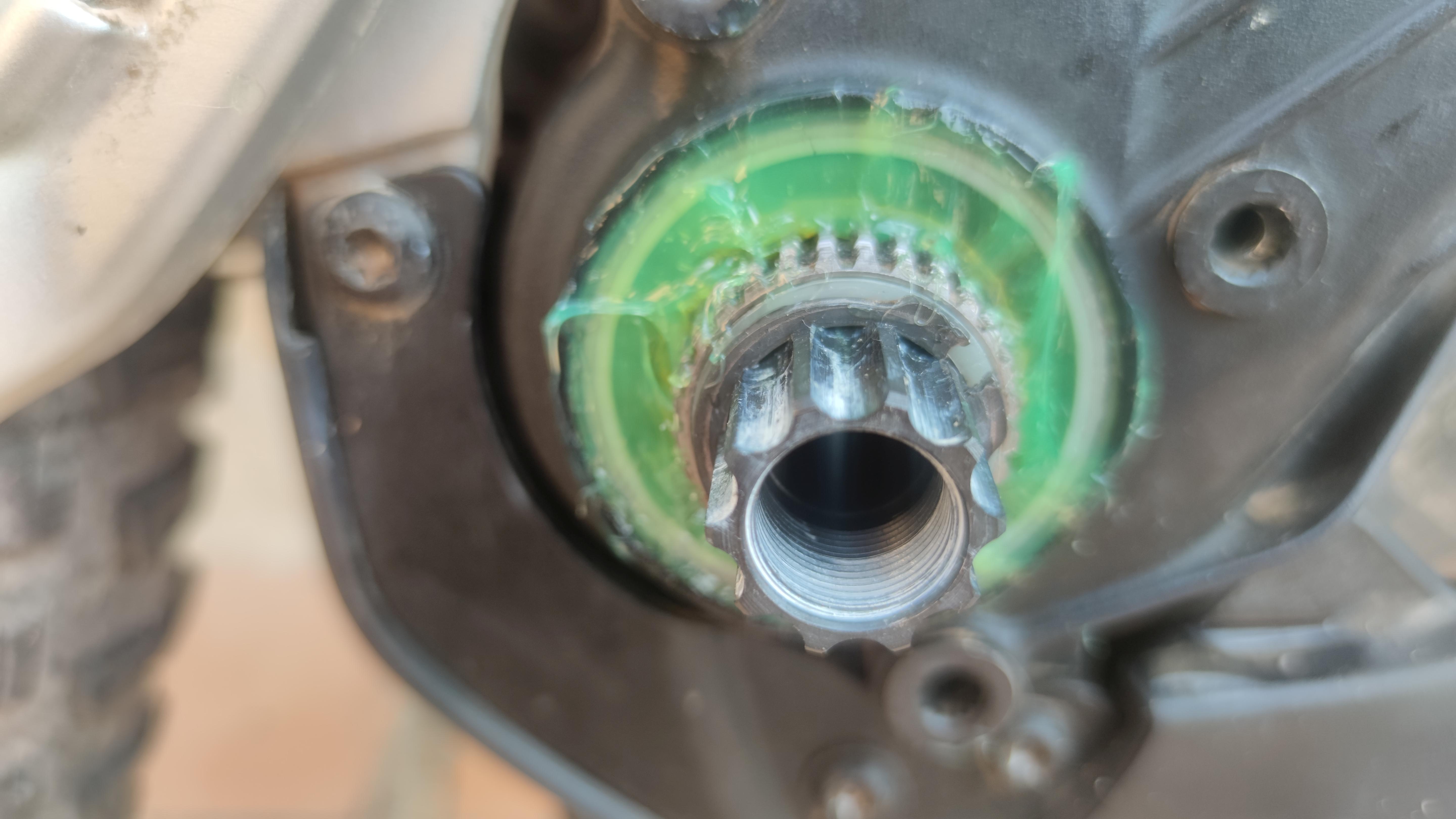

My ebike is a 2023 Moterra Neo 3 , 1 year and 9 months and 7100Km and I mainly ride in Mediterranean dry climate, but I also make trips to the wetter northern Spain and spend a week riding there.

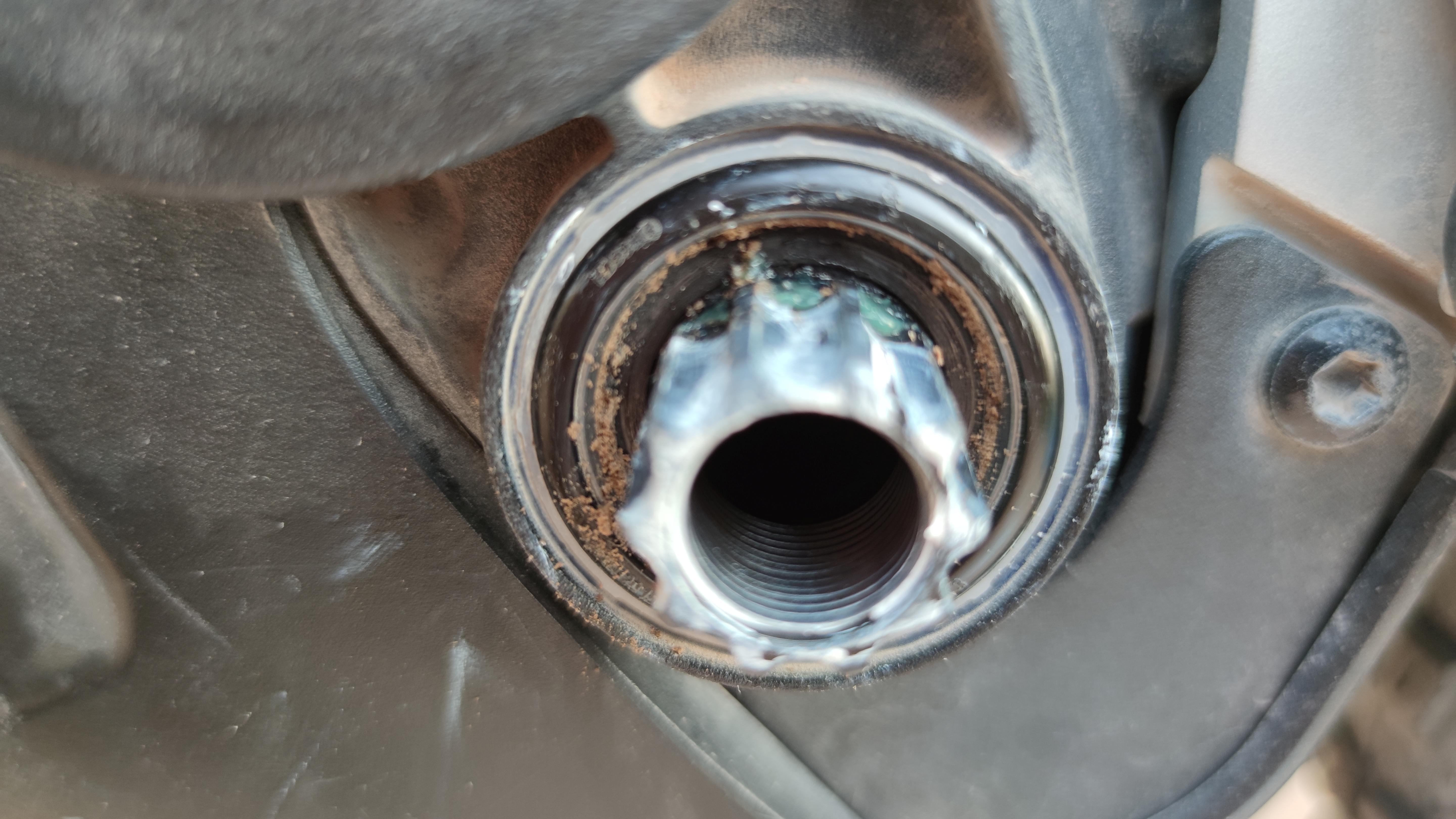

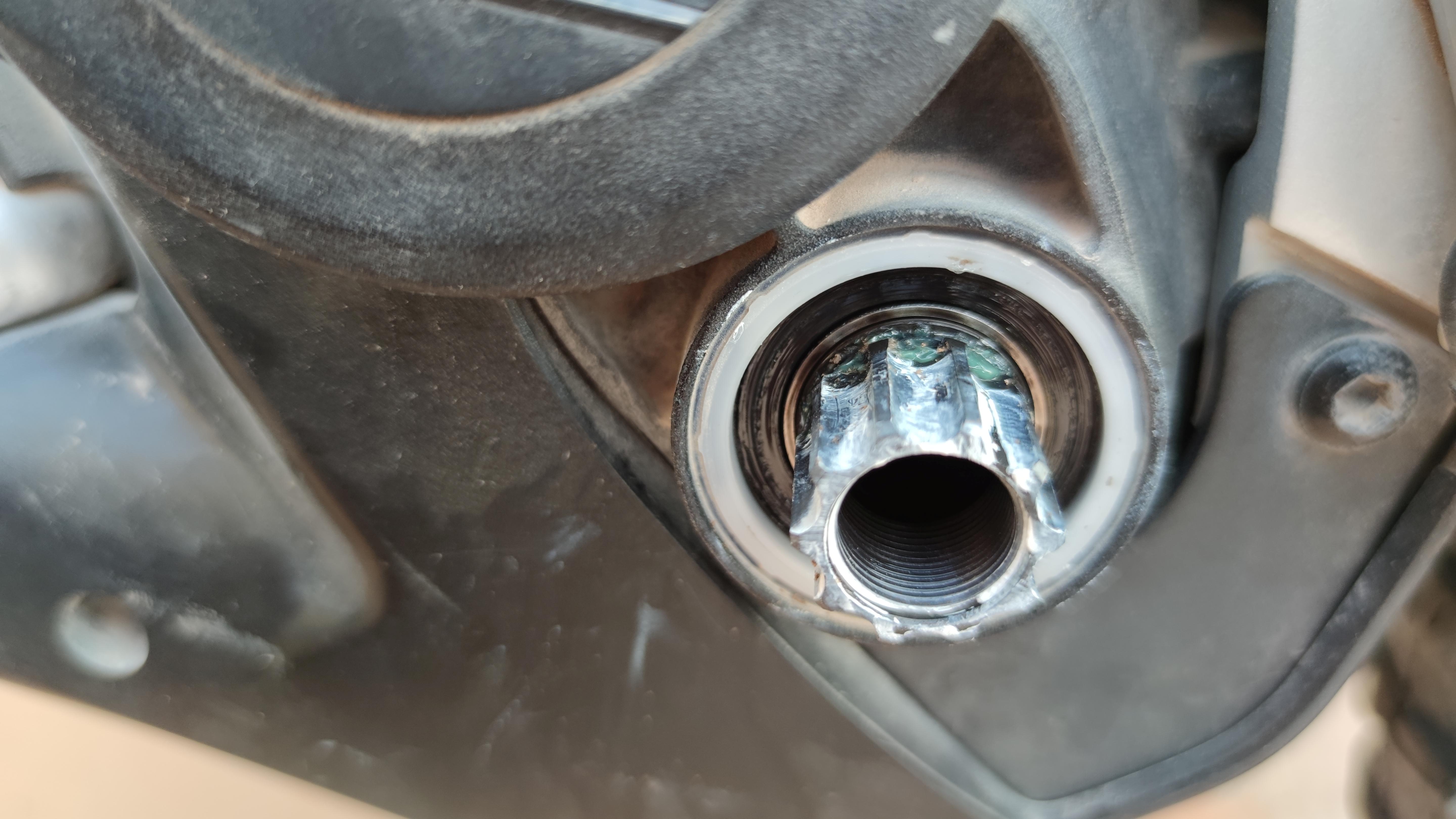

In preparation for another trip, I decided to re-grease the seals, and I found that the seals are in very good shape, with very little grit and there still is some of the original grease, and the crank bearings do not show any sign of rust.
After reading all the experiences here, the process went very well, I found that it was easy to remove the black rubber and metal seal, the only requirement is to insert the plectrum under the black rubber ring, and NOT under the yellow seal.
I also found that the crankarm caps and the chainring nut torque were far below the specs of around 40NM for the caps and 35Nm for the nut, so I am lucky that I did not have problems.

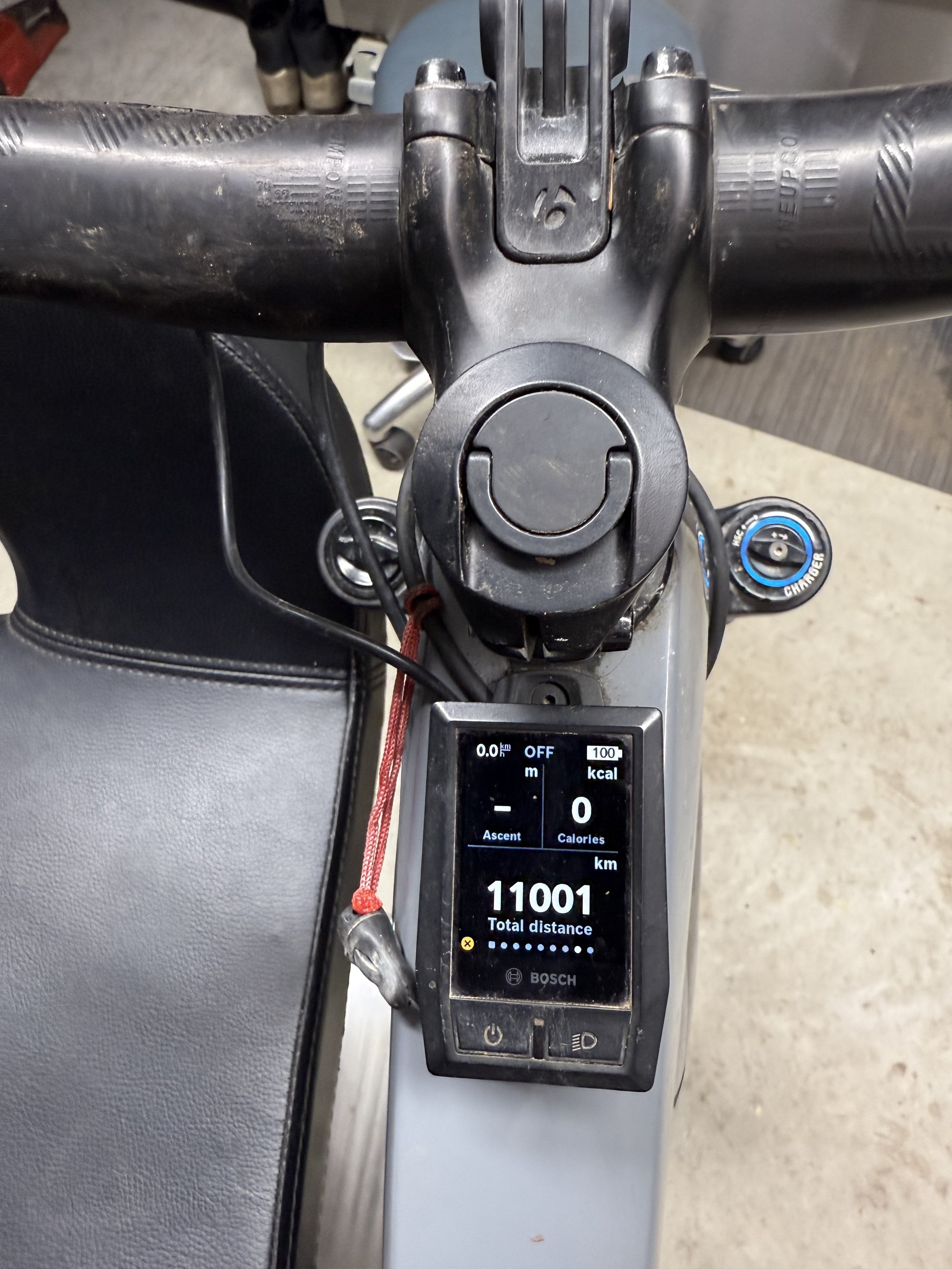

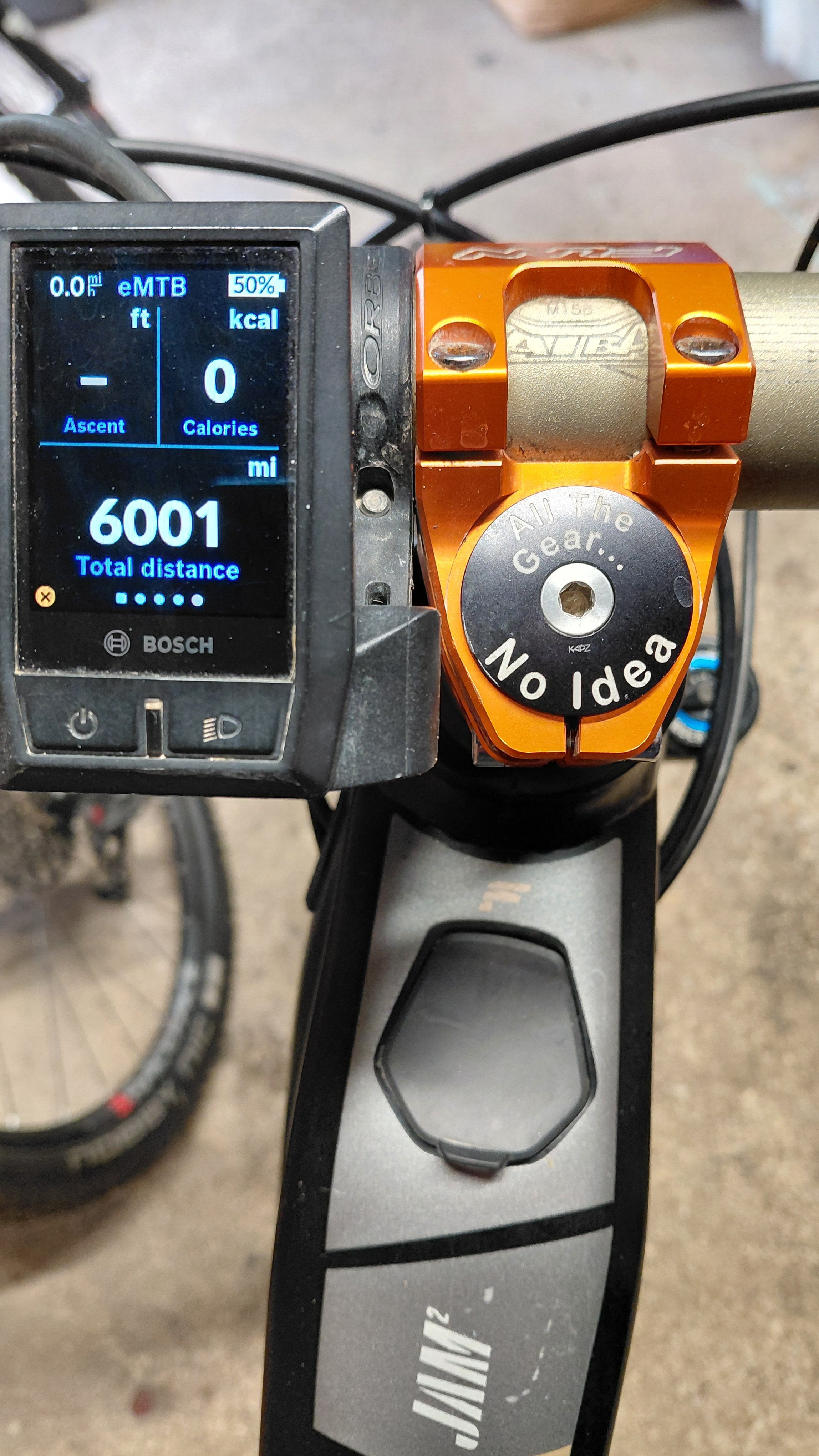

Apropos of this, I say not bad for four UK winters & counting.
When I saw this I was curious about my Kiox. So I checked it this morning before my ride.
I don’t usually set the page to distance travelled, but these numbers made me laugh. 😆 it’s almost identical to yours (except the miles/km thing).
I mounted the Kiox to the top tube on the Rail with another type of mount which helped cleanup the cockpit. For almost 5 years it’s been through all types of weather. I’m surprised that the Kiox and controller is still working after all these years. What are we doing right? 😉🤷🏼‍♂️

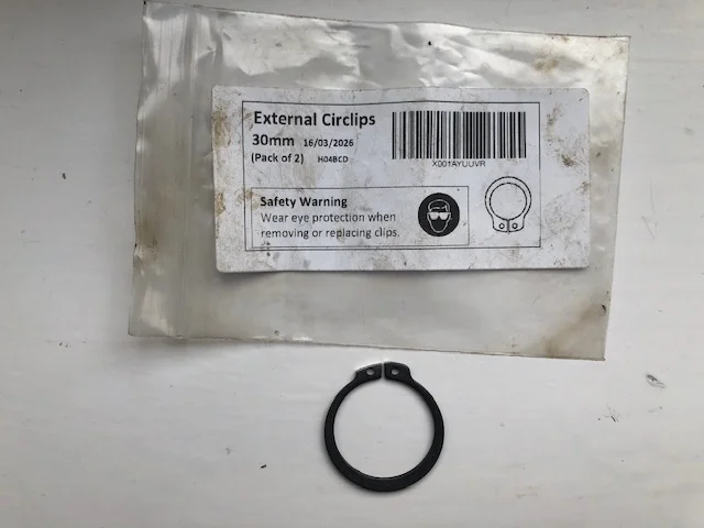

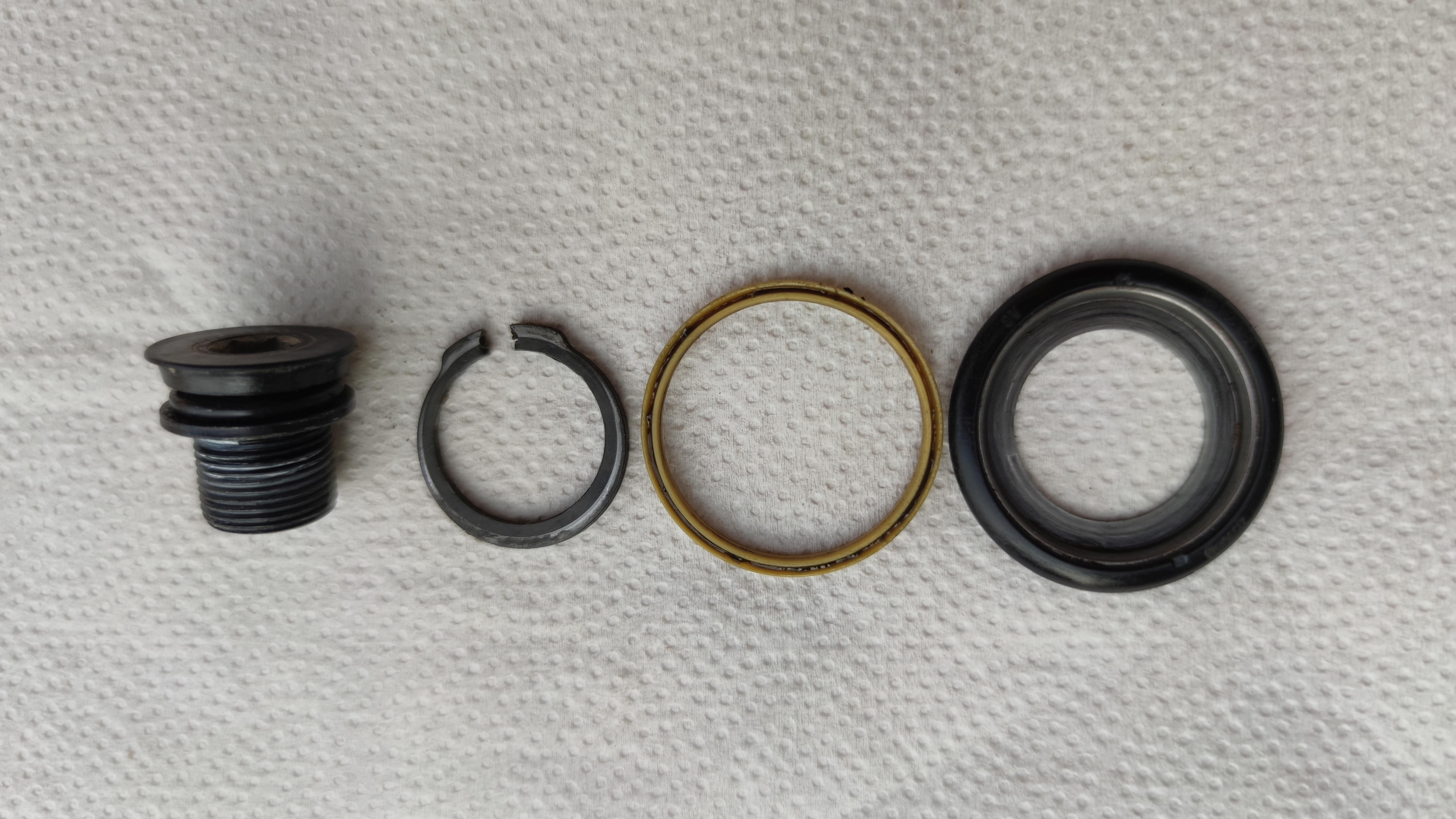

Hi Rusty, inspired by your seal grease vid a couple of years ago and re greased the seals on my Stilus back then.
Just completed a second regrease but this time replaced the large circlip on the chainwheel side with a circlip as in the pic complete with plier holes. Needed a small amount ground of, one side shown, but a perfect fit and only £3.90 for 2. The original O ring with flats was a bitch.
I am puzzling now about the orientation of the yellow O ring which sits inside the seal. Does it fit groove out or groove in??? I see you have it groove in but my logic tells me it should be groove out to sit up against the internal fixed O ring filled with grease. Any confirmation appreciated.
I've always done it groove inwards as that was how it came off the first time I did it & so I assumed that's how it was assembled at the factory. Maybe @Bearing Man knows better?
Is there any particular logic for this orientation? or any purpose for the design? All I can think of is it traps a bit of grease & dirt, at least in my experience the groove is always dirty when I remove the seal.
Basically, you've nailed it! The groove holds the grease to lube the seal and any grit that makes its way behind the seal gets trapped before making it into the bearing. (y)
