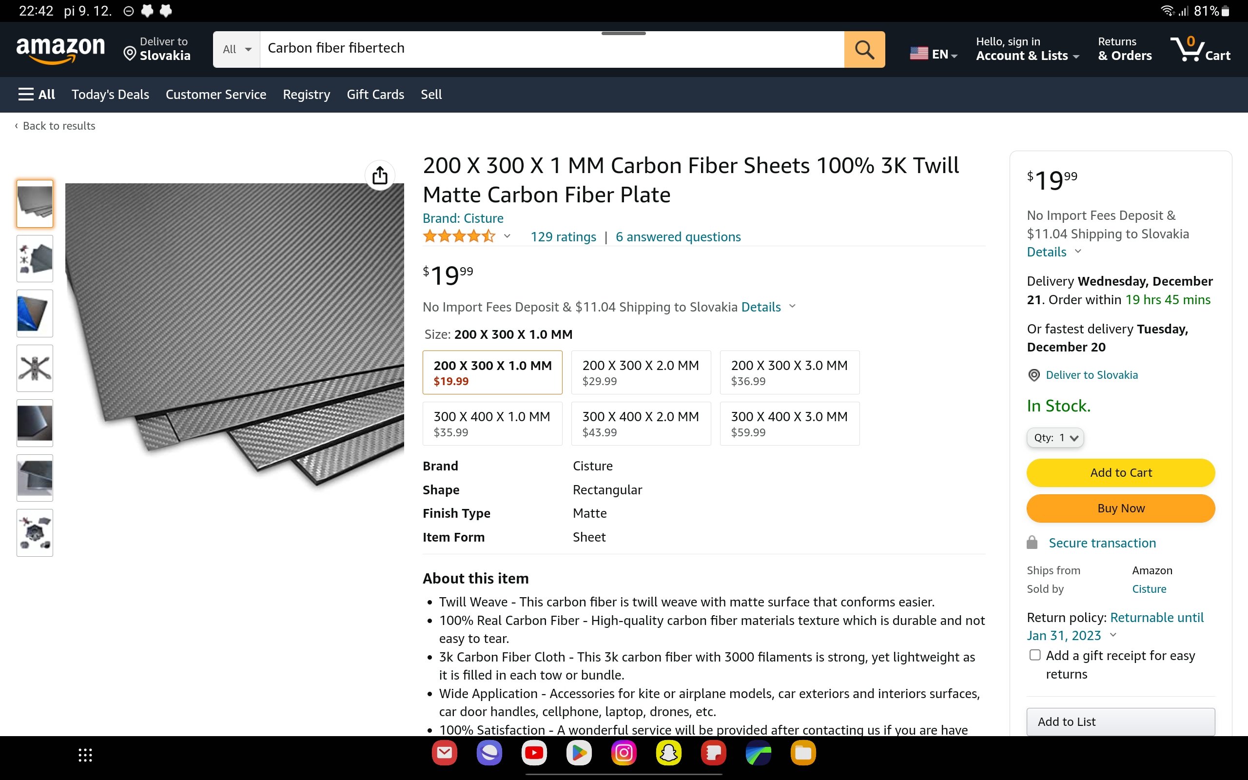

Hello, is it just a carbon fiber imitation foil or is it something other more special ? Thanks for answer. :) @Reaper
