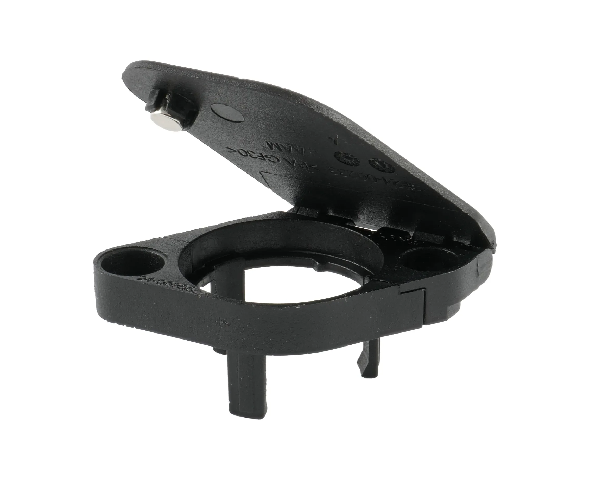

I'm pretty sure the flap unclips somehow, for when you're using the extender. I remember my dealer demonstrating it (I'd showed some interest in buying an extender, but the stock 800 turned out to be plenty)
I believe each bike / most makers have their own flap design, I know my Wild has socket cover that is very effective, it stays put, and is generally water/dustproof. In fact, I find it hard to pull up, and then swivel out of the way, the spring action is very tight.
If it is the same Bosch flap as mine, then it can indeed swivel out of the way and be easily removed for safe keeping, and then replaced later. I am so informed by posts on this thread. :)

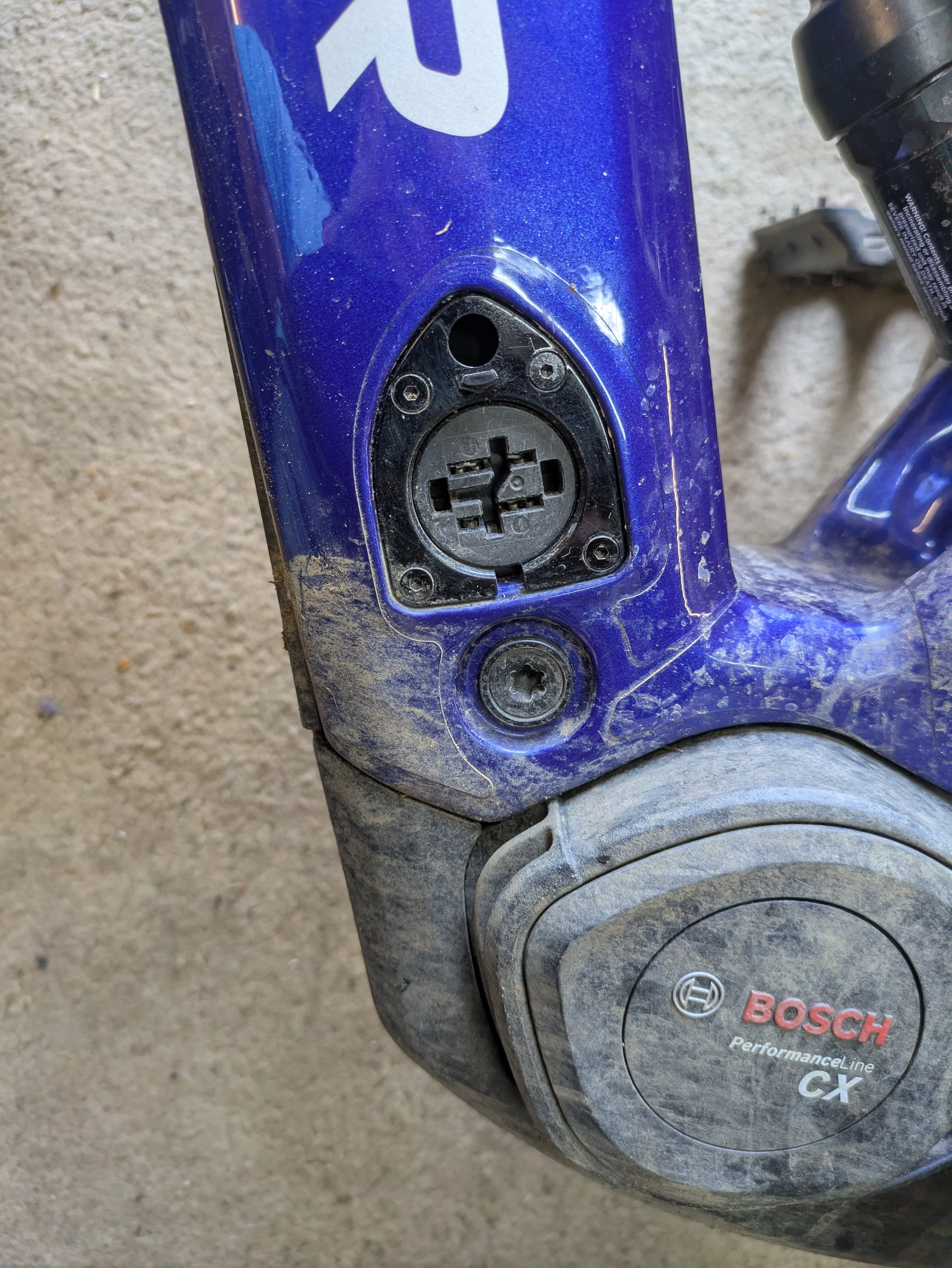

You will find a plastic frame sitting atop the charge socket with the cutout I mentioned before.
Take a look at the photo where I marked the hole with cutout into which the rubber spike will fit:
Thanks @Arminius that looks very similar to the Bosch one, but it's not the same.

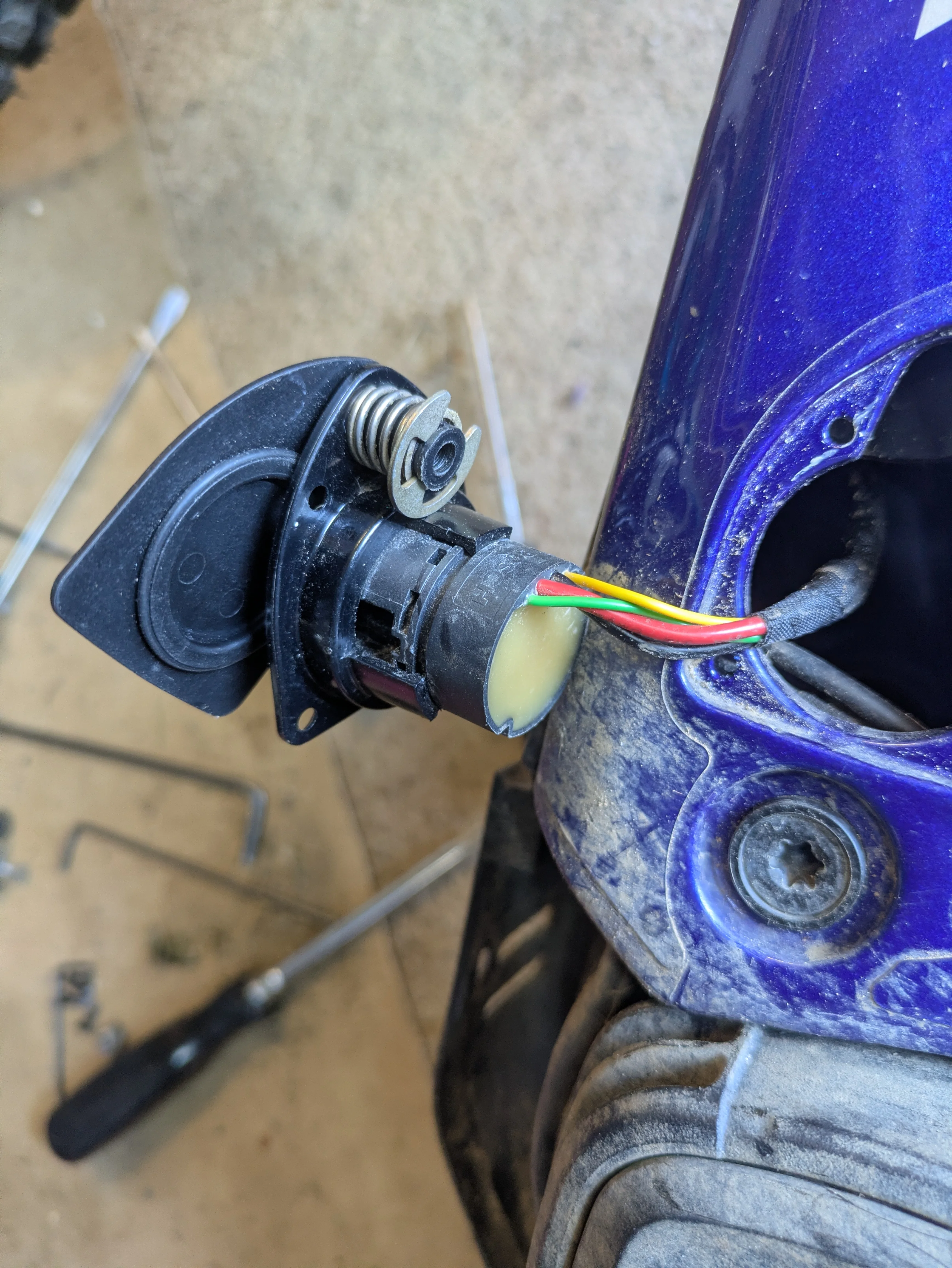

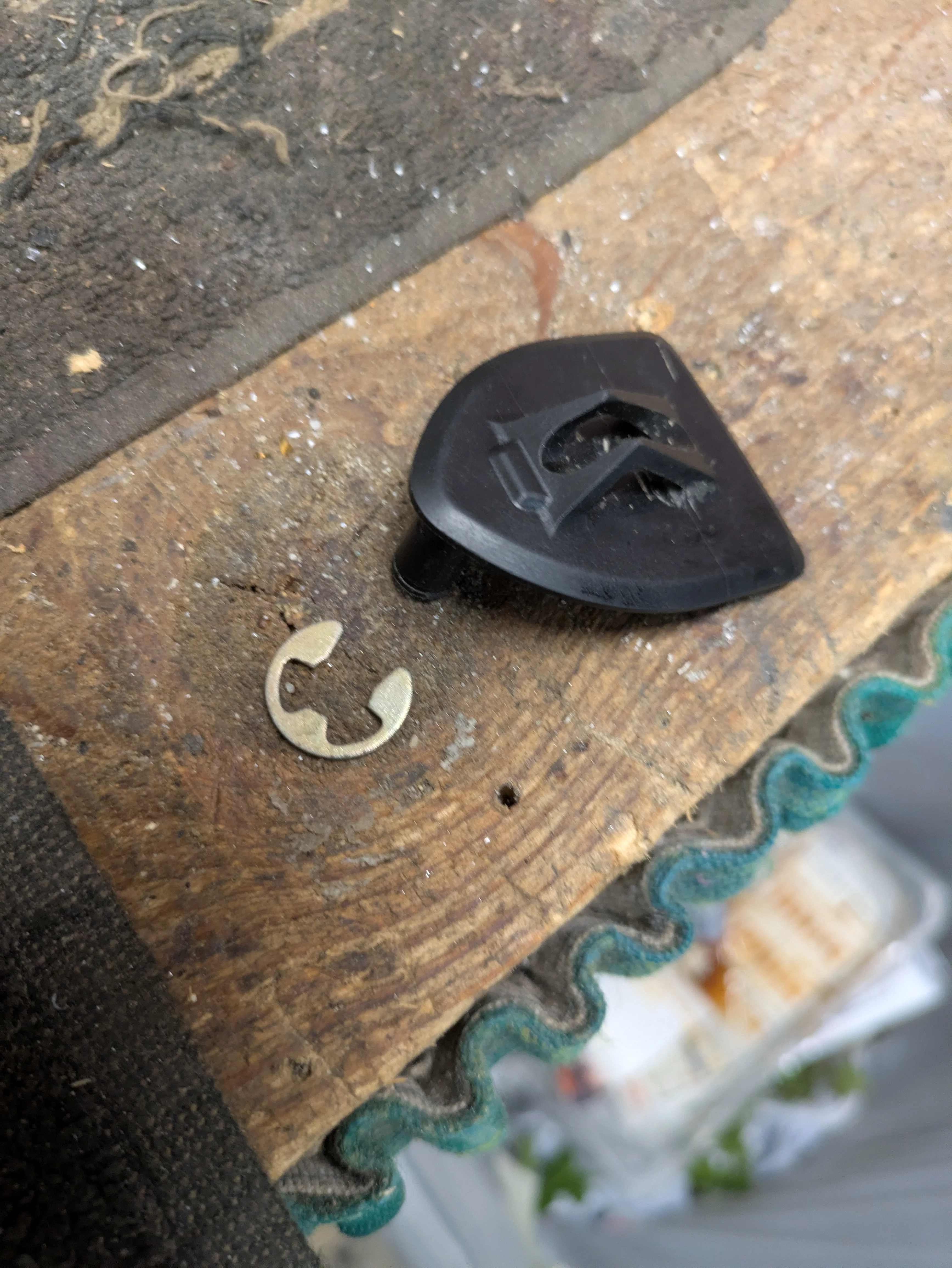

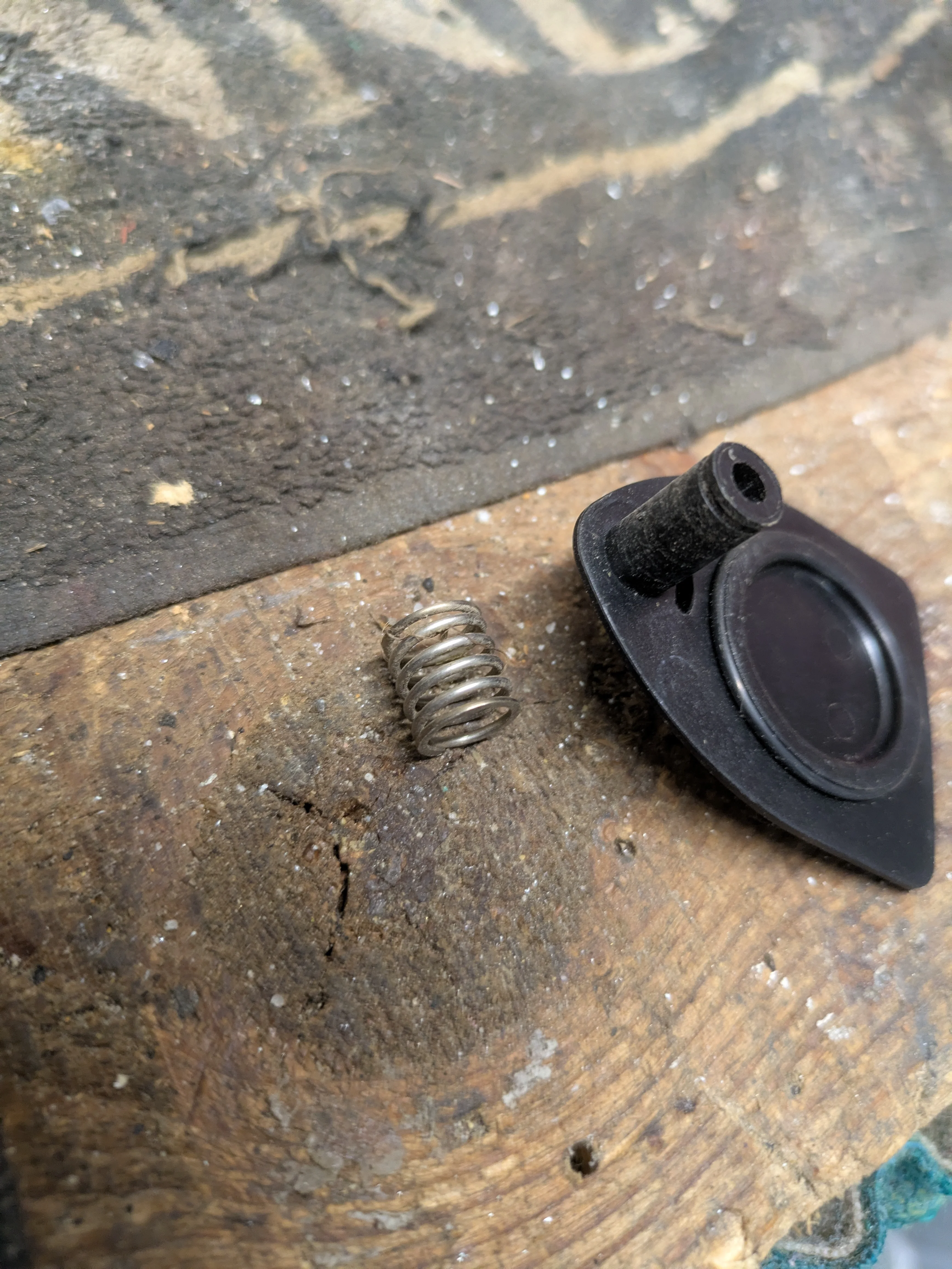

I decided to sort my flap out today 😳
Took the faceplate off and then the engine cover and found a spring, but no clip. Just as well that I permanently borrowed an assortment from a previous employer 😁
Sorry about the doubled up images.( Fat finger club)

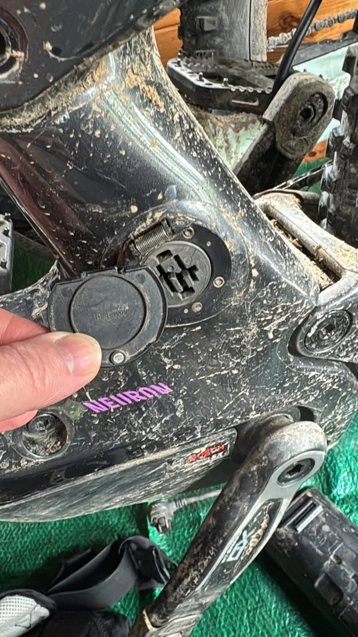

Interesting thread this, and I’m also now a member of the charging port cover detachment club!!!

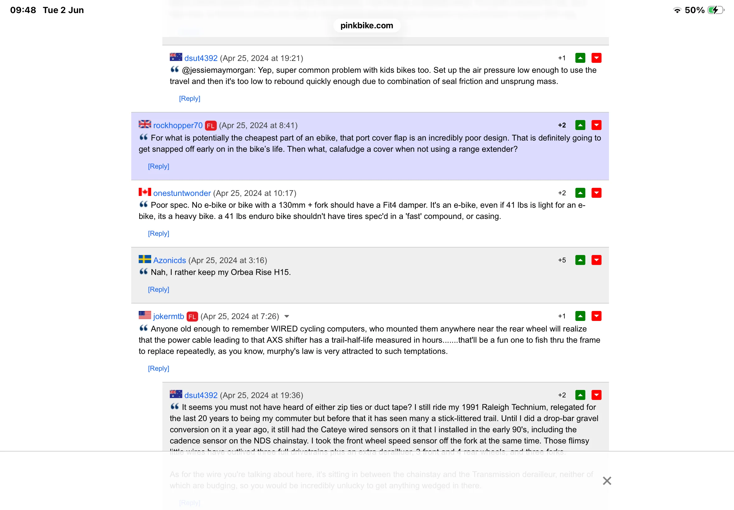

After a ride in the nadgery lakes with the range extender, I heard my cranks glancing the charging port cover. I tried to adjust it to keep it out of the way but to no avail, and one side of the sprung hinge failed. I now have a cover, with one magnet, that doesn’t seem strong enough to keep it on. I had to gorilla tape the cover over the socket when I ran without the RE the following day.
Incredibly, however, and when googling for ideas to improve things, I had commented on this poor design on PinkBike in 2024! I wish I could predict the lottery numbers….

Thanks for the links. I’ve just put a warranty claim in with Canyon and cited that PinkBike article. I’ll see how that plays out but it’s not going to stop it happening again even if they do replace it. I suspect that due to the awfully steep and rocky trails around the Lakes, that my body and foot positioning while riding has caused this.
