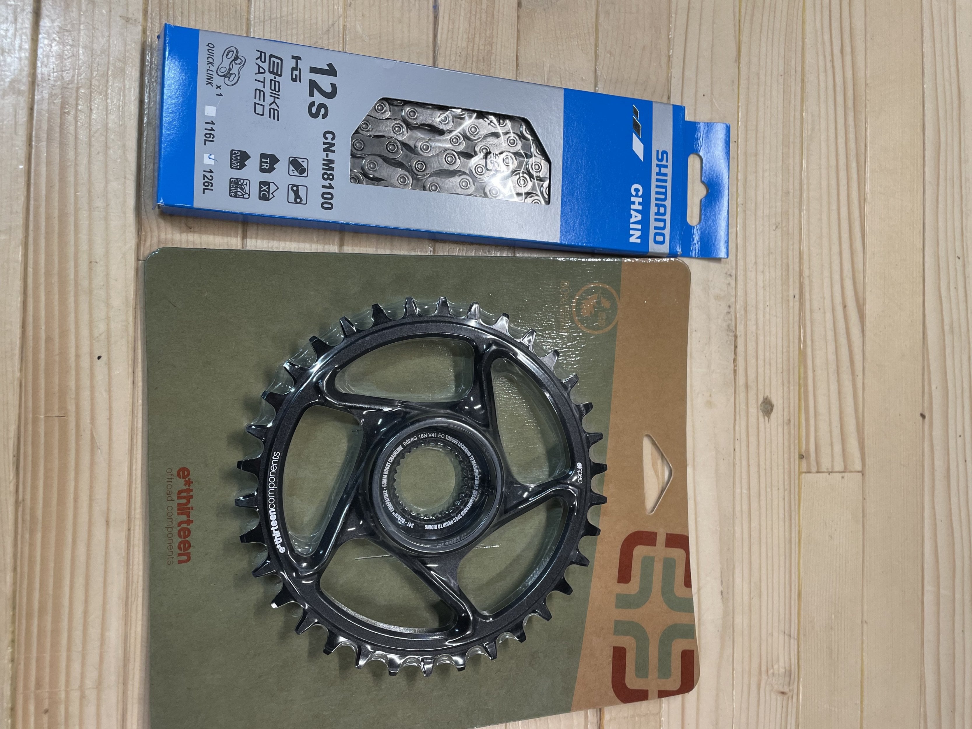

That sounds like it could be the culprit! any recommendations of what front ring to get?
Might be a good time to upgrade the drivetrain. (Chainring, chain, cassette).

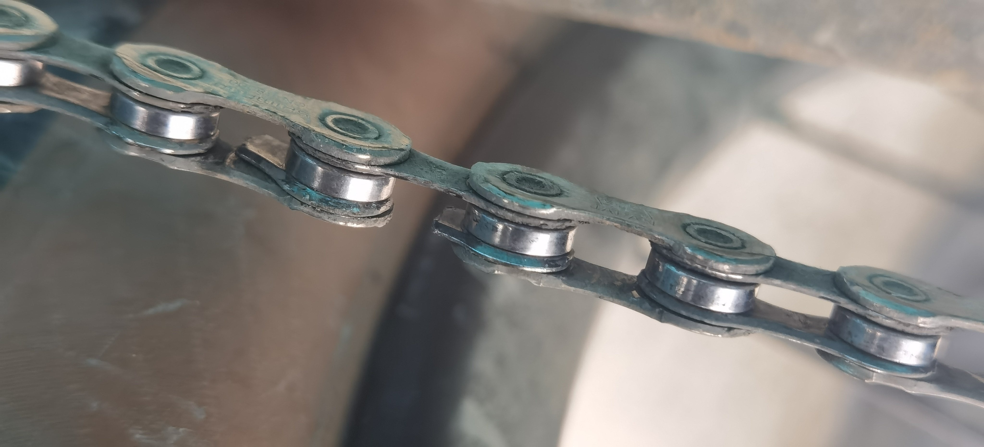

If you’ve developed some chain-suck your consumables are starting to fail. 1700km+ seems about the time to start charging these worn out parts. Servicing, grit and use plays a factor in the life of these components. Like it was said here, isolate the motor by removing the chain and check for noise, movement, bearing slack etc. 43F15B00-390A-4E6F-A1C0-D0BC2F5B6275.jpeg84D6C5BF-5E97-4038-ADAC-3ACB75AFE91A.jpeg
I keep a spare chain and chainring and cassette. They don’t all wear out at the same time.
I was surprised to notice the ring actually does appear to be worn, 1700km is not that much, I put 3500 and 2000km on my last 2 bikes(non E) and never even considered replacing the chainring as they both seemed fine so it must be an e-bike specific thing, the accelerated wear.
whilst looking for chainrings I noticed the steel versions are half the price
E*Thirteen E*Spec Chainring 34t Steel Bosch CR4USA-100
that seems like a good idea?
the chain is only 500km old and the cassette seems fine I can't see any wear and the gears never skip
Make sure you get the special tool to tighten the front sprocket lock nut. They are known to come loose on Bosch motors. Also keep and eye on your cranks if they are E-13
