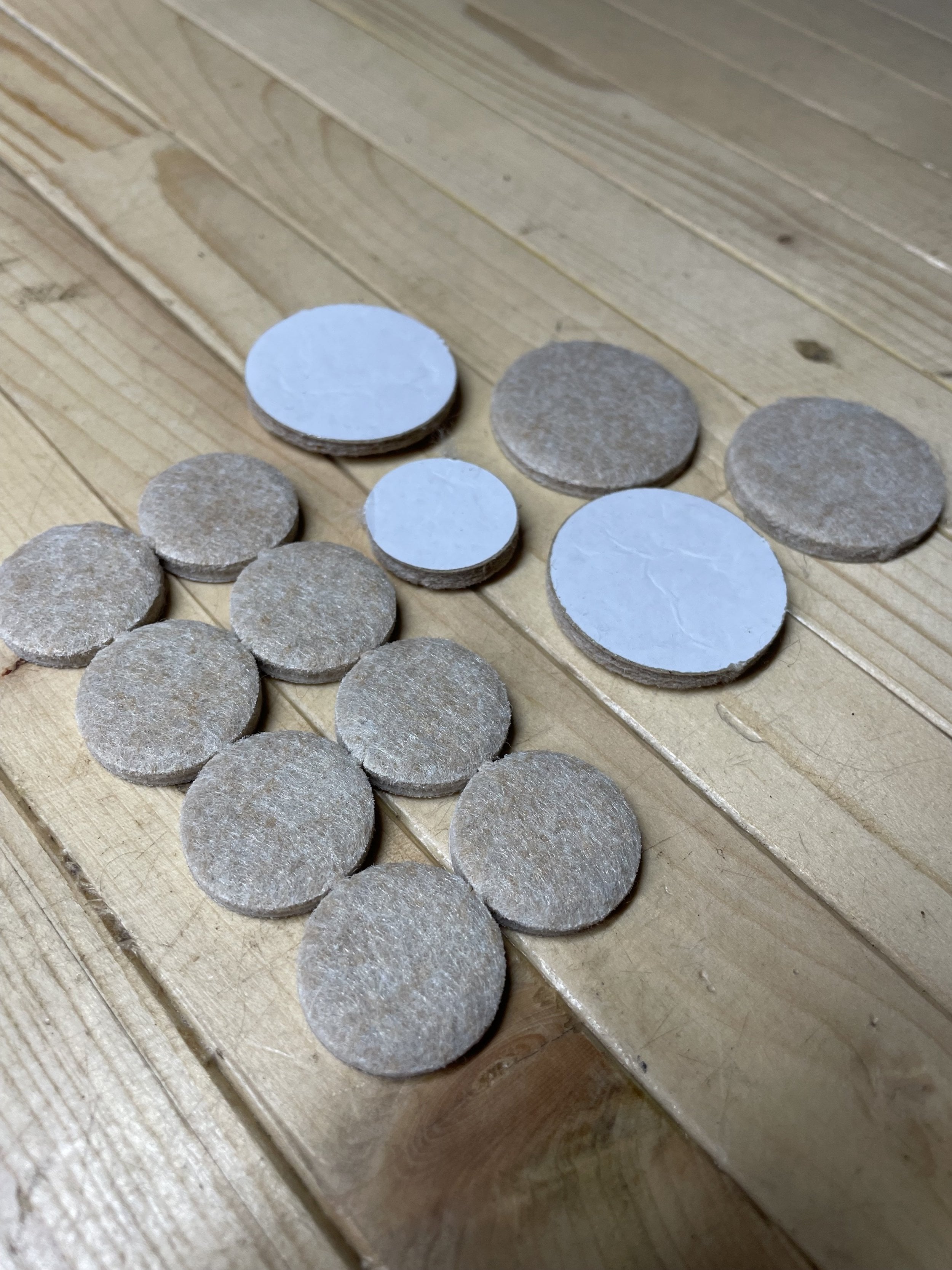

Small felt cushioning placed in the battery compartment helped with irritating rattling noises also.

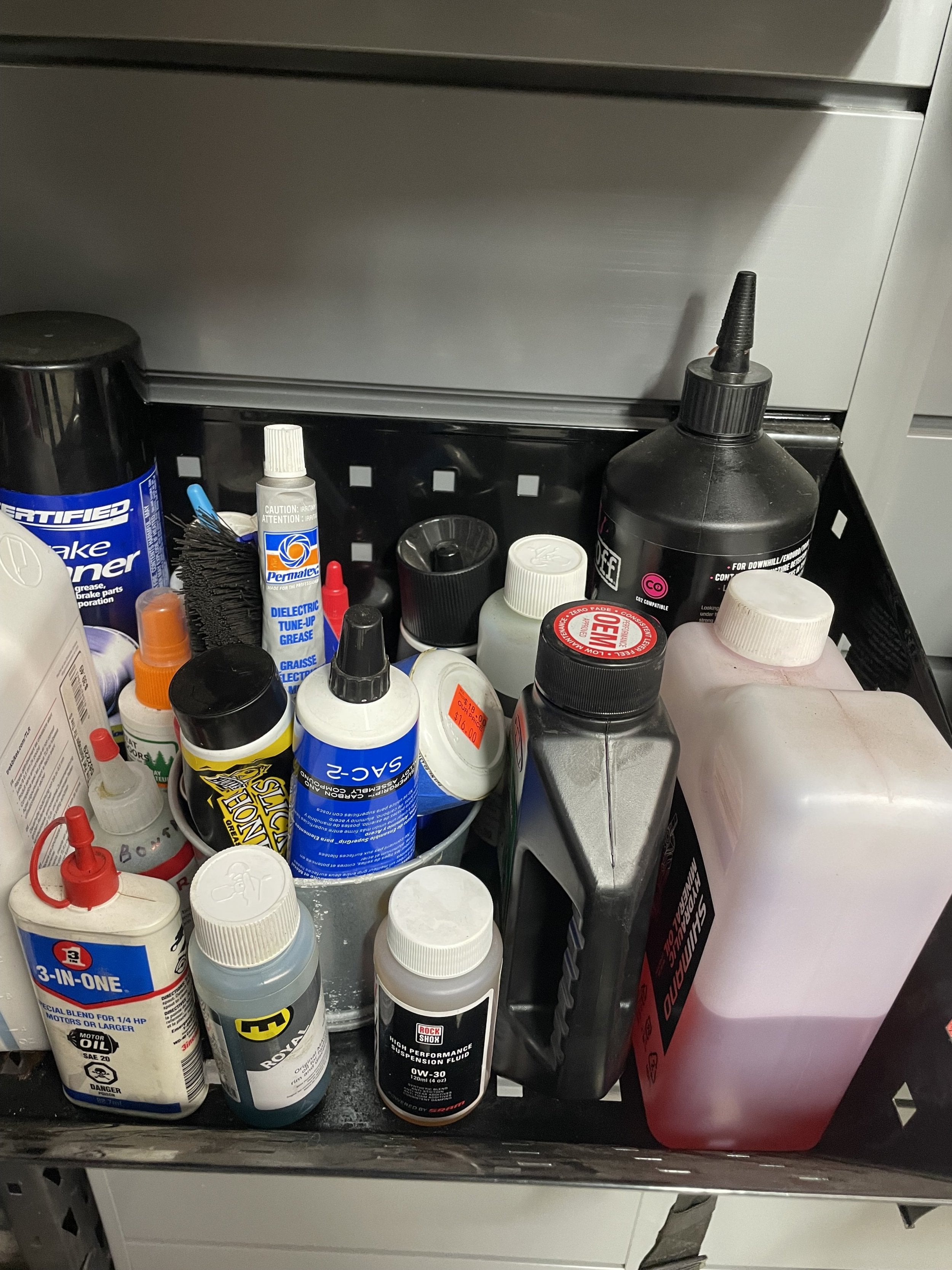

Dielectric grease is a great product under the right conditions and position. I personally don’t apply it to the battery terminal and wiring harness connection. Vibration and/or incorrect fit is the main cause of power loss at the battery terminal. I worry that any moisture in this area may not be able drain out or dry properly.
I do apply a very thin layer of diaelectric grease to the small rubber ribs of wired motor connections (3 or 4). Not to the terminals…because of the mess it can cause. My main reason I use dielectric grease is to keep water out…but in certain areas it can trap water. But if it works 🤷‍♂️

There’s lots of different “lubes n lotions” needed for our eMTB’s. Electrical connections is just another factor to consider. The designers or engineers have hopefully considered the environmental use, but they can't design for everything.
There’s a right or wrong use of dielectric grease. It’s a useful product if applied properly in certain situations.
