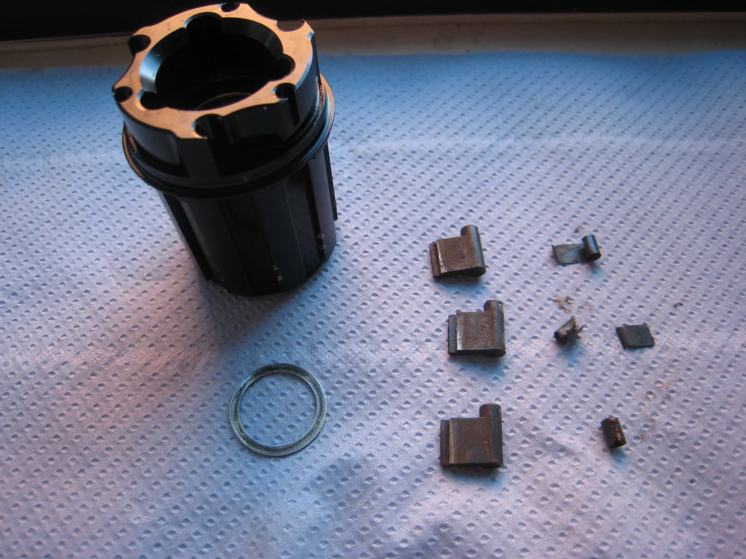

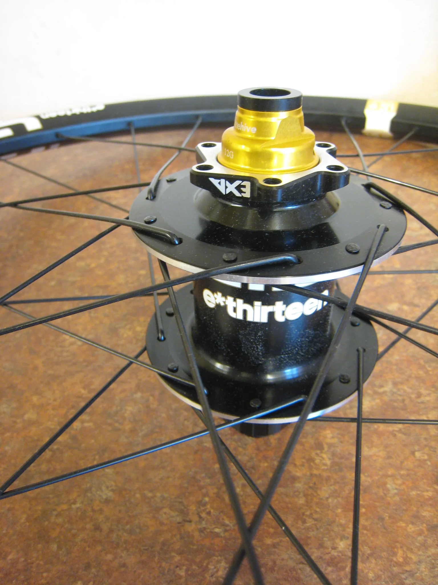

Are you sure that it is not the rear hub? It would explain all of the symptoms.
On my mtb, I had an E13 hub with three spring-loaded pawls on a multi-tooth hub offering 6 degrees of engagement. It was supposed to give "almost instant engagement!". But the hub seals failed very quickly and first one pawl spring rusted through, then a second, until finally after only 128 miles and three months, the hub failed completely. As each hub spring failed, the pawl failed to engage and the symptoms you described emerged.
When the first hub spring failed, the hub engagement would have become 12 degrees; ie a doubling, but not all the time, just one in three! Then when the second one failed, two times out of three it would be 18 degrees of wheel turn before engagement, which was quite a clunk. Followed soon by total failure. The hub, in fact the entire wheelset came with a five-year warranty, which is one of the reasons that I bought that particular wheelset. Yet it failed in three months! It was not at the top of my list for the culprit.
Was that the Sidekick hub, or a different model from E13?
As far as I recall, the whole wheelset was an E13 product. It was a while ago now and I have been solidly put off from buying ANY E13 product ever since. Even their chain device off a different bike was crap and had to be removed.
E13 wheel, new.
Hub 700 miles later, not even three complete pawl springs left!
E13 wheel, new.
Hi Steve,
Chris from e*thirteen here. Sorry to see the trouble with that hub. The wheel you have there is a VERY old wheel (from production ~10 years ago). Our hubs have improved greatly since that version and Id gladly get you set-up with one of the newest versions. Could you drop us a line at [email protected] so we could get a bit more info from you about the wheel.
Thanks in advance and sorry again about the trouble.
Chris
