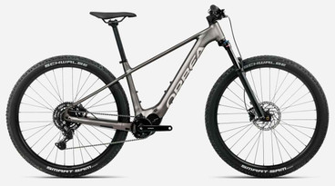

Orbea Urrun 30Shimano EP600 (not EP6)540WhSR Suntour XCR32 120mmShimano Cues 9sp£2,339
Two corrections to my earlier post, and one to your shortlist:
• The Orbea's motor is the Shimano EP600 (a mid-tier full-power unit), not the EP6/EP801 trail motor.
It's the most "trekking/light trail" of the bunch - fine for towpaths and gentle stuff, less so for proper Peak trails.

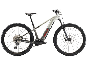

@Greg Watts we mostly ride road, canal paths and light trail stuff so hardtails are where we are looking, the Trek spec is
FRAME:Alpha Platinum Aluminium, Removable Integrated Battery (RIB 2.0), tapered head tube, guided internal routing, Control Freak internal routing, Motor Armour, Boost148, 12 mm thru axleFRAME MATERIAL:AluminiumFORK BRAND:RockShoxFORK:RockShox Recon Silver RL, Solo Air, Motion Control damper, lockout, tapered steerer, Boost110, 15 mm Maxle Stealth / Size: M/ L /XL: 120 mm (29) Size S: 100 mm (27.5)FORK TRAVEL:120 mmMOTOR:BoschMOTOR CONTROLLER:Bosch Smart System Purion 200DISPLAY:Not IncludedDRIVE UNIT:Bosch Performance Line CX Gen 5 (85 Nm - 120 Nm ) Smart SystemBATTERY:Bosch PowerTube 800 Wh BatteryRANGE EXTENDER:Bosch PowerMore 250Wh Available for PurchaseCHARGER:Bosch standard 4A, 230V, smart systemWHEEL SIZE:29WHEELS:Size S Rim: Bontrager Line TLR 30, Tubeless-Ready, 28-hole, Presta valve / Size M, L, XL: 32-hole / Spokes: 14 g stainless steel, blackTYRES:Size: S Bontrager Gunnison Pro XR, Tubeless-Ready, wire bead, 60 tpi, 27.5x2.40" Size: M , L , XL Bontrager Gunnison Pro XR, Tubeless Ready, dual compound, aramid bead, 60 tpi, 29x2.40"DROPPER SEATPOST:YesSEATPOST:Size S: Bontrager Line Dropper, 100mm travel, MaxFlow, internal routing, 31.6 mm, 310 mm length / Size M , L , XL: Bontrager Line Dropper, 170 mm travel, MaxFlow, internal routing, 31.6 mm, 450 mm lengthSADDLE:Bontrager Commuter CompCRANKSET:E*thirteen E*spec Plus, 160 mm lengthHANDLEBAR:Bontrager Comp, alloy, 31.8 mm, 40mm rise, 780 mm widthSTEM:Bontrager Comp, 31.8 mm, Blendr compatible, 7-degree, 50 mm lengthGRIPS:Bontrager XR Endurance Comp, lock-onSHIFTERS:Shimano Deore M6100, 12-speedBRAKE BRAND:ShimanoHYDRAULIC BRAKES:YesBRAKES:Shimano 4-piston hydraulic disc, MT4100 lever, MT420 calliperREAR DERAILLEUR:Shimano XT M8100, long cageCHAIN:Shimano Deore M6100, 12-speedNUMBER OF GEARS:12 SpeedPEDALS:VP-536 nylon platform

Good news on the Trek - that full spec confirms it nicely.
Trek Powerfly 6 Gen 5 (M), what you've pasted:
• Battery: Bosch PowerTube 800Wh (removable, RIB 2.0) - plus PowerMore 250Wh extender available if you ever want more range
• Fork: RockShox Recon Silver RL, 120mm, with lockout (handy for road/canal stretches)
• Drivetrain: Shimano XT M8100 rear mech, Deore shifters, 12-speed
• Brakes: Shimano 4-piston hydraulic - proper stoppers
• 170mm dropper on the M, 780mm bars
That's a strong build for your riding - road, towpaths and light trail.
The 800Wh battery is the standout: realistically expect somewhere around 40 - 55km on mixed terrain depending on assist mode and how much road you do, and more if you're spinning along flat canal paths in a low mode.
For all-day pootles that's genuinely useful headroom, and the removable pack makes charging easier.
