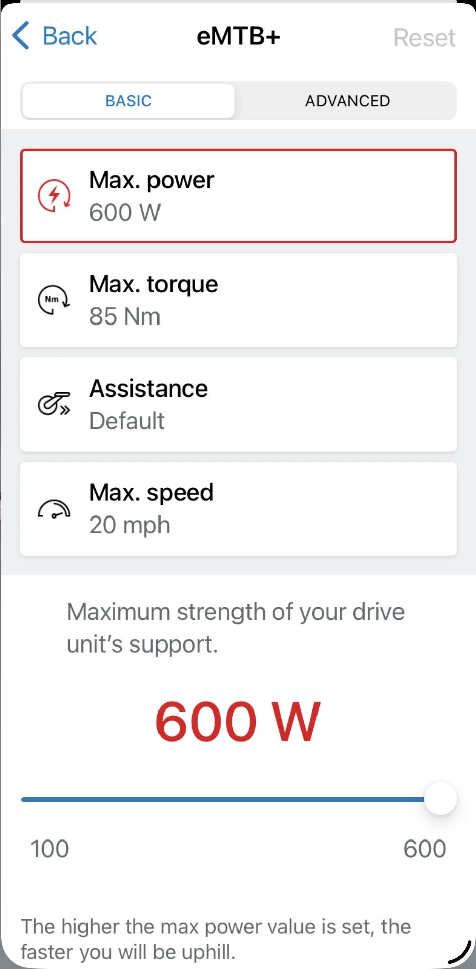

Just starting to get to grips with the settings on my newly-acquired Orange Patriot - CX Gen4
There’s the usual eMTB+, Auto, Tour and Eco settings, but it looks like they are all the same - here’s eMTB+
The other three modes are all exactly the same, which I’m assuming is a bit pointless?
Also - where did the 20mph max speed come from? I’d like to keep this if at all possible, as 15.5mph is a royal PITA on my local trails on Cannock Chase
Assistance very welcome for a newbie used to the simplicity of a Shimano E8000…

Click on each of the 4 critera to adjust. The main one for your motor is "assistance" . I have no idea how you got 20mph unless you are not in the UK or Europe

20mph is the maximum power assist from the motor. I assume you’re in NA. 32kph is the maximum power assist in Canada …but I can go faster. 😉 (gravity is my friend sometimes).
