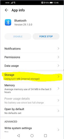

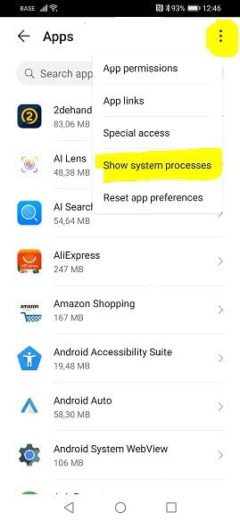

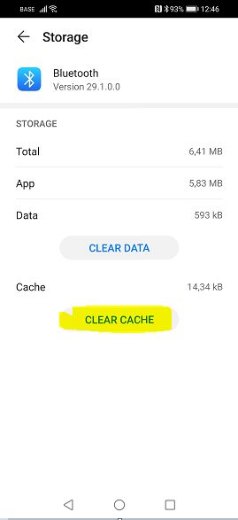

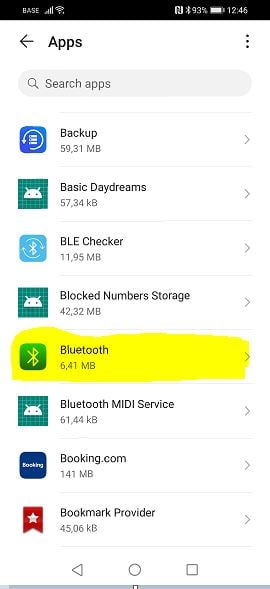

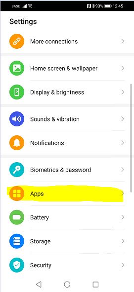

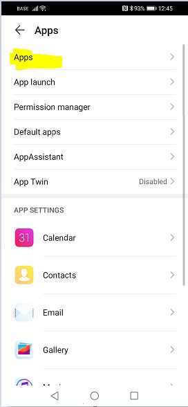

Recently I bougth myself a Specialized Levo...and it wouldn't connect to my phone. I read on the web it was due to the fact that I had a Huawei...but later on I found out that the main reason was Android 10. The solution is to clear the bluetooth cache and restart your phone (restarting is not always needed) before starting the app. Give it a try and follow the steps below - should be almost the same on another android phone. Hope it works for you as well ?.
