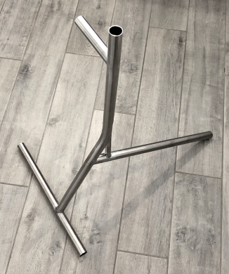

I don’t know about other EEBs but the Giant Trance e+Pro presents a dilemma when it comes to finding a spot to ‘hook’ a bike stand prong into. I’ve had several attempts in studying how to design a bike stand for it (that can also function as a work stand), but I’m left stumped each time. The only way I’ve been able to do this is to clamp a length of pipe against my workbench vice and hang the bike saddle over it. This is the only way I can rotate the drivetrain to check, repair or do service/maintenance to whatever (and also remove the rear wheel if needed). Problem is, I can’t use my workbench when the bike is hanging there and obviously I can’t store my bike like this. I could similarly fasten a pipe against a wall, but it'll be just as restrictive location-wise.

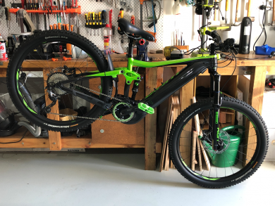

Below is what I came up with. Not saying this is the best way or the only way to do it, but for now - it works for me. The bike stand prong hooks underneath the top Maestro linkage. I inserted a rubber handlebar grip over the prong to act as a cushion and not scratch the paint.
The tricky part is the clearance between the vertical member of the stand and the left crank arm (see below). The 1” diameter stainless steel tubing I used (25.4mm Ø) is only just clearing the arm by about a 1mm gap. It’s finicky… if the stand doesn’t hook-up precisely, or if the bike moves - the crank arm hits the stand. I might redesign it again later on, but next time will use a smaller 7/8” vertical tube (22.2mm Ø) but with a thicker wall thickness. The eBike is pretty heavy and a smaller diameter tube might flex if the walls aren't thicker.
Anyway, it works nicely as a park stand… and with a bit of care with positioning, I can get the cranks to rotate - which comes in handy when I want to apply chain lube before a ride - or quickly scrape the mushy crud off the derailleur jockey wheels (a pet hate of mine) with a popsicle stick. (y)

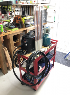

There’s a bit of a background as to why I made a DIY stand. Since my retirement, one of the things at the very top of my ‘Bucket List’ is to finally learn how to TIG weld. Over the years I have learnt to gas weld, stick weld, and MIG weld. I have always considered TIG as the ultimate, but 20 years ago most TIG machines were huge transformer beasts and were cost prohibitive. Then there’s the added cost of Argon gas bottles… so no can do.
Couple of years ago, my son beat me to it. He secretly enrolled in a TIG welding class at his local Polytech so that he can build himself a bike stand for his motorcycle. Then he uploaded his stand pics and I immediately caught a pitiful case of FOMO.
Not to be outdone (plus the timing was right), I took the plunge and finally bought a TIG machine. Technology has also advanced quite a bit and modern machines are now much smaller inverter types and the prices have come down too. Seeing as I was already well versed with 3 different methods of welding, I presumed the learning curve would be easy enough. I was wrong! For TIG welding, even very small mistakes and errors are very unforgiving.
Proper technique and machine settings require a level of perfection and accuracy possessed only by anal-retentive sociopaths! ?
Screen Shot 2021-07-30 at 1.05.18 PM.png Screen Shot 2021-07-28 at 12.37.37 PM.png
I decided that my first foray into Stainless Steel (more difficult) should be a bike stand for my Giant. The stand may look decent but there's bound to be professional TIG welders in this forum… so no close up shots of my weld beads. They'll know that there's lots wrong with it. So do I, but I’m just not capable of doing any better at this stage. ?
