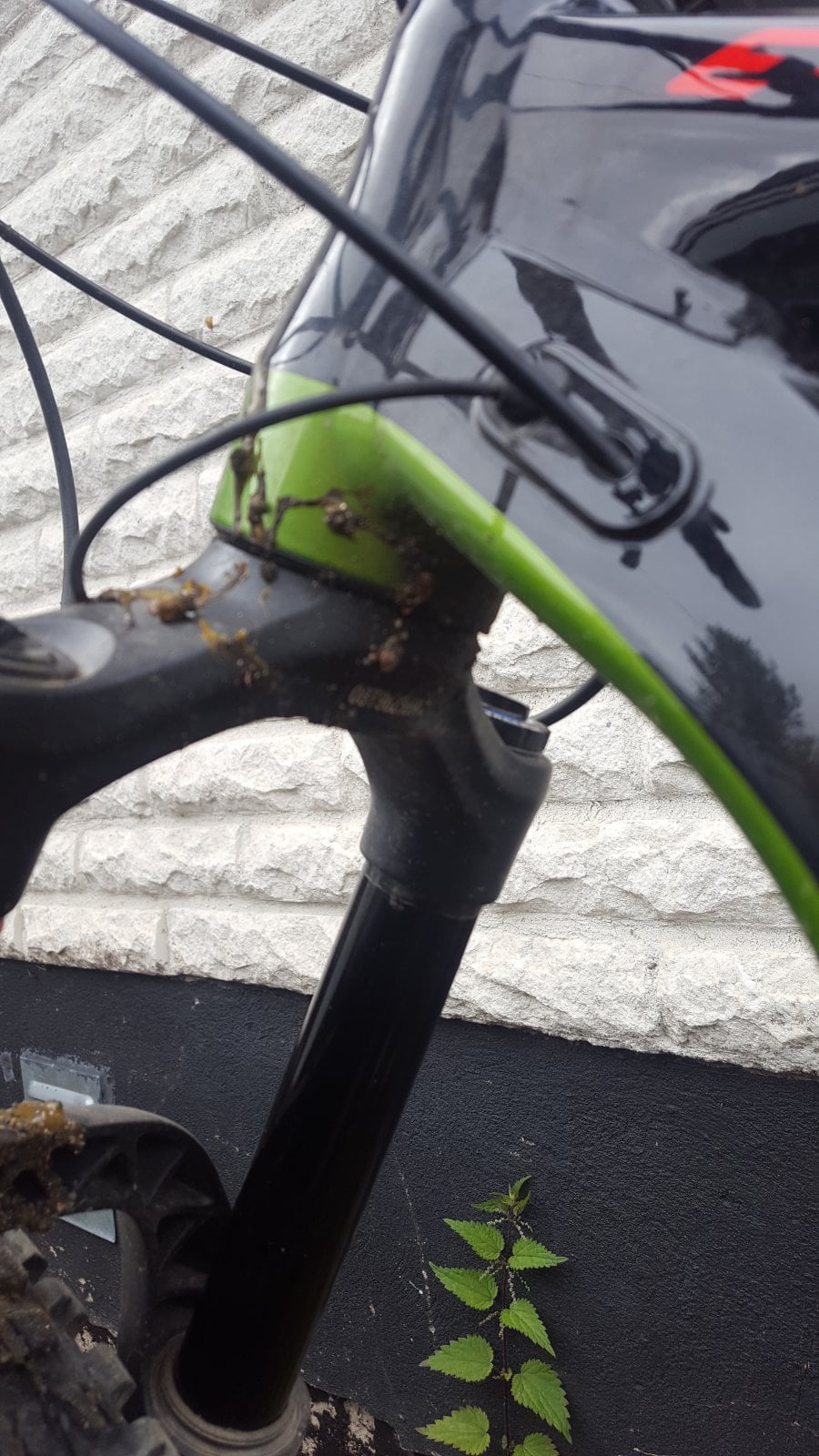

Was out on a bike ride today where suddenly the bike spat out some thick yellow brownish grease from the stem/headset and onto the wheel so it threw some grease onto the crossbar of the fork.
So im wondering what should i do next/check for? bearings?

Is it a brand new bike, and does the headset still feel ok (not grinding or wobbling)? It could just be some excess grease that ended up inside the headtube during manufacture and dropped out after a few miles of riding. If it is very new and and you can't feel any roughness in the headset I would just clean off the frame and carry on riding. If it feels bad though take apart the headset and inspect the bearings.

Yeah bike is brand new!
Yes nothing feels off or rough, i cleaned the bike and rode home. Gonna keep an eye on it tho!

Usually they aren’t too generous with grease when assembling the bikes, so my guess is that a seal has come off at the lower headset bearing. Do you know what brand the headset is?
More likely water mixed with grease? Been washing it? Upside down?Does not take more than a few minutes to drop the fork out of the headset so I would certainly do that to check whats in there!
I’d drop the fork out, clean the headset up and re-grease.
As said earlier they’re usually quite sparing in the grease dept. when assembling new bike.

Dropped the fork and re-greased. Working perfectly now.
