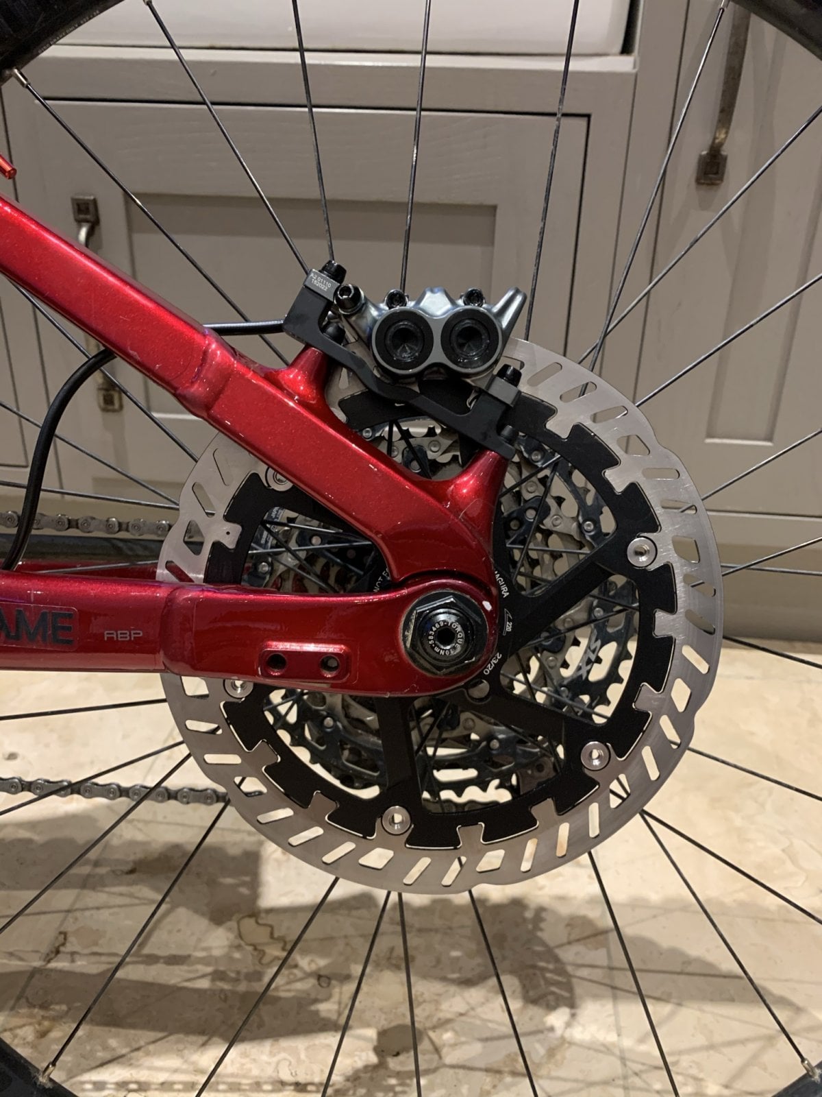

Everyone seems to be running 220 on the back of the Rail just fine. I was on the phone to Trek today, was told 203 max size, 220 might work fine in a straight line but would rub the chainstay when cornering due to frame flex. Any damage not covered by warranty etc. Nobody has had any problems at all with the bigger disc rubbing on the frame?

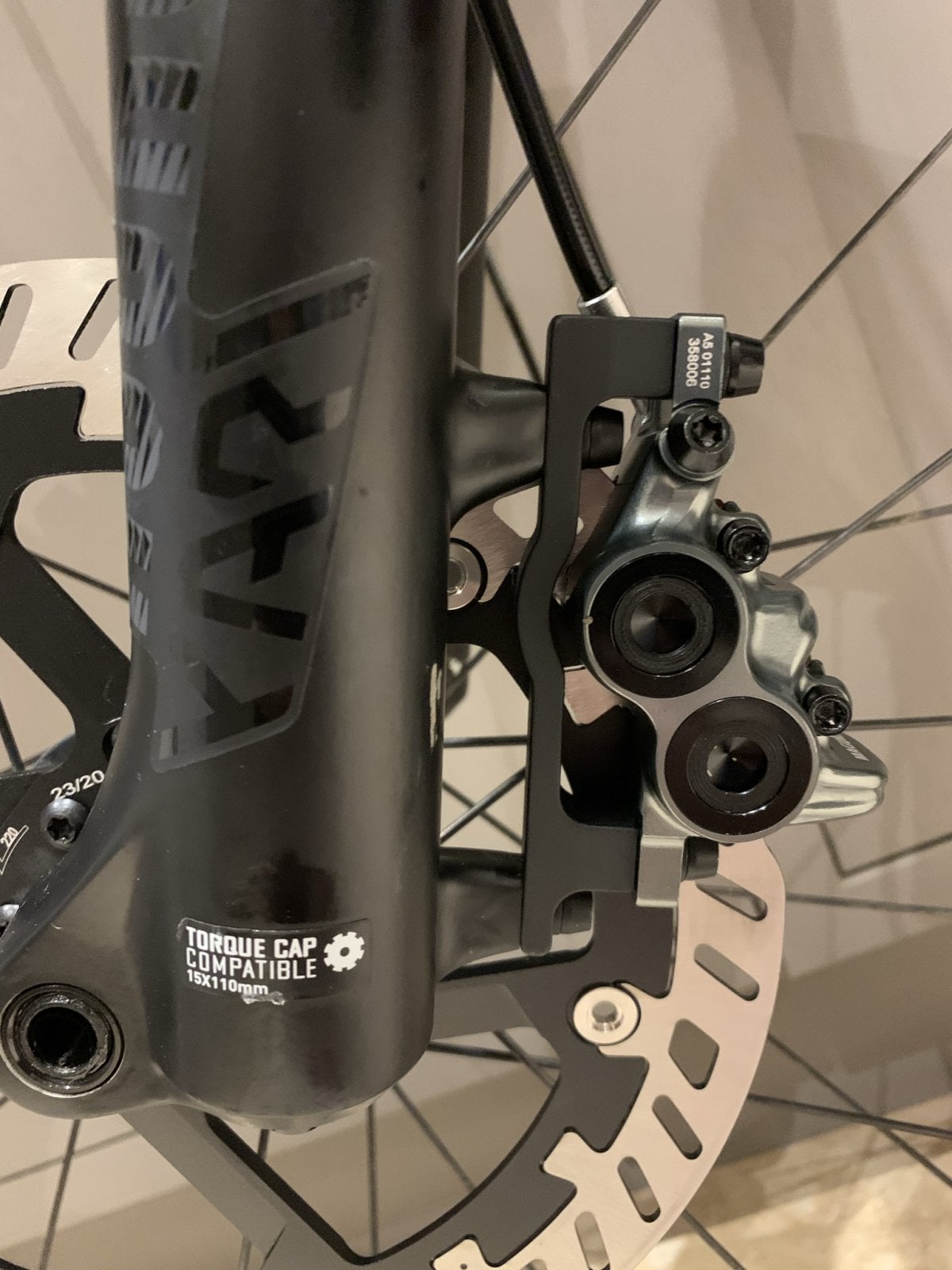

I got confused over this too...for the 2020 Rail, both the frame and fork are Post Mount 180mm. This is the minimum rotor size, meaning if you take off your adapters and bolt your calipers directly to frame / fork, you'd be running 180mm rotors. So the adapters you need are post mount 180 - 220mm, these ones should do the trick
Thos of you who have gone to 220mm, Can I just buy a 20mm adaptor & add it on to the existing adaptor to bring it out to match or do I need to get a 43mm one? 2020 Yari 35mm forks.
It also seems that most of the available rear wheels have centrelock hubs. Has anyone found a way around this re the rear magnet?
You need QM45 adaptor front and rear for 220mm rotors.

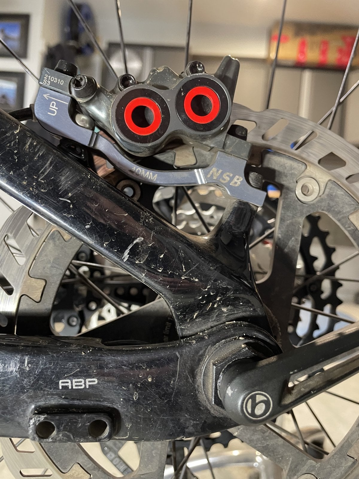

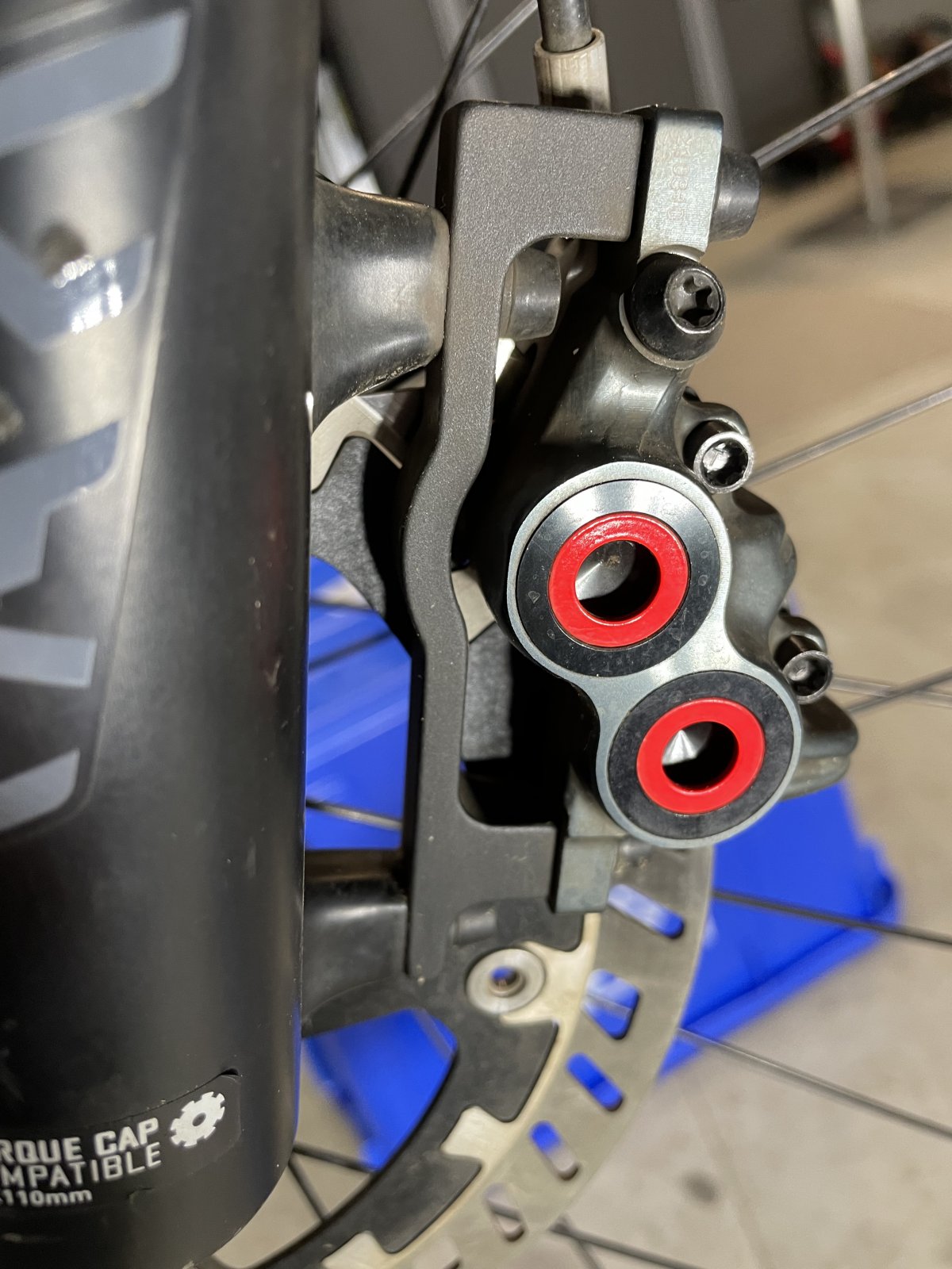

The QM 45 adapter is the correct front and rear adapter for the 220mm Magura 6-bolt rotor. Do not stack adapters to achieve the proper fit. The 2020 Rail I have came with a Yari fork setup for a 180mm rotor but an adapter allowed a 203mm rotor. (Suitable for eMTB’s). Like @WilkyWay said, QM 45 adapter from Magura works.
However, NSB (North Shore Billet) also make an adapter that works, 40mm. I use one of each, only because it was all I could get at the time. All the other 220mm rotor and MT7 brakes I’ve installed have NSB 40mm adapters.
North Shore Billet is located in Squamish BC but they ship everywhere as far as I know.
A fork other than a Yari style may require a different size adapter.
Just ensure the fit and pad-to-rotor alignment is correct. (The cameraman was a little shaky) Both types of adapters are identical except for that one bolt 🤯
