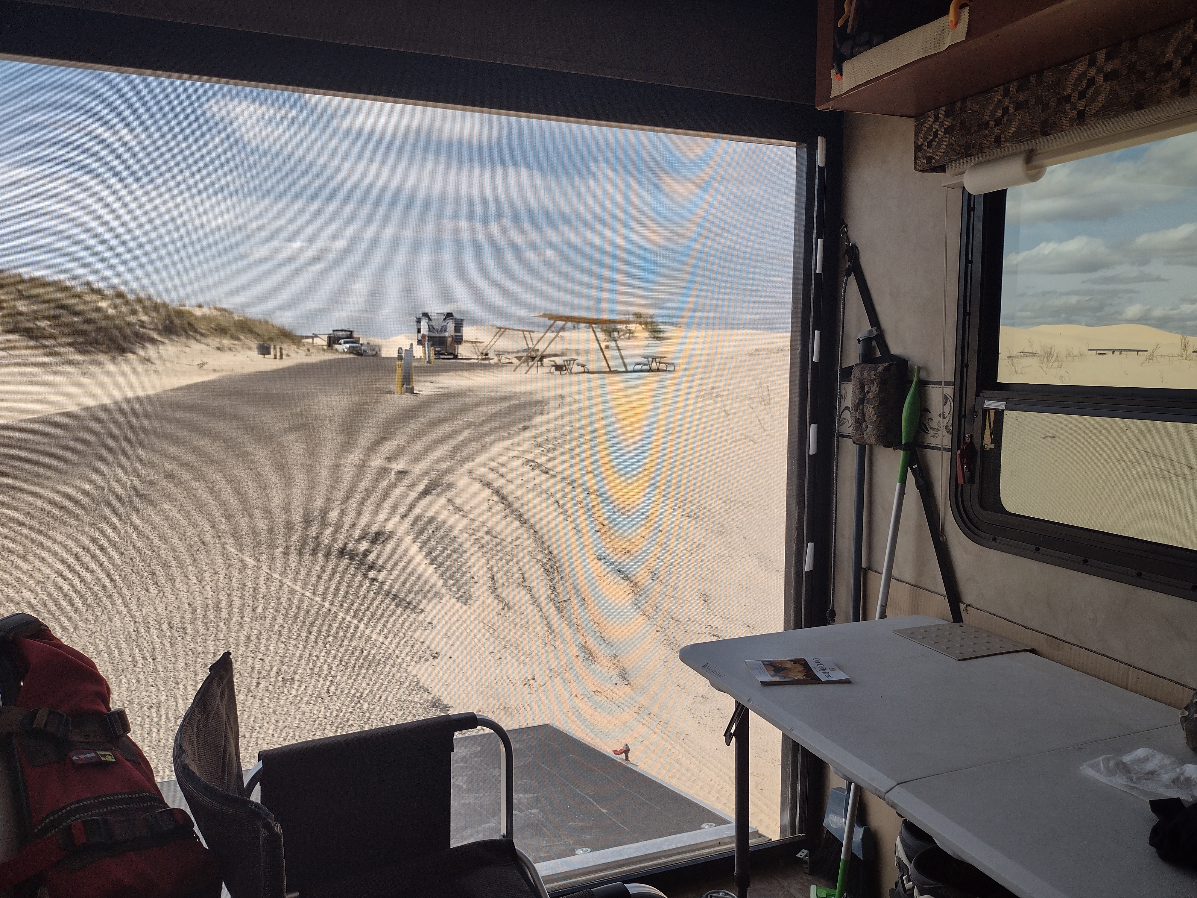

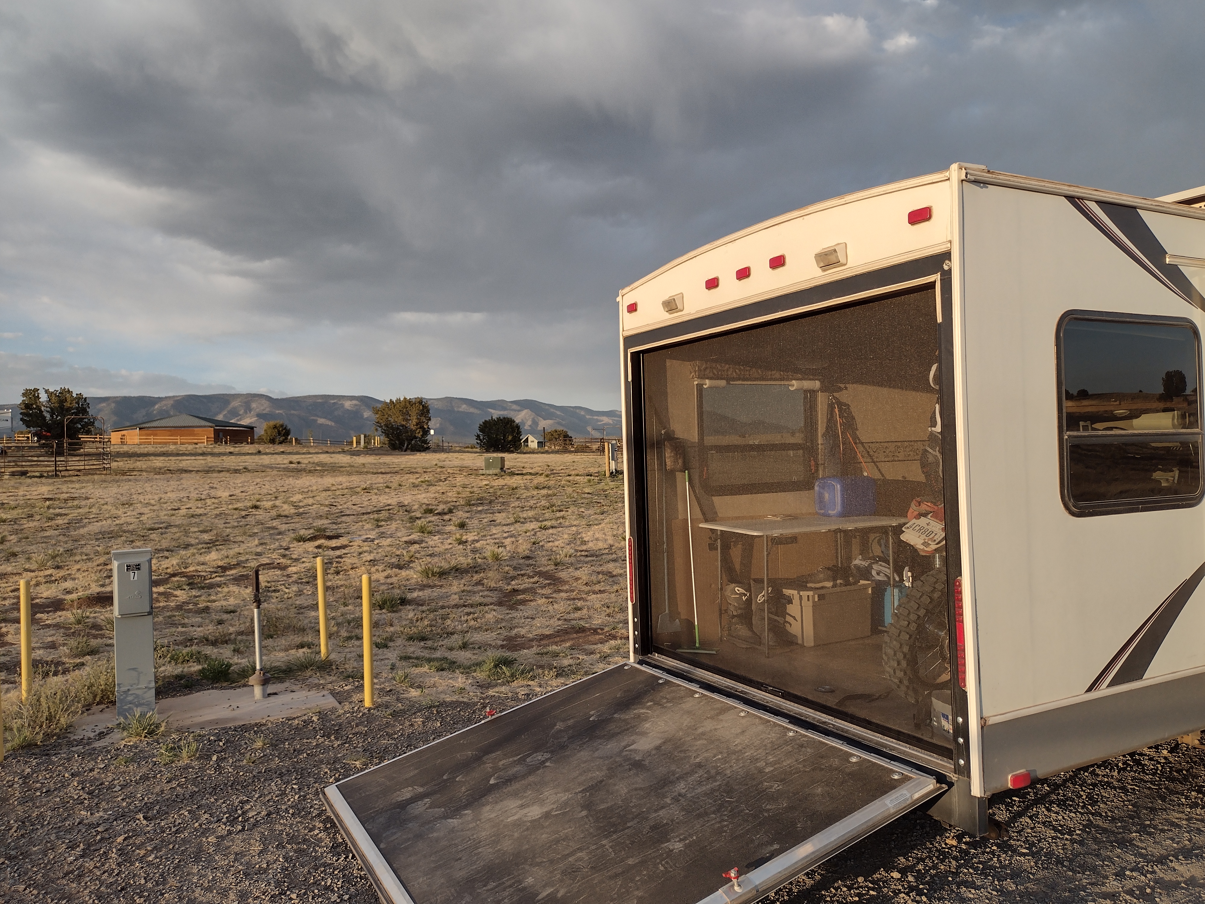

On your future RV selection, I highly recommend the toy hauler...and I don't necessarily mean the huge, 5th wheel monsters. I've had different pull-behind RV's over years, but the best choice I ever made was a medium sized toy hauler. Now, while I'm also a motorcycle guy, the beauty of the toy hauler is that open space in back that can be turned into whatever you want. Most of the furnishings in reasonably priced RV's is pretty sorry IMO. The open back let's you set it up however you want.
Then there's the open back end with the screen system that's usually installed that gives you a patio/porch like setting which is awesome when the weather and conditions are favorable. I can take my emtb or my dirt motor or both. I didn't go with any slideouts, as most any of them add about 1000 pounds at least.

Yes, you're right to consider weight, but the 26' toy hauler pictured here has been towed by a 1/2 ton 2012 Ram since 2014 all over the U.S. coast-to-coast over many trips since we've been retired since then. The Ram does have a hemi which helps, but if you're judicious about the weight of the RV, a 1/2 ton PU can pull a decently sized RV. The load leveling, sway control hitches these days are pretty amazing.
I recommend staying away from slideouts and not going too long. My RV here weighs 4400 pounds empty. A lot of RV's and especially toy haulers have a lot of unnecessary weight in furnishings, lots of beds, etc. Really a toy hauler should be a big empty box with a kitchen, bathroom, and bed. I pulled all the unnecessary stuff out. Now if you have kids, you may need an extra bed or two. But I will say if you pick the right toy hauler, you don't need a diesel truck to pull it.
