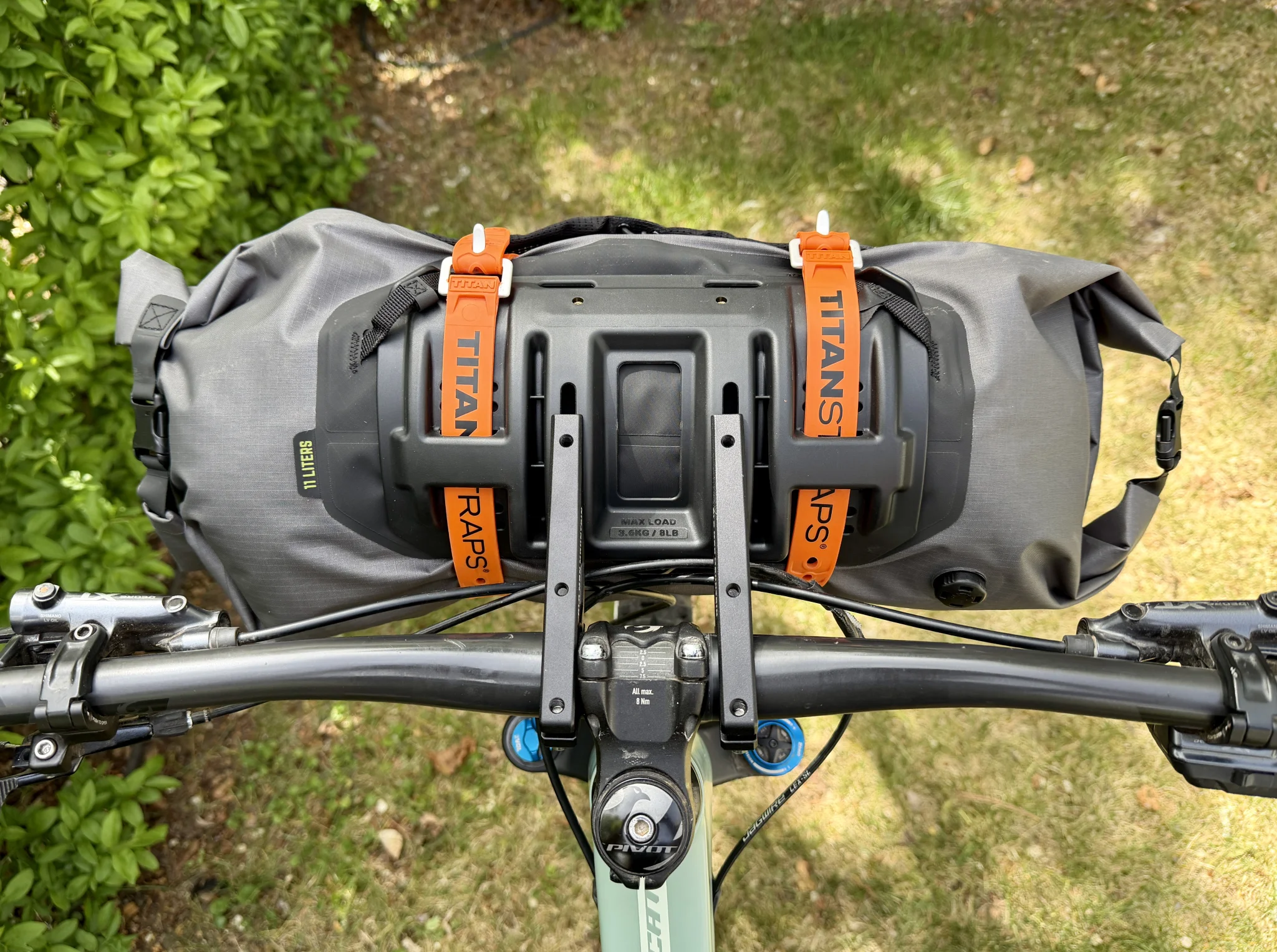

@ep8-rs - right, now that's an interesting suggestion. Proper bikepacking hardware rather than a floppy dry bag lashed to the bars with hope and cable ties.
The Old Man Mountain Manzanita Cradle is a collaboration between OMM and Salsa Cycles - essentially a spiritual successor to the legendary Anything Cradle. Salsa concluded their core competency is building bikes, not bags, so they handed the Anything Cradle legacy to Old Man Mountain to iterate on.
Why it's worth considering for @broes!'s Rail XL:No cable fouling -
having a bag right against the bar smashes brake hoses and cable routing. A rigid cradle solves this by moving the handlebar roll away from the cables and hoses.
On a Trek Rail with internal routing, that matters. • Bar compatibility -
compatible with 35mm and 31.8mm handlebars thanks to included shims. The Rail XL runs 35mm bars, so no adapter faff.
Correct bag option - the 11L Side Load bag is more popular on flat bar mountain bikes; the 9L Top Load fits better on drop bar road and gravel bikes.
So for a flat-bar eMTB: 11L Side Load is the call. • Actually stays put - it was tested during a three-day ride through brutal terrain on the Peaks and Plateaus Loop in Moab, which - as you'll know - is not exactly a gravel path.
OMM's Atlas Rack Pack didn't survive Steelbender, but the Manzanita Cradle came through with flying colours. • Accessory mounts -
