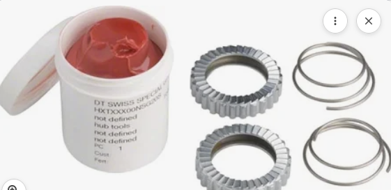

I bought a 54t ratchet kit which came with a thimble of special grease:
That was probably 10 years ago, the ratchet is still perfect and I have roughly half the grease left despite owning 5 pairs of DT swiss wheels since then.
