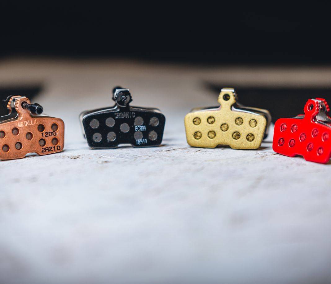

This is a good read and explains a few things. ( to me anyway)
I probably use the mid compound for pads (Magura Preformance) and they seem to preform well for the type of riding I face.
The ceramic compound seem interesting though.

I had magura ebike pads .
Didn't last 2 months before they were down to metal with the conditions here in Northern Ireland.
