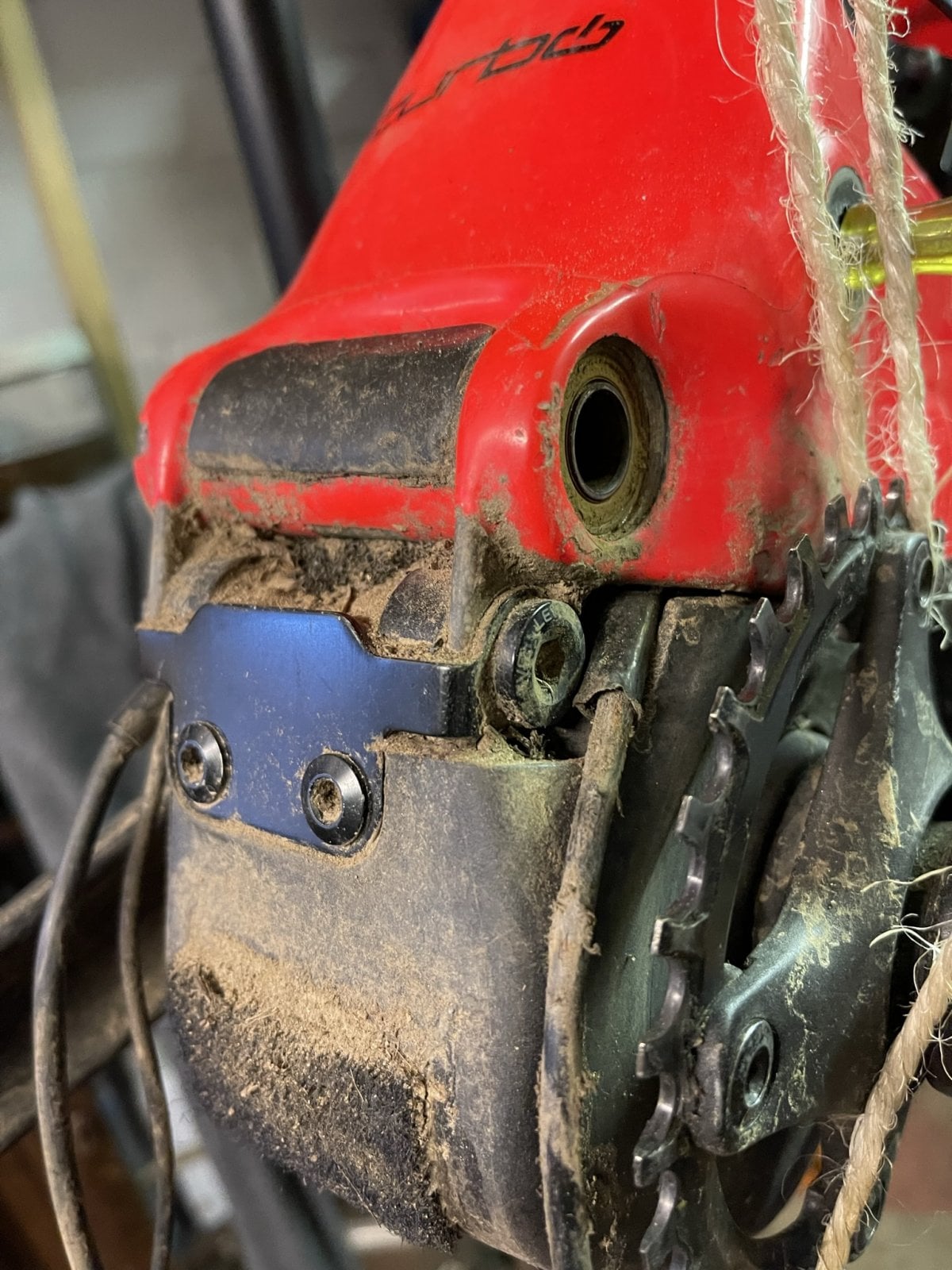

Hi guys,
Does anyone have any information on how to remove the two bearings that are located in the main frame where the lower rear suspension arm pivots?

The tool in the video is here :
I've recently used these tools to change all the frame bearings on my Rail, I did find I needed to tighten the nut more than I thought I would to get the tool to grip the inner race, first few attempts the tool just popped out when I tapped it. But these tools work well and are pretty inexpensive 👍
Thanks for the information, got it on order and I’ll give it a go
