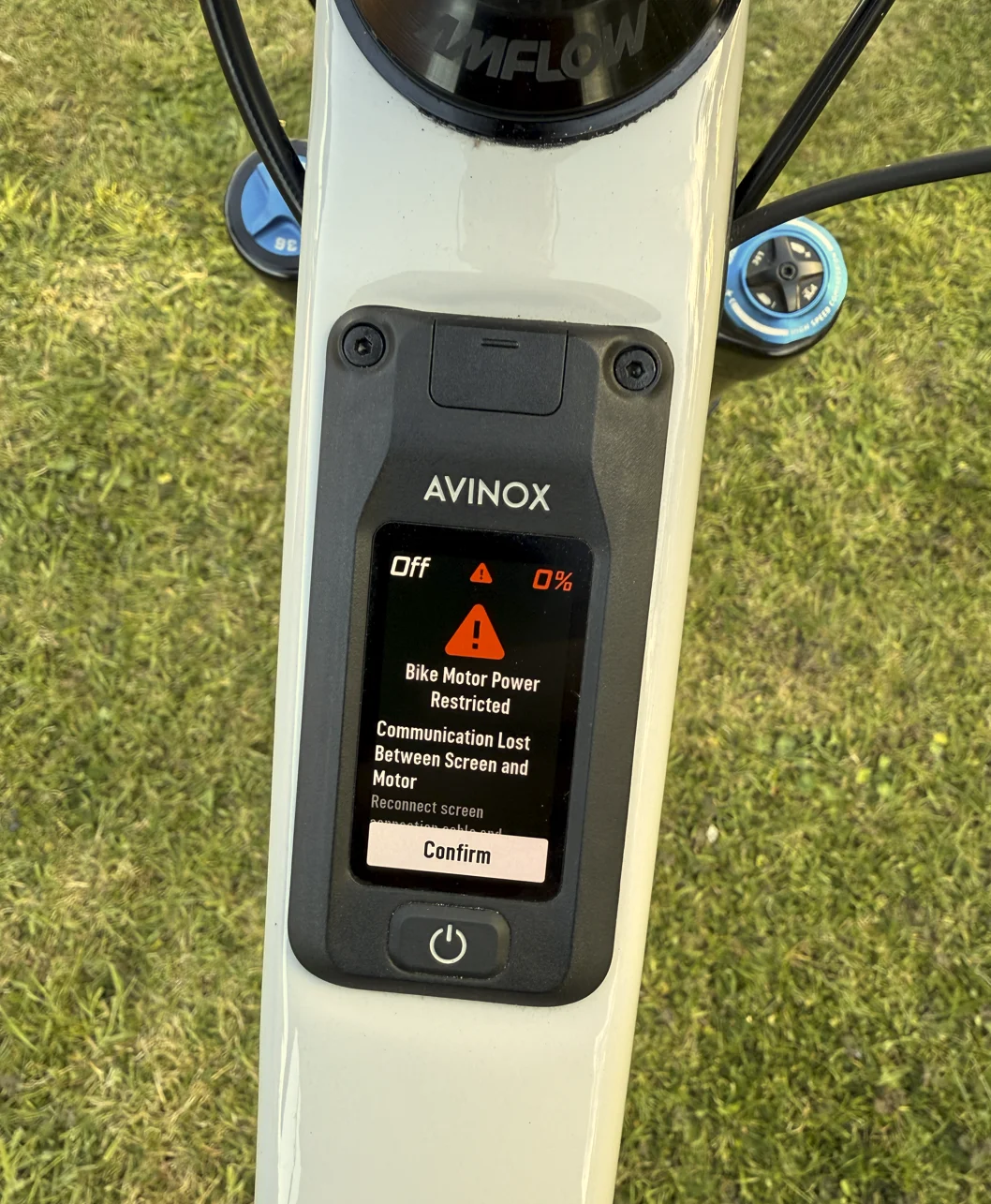

Note this is NOT related to this update, but wanted to point out i had one of the errors mentioned in here 6 weeks ago, first ride after applying an older update.
Happened mid ride and didn't feel like the power was restricted, just showed 0 battery but all else functioned until I got home - 'fixed' with the classic off and on trick, and never had it show again.
Was going to take it in to LBS but glad i didn't as it was clearly a bug or something.
That is exactly what happened to me!

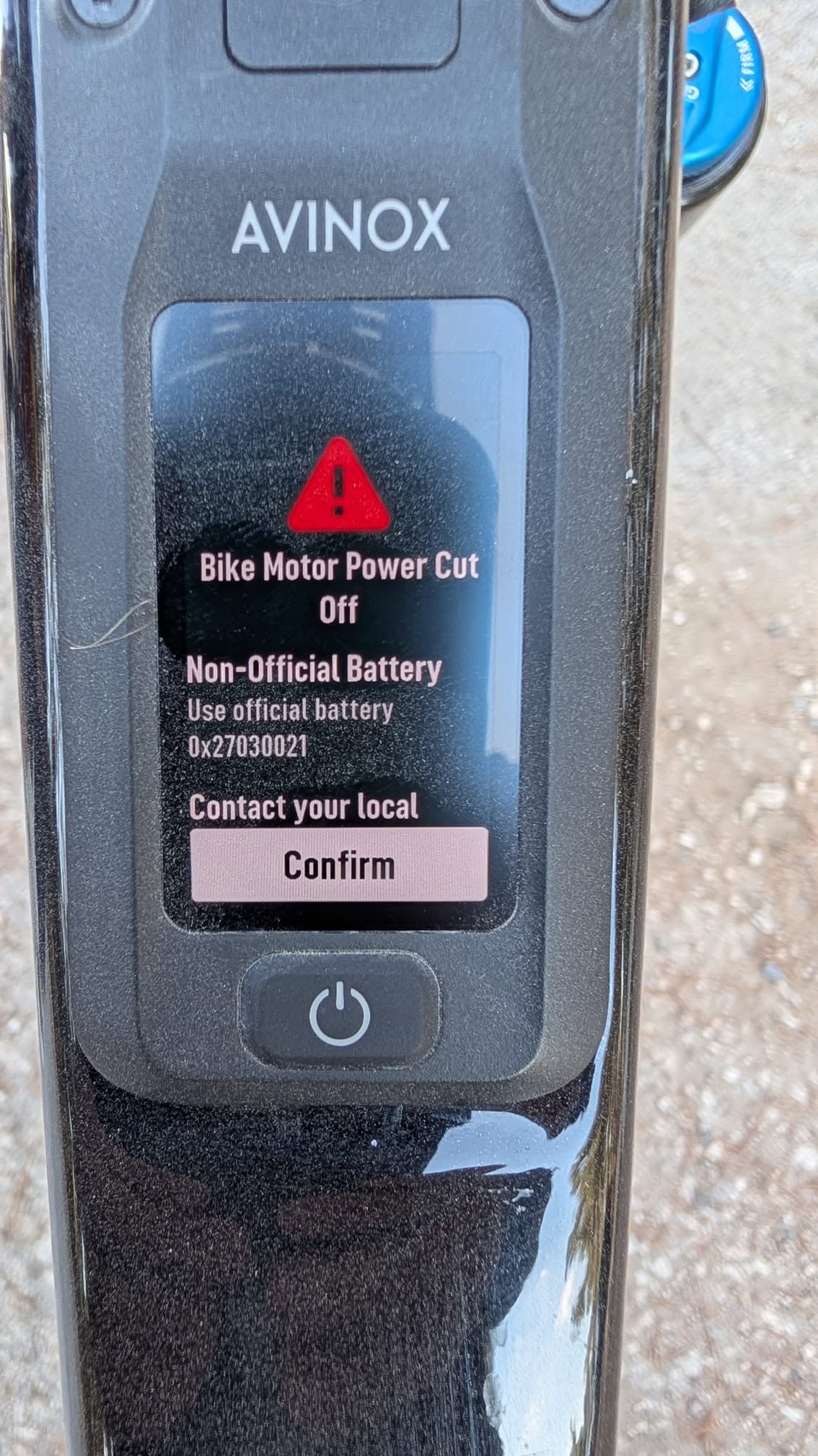

That 'lost communication/0 battery' issue was the very first error I got mid-rid after applying last firmware update. The difference is that in my case, after doing the classic 'off and on' trick to fix it, that is exactly when the 0x27030021 'unofficial battery' error started popping up randomly and completely locking the motor.
If I'd have to guess I'd assume they have some CAN communication error states which they are not handling well yet.

If this is clearly a software bug because they screwed up trying to block third-party extenders, why are they officially instructing us to check or replace the Y-cable? Replacing that cable means dropping the whole motor, which is a massive amount of unnecessary labor and a huge hassle for the dealers!
This is indeed a block on non-original batteries.

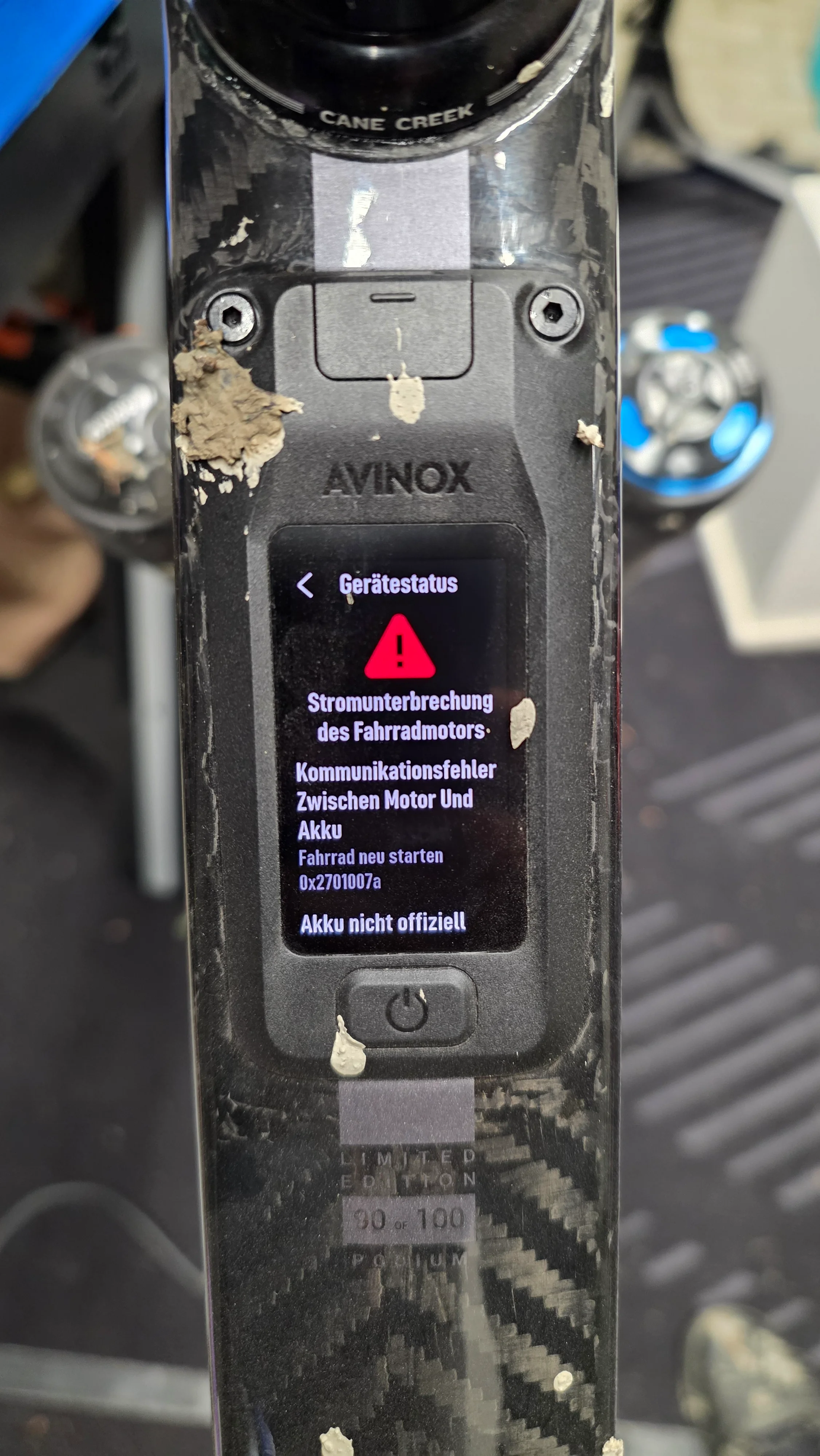

I have Rotwild R.EX 900. It has not original, but Rotwild battery (but officialy with Avinox support). After update (friday) I ended up with errors: "Communication Error Between Motor and Battery" and "Non-Official Bike Battery".
I immediately reported it to my Rotwild dealer and directly to Rotwild's customer support.. My Rotwild dealer already had information (email) from Rotwild since Friday morning. Unfortunately, he didn't read it before I had already performed the update.
Rotwild has been working with Avinox on the repair since Friday.
Yesterday I received an email from Rotwild saying that Avinox had been resolved the problem.
Yesterday Avinox released a new version of the app AVINOX app 1.4.1(6178), but only available via direct link for manual instalation. Probably it is a version only for install update for Rotwild without checking the battery charge (standard update is not possible with battery under 10% and with this error comunication with battery it shows 0% battery).

Thanks for sharing this! It actually explains a lot about what DJI was trying to do with this update, but our case with the Amflow bikes is slightly different.
Since we are using the original Avinox batteries, we don't get that permanent 0% battery bug. Our bikes do read the battery charge correctly most of the time, but the system just randomly triggers the "Non-Official Battery" error and cuts the power. Because our screens still show the actual battery percentage, we wouldn't even need that special 1.4.1 app to bypass the 10% update restriction. We can update normally through the standard app.
The real problem for us Amflow owners is that there is simply no firmware fix available for us yet. The latest firmware update with the supposed "bug fixes" did absolutely nothing to solve this issue for us. It seems DJI quickly patched the communication protocol for the Rotwild batteries, but they left their own Amflow bikes dealing with this over-sensitive CAN bus error. We are still stuck waiting for a real firmware fix!

I just read an article from a Czech e-bike blog that absolutely nails this whole mess and completely confirms our CAN bus timeout theories.
Honestly, the timing of this is so hilariously bad that I’m starting to think an undercover Bosch engineer infiltrated DJI’s software team just to hit the "deploy update" button right before Eurobike. 😂
Here is a quick summary of what the guy points out:
  • The Eurobike PR Nightmare: Eurobike literally starts today. DJI was planning a massive show to crown the Avinox as the new king of e-MTBs. Instead, their software department is probably sweating blood right now trying to patch this so their demo bikes don't throw a 0x27030021 error in front of all the journalists.
  • The Amflow Irony: He points out the ultimate joke: Amflow is DJI's own in-house baby, yet we are the ones getting screwed the most. The author actually rides a Crussis bike with an Avinox motor, did the update, and is riding with zero errors. DJI basically crippled their own flagship fleet while third-party frames are fine.
  • "Drone Paranoia" Confirmed: He confirms exactly what we suspected. DJI brought their strict drone DRM into the e-bike world to block third-party extenders. They made the CAN bus communication so hypersensitive that any micro-delay—whether on boot-up or taking a hit on the trail—makes the system panic and cut the power. A premium motor paralyzed by overzealous code.
  • Voodoo Workarounds: He lists the same temporary fixes we’ve been doing: unpairing/repairing the app to force a new server authorization, and the "5-minute rule" (leaving the bike off for 5 mins to completely drain the capacitors and force a clean BMS handshake on the next boot).
