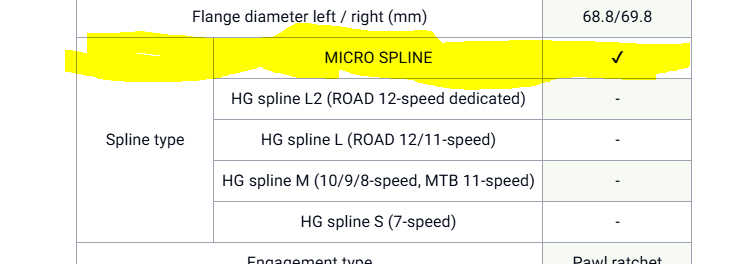

its the stock hub wich came with the bike.. sorry its a M20 not M10... i think its this one.... FH-MT410

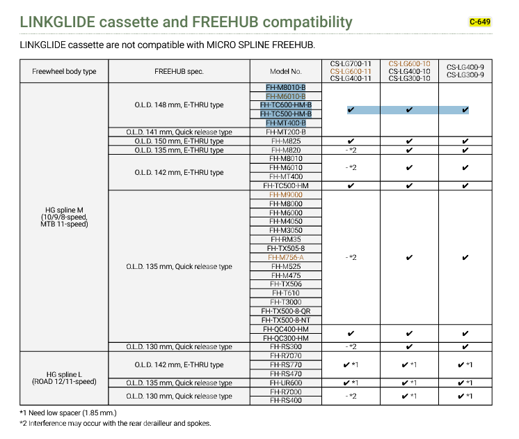

does the rear wheel has to be asymmetric or symetric? i never build a wheel before :D i need to get this done by a shop but at least i want to know what hub i need... what hub would i need for the CS-LG700-11 cassette?
I'd say it's the FH-MT410-B, which is the boost version. The Freehub has normal pawls like most freehubs. So you should be able to get a HG version. But Shimano say it's only for Microspline, so you cannot get it from Shimano.
thx, where else could i get it from ? sounds more like a mod then ...
do u know what kind hub i need to get? FH-TC600-HM-B would this one work? i checked the shimano list but im not sure...

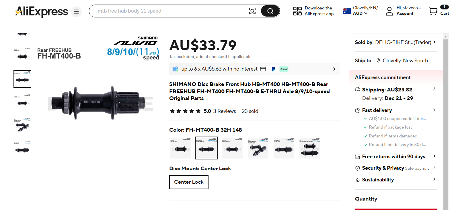

what hub are u using?

I bought the MT400-B from Aliexpress. Delivered it was about AUD$60, which is probably about 40 Euro.
The hub is working nicely, so I might get a DT Swiss hub in the future. But there is no rush. From my experience the Shimano hubs work well. But the Cone nuts do come loose, and you have to tighten them, or the wheel wobbles.
The DT Swiss hub has sealed roller bearing and doesn't have this maintenance annoyance.
thx, i checked the shimano compatibitility list and there are a few hubs wich work...
after googling for a while for each hub.. i found a complete wheel... would this work also ?
the hub is compatible i just not sure about the asymmetric part...
also found this but im not sure about the hub... Shimano list says fh-tc500-HM-boost...
the link is without HM? do u know what the HM stands for? is it the same?
