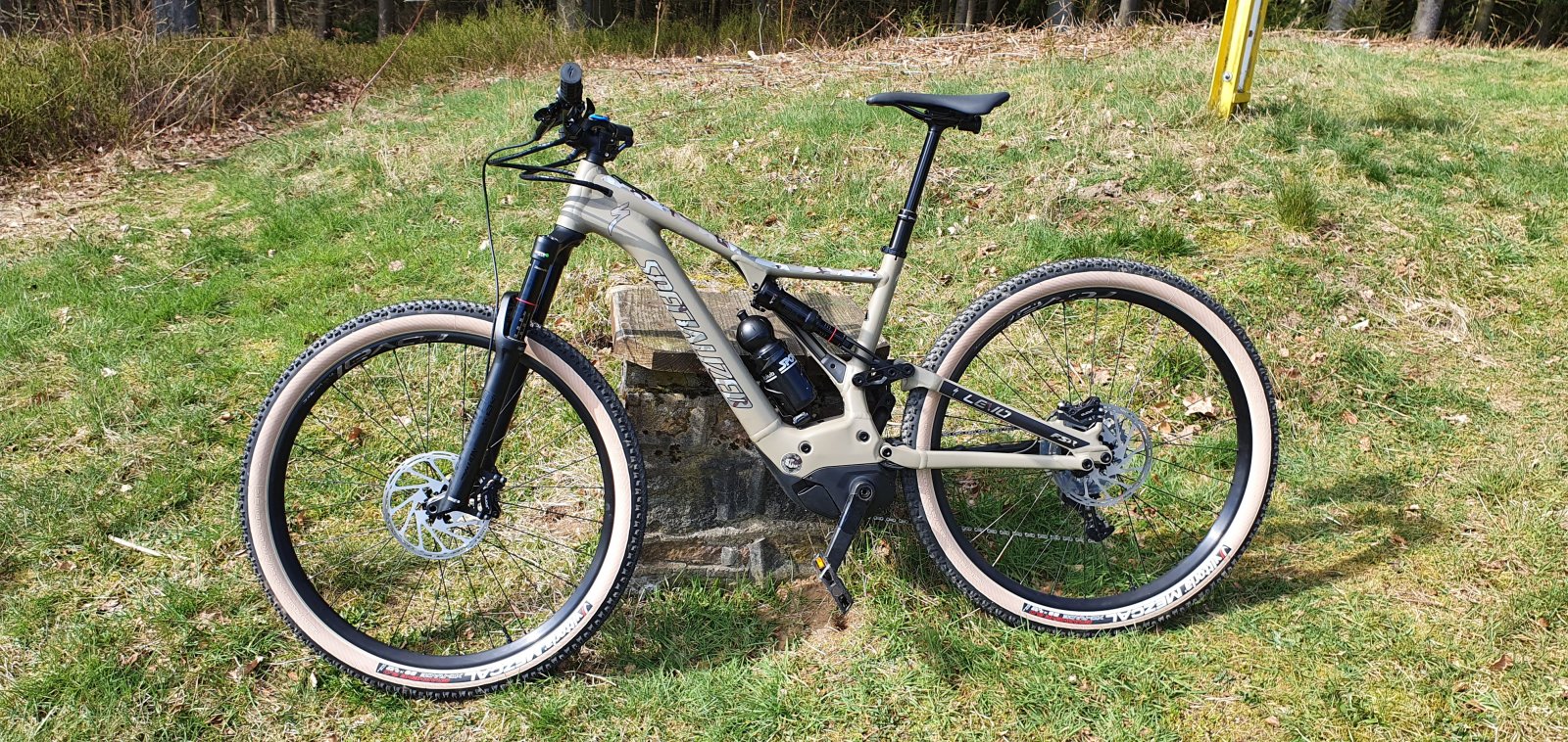

Yes, tan is quite flashy, but I love the Look. And the speed is just wow.

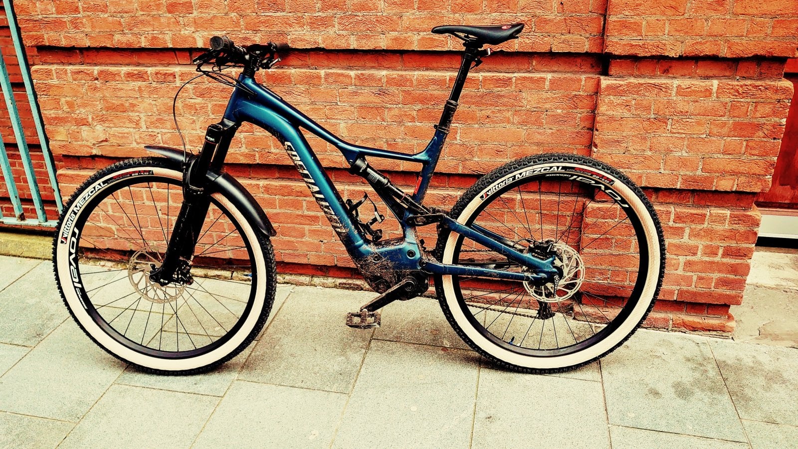

Nice, I fitted some Mezcals the other day too :)
I was tempted by the tan ones, but went with the 2.6 wide instead

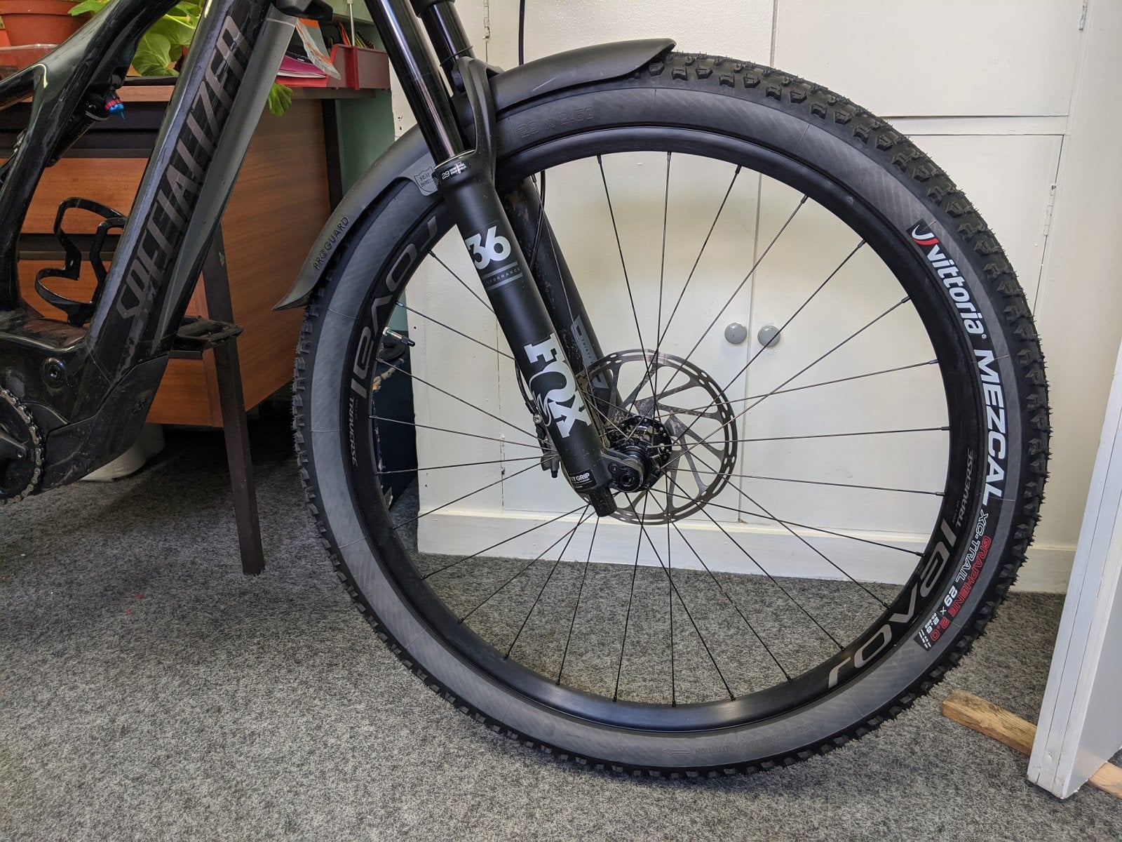

How wide do these tyres come up when fitted to your rim? Also how wide is your rim? I have 2.6" (65mm) Conti's on a 40mm internal rim which come out at just over 2.6" at 72mm. I have some nice full fenders and plan to use these on some newer 30mm internal rims.

Hi Jake,
2.578" or 65.50mm according to a cheap digital caliper
My rims are 30mm inner width

Thanks for the fast reply! Okay so that puts them at spot on 2.6" so I think I'll grab a set of these! Out of interest - I'm the puncture king (even when using tubeless!) but how have you found these in terms of how often you get punctures or any issues with them sealing punctures? I ride about 10k miles a year so opted for heavy tyres but they're a bit of a slog...

I have some tannus armour in the rear and haven't had a puncture yet, but I also haven't been riding off road at all for a while now, only commuting to work and back.
I've unwittingly ridden over broken glass a couple of times though with no issues.

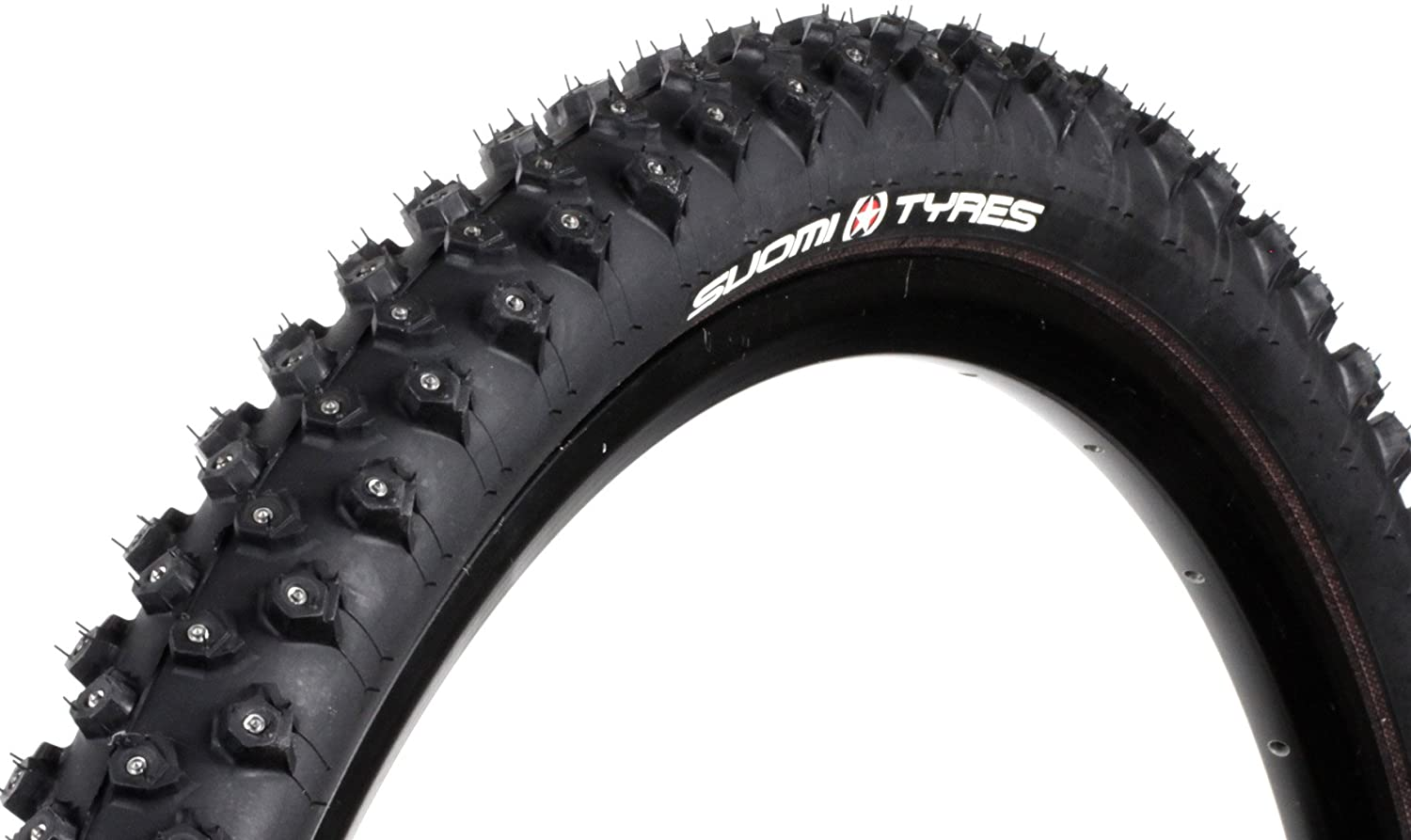

I use these Suomi tyres wxc 300 tyres for winter commuting in Finland
Yeah. Our winters don't compare to yours. those tyres wouldn't work too well riding into the city over here.
Thanks for the inspiration guys, I went ahead and ordered a pair of tan Mezcals and a spare set of wheels. I wasn't' happy with the cornering of the stock tyres, the back end was 'lively'' when accelerating out of a corner. Now, it's nice to be able to have tarmac wheels to swap over to.

Yes. I've just got back from a 2 hour blast around the city on road / tarmac. Far better and the difference in rolling resistance is really noticeable and they're very quiet.
I couldn't locate the 2.6" version so went for the 2.25".
