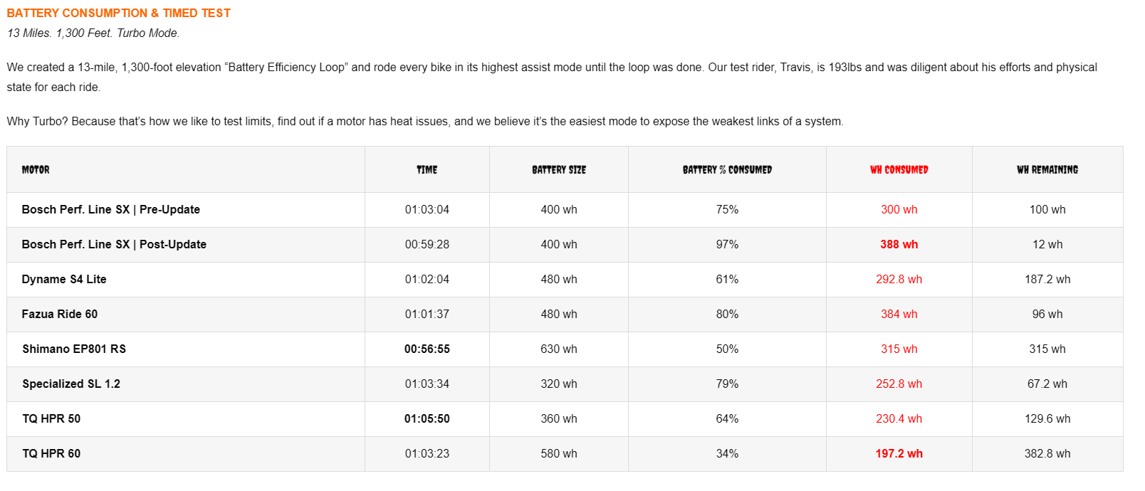

Looks like another publication has done a comparison of time and battery used
TL;DR Bosch SX post update is a battery hog but the most powerful..def need a range extender for this one
Fazua is not that far behind
What's odd to me is that the Pre update Bosch with the theoretical 600W of power is slower than bikes with less peak wattage

The article reports that the update allows peak power to be attained at a cadence of 96, and I've noticed some increase in assistance at a lower cadence after installing the update.
