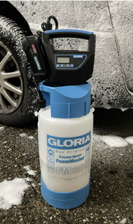

When the bike picked to much mud I do it and use the car stuff I have:
ValetPRO snow foam
Gloria FM30 and because I am to lazy for pumping by hand with a compressor
Sprays easy and exactly, makes mud easy to drip off or spray away by mild pressure garden hose. Compatible with mechanics and brakes. After this the bikes gets a small lube & protection service.

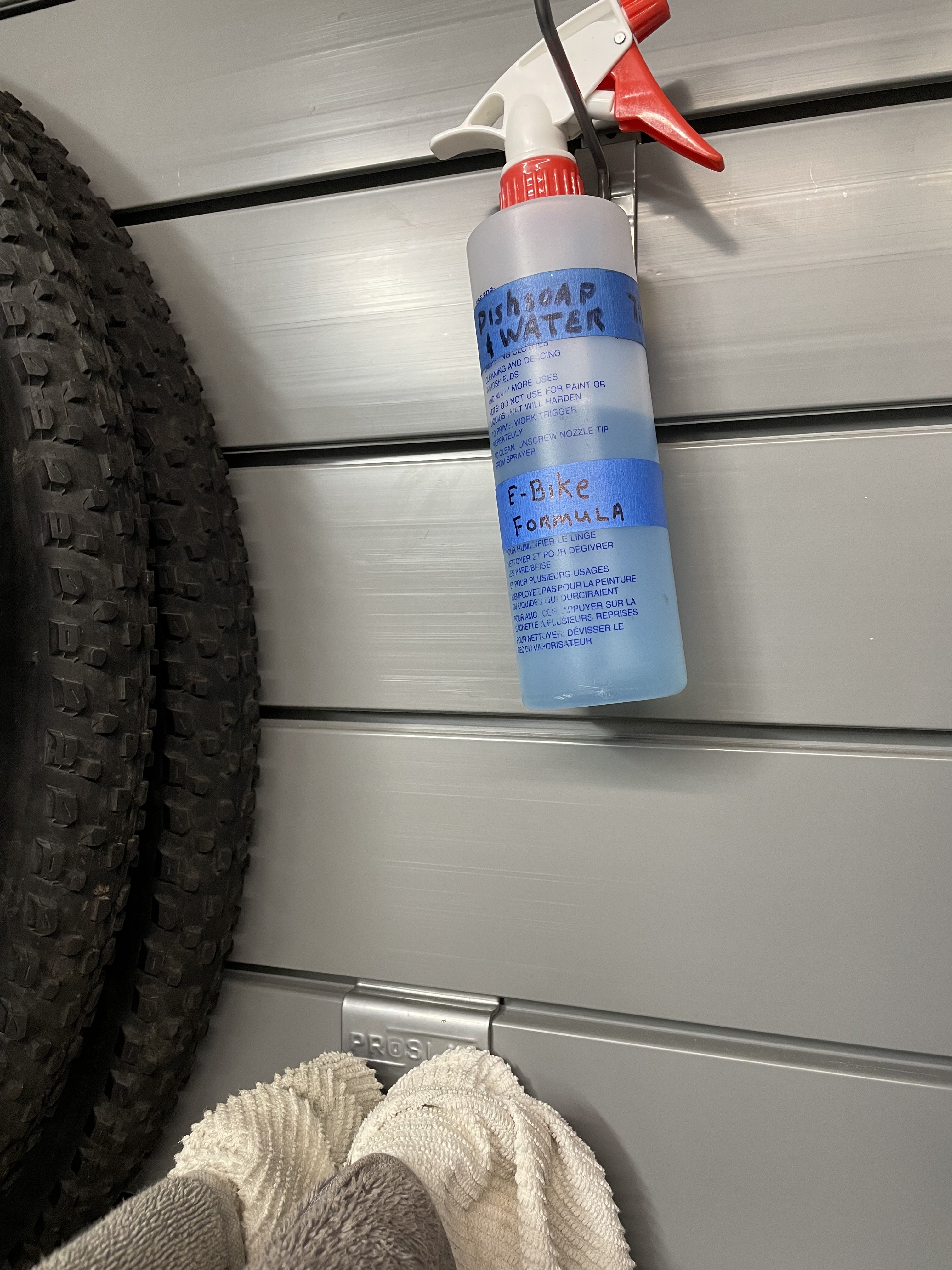

A bucket with luke warm water, soap and some toilet brush is all you need to keep the bike clean. The tyres would be the only part I’d jetwash… after taking the wheels off the frame.

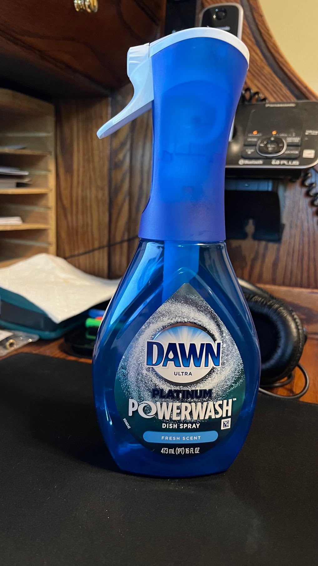

Dawn came out with a new product called Powerwash. It's much more effective compared to regular Dawn and the sprayer works so well it's almost like foam.

yup! most definitely! also snow foaming isn't as high pressure as your pressure washer due to the foaming action and heavier "foam" by the time it actually hits the surface. stick your hand directly next to the nozzle with your snow foam vs straight water and you'll see.

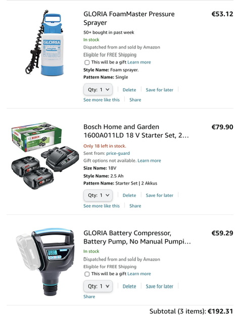

What's the price of smth like this? With the compressor.
I foam mine from time to time, I use a foam cannon from chemical guys that hooks up to the garden hose. I’ll foam it, let it sit then rinse it off with the hydro shot.
Quick look at the big river sites - Gloria has also smaller and larger sprayers.
Good thing on the battery is that it is a joint system for various brand machineries.
I figured it would be over 150 eur, in that price range I can get a portable battery powered pressure washer, like the worx hydroshot or ryobi or kaercher.
Because this one still delivers around 3 bars of pressure, which is not that much I my opinion.
This is to make and apply foam only. Not to spray dirt off. A regular Gloria sprayer - the yellow ones with a different nozzle - is used by some guys to clean the bike when back from tour prior loading into car.
However, I have that equipmemt for my car. Use it for the MTB but also for outside shades (raffstores) on the windows or garden furmiture when pretty dirty. 👍🙂
