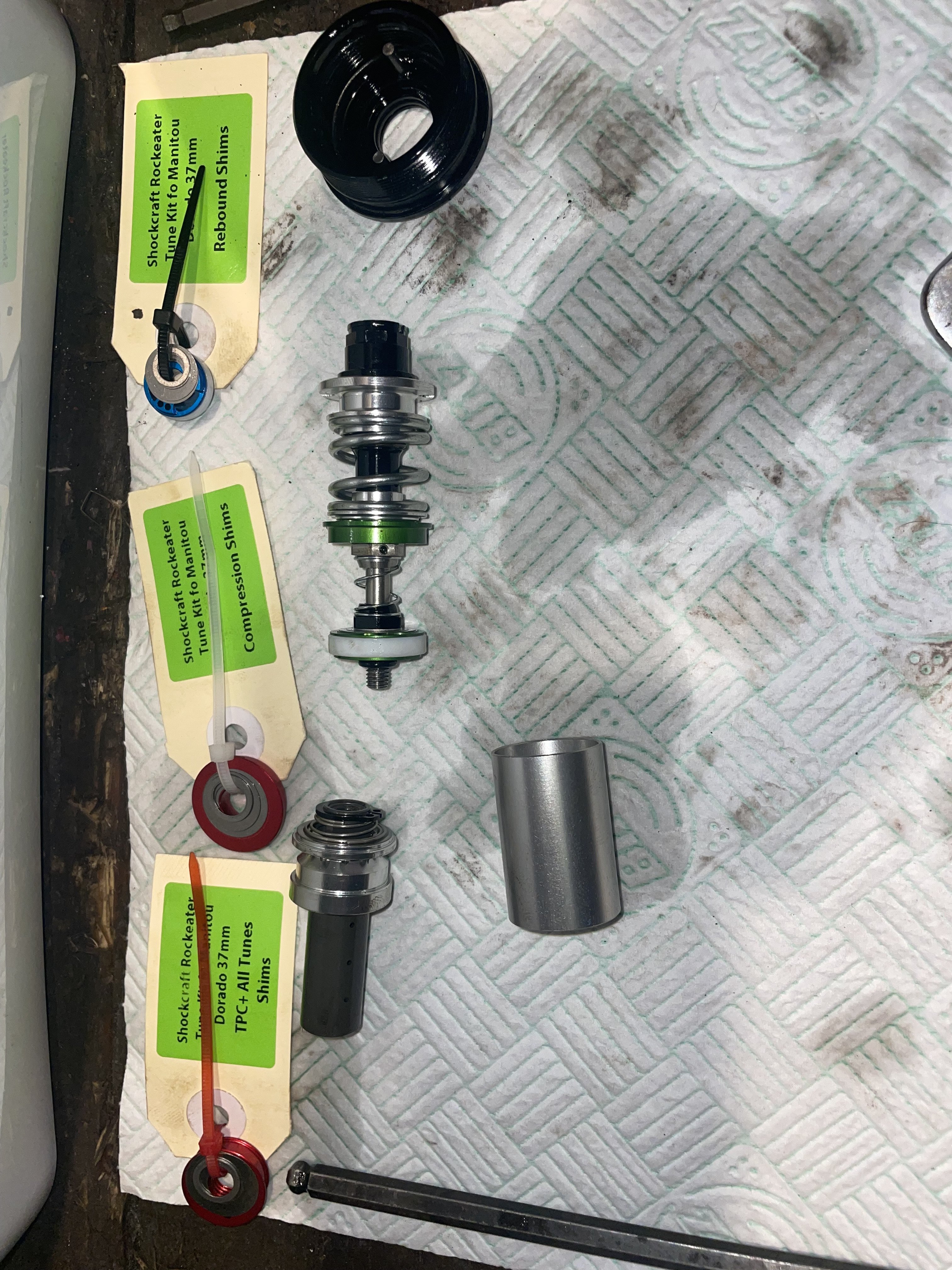

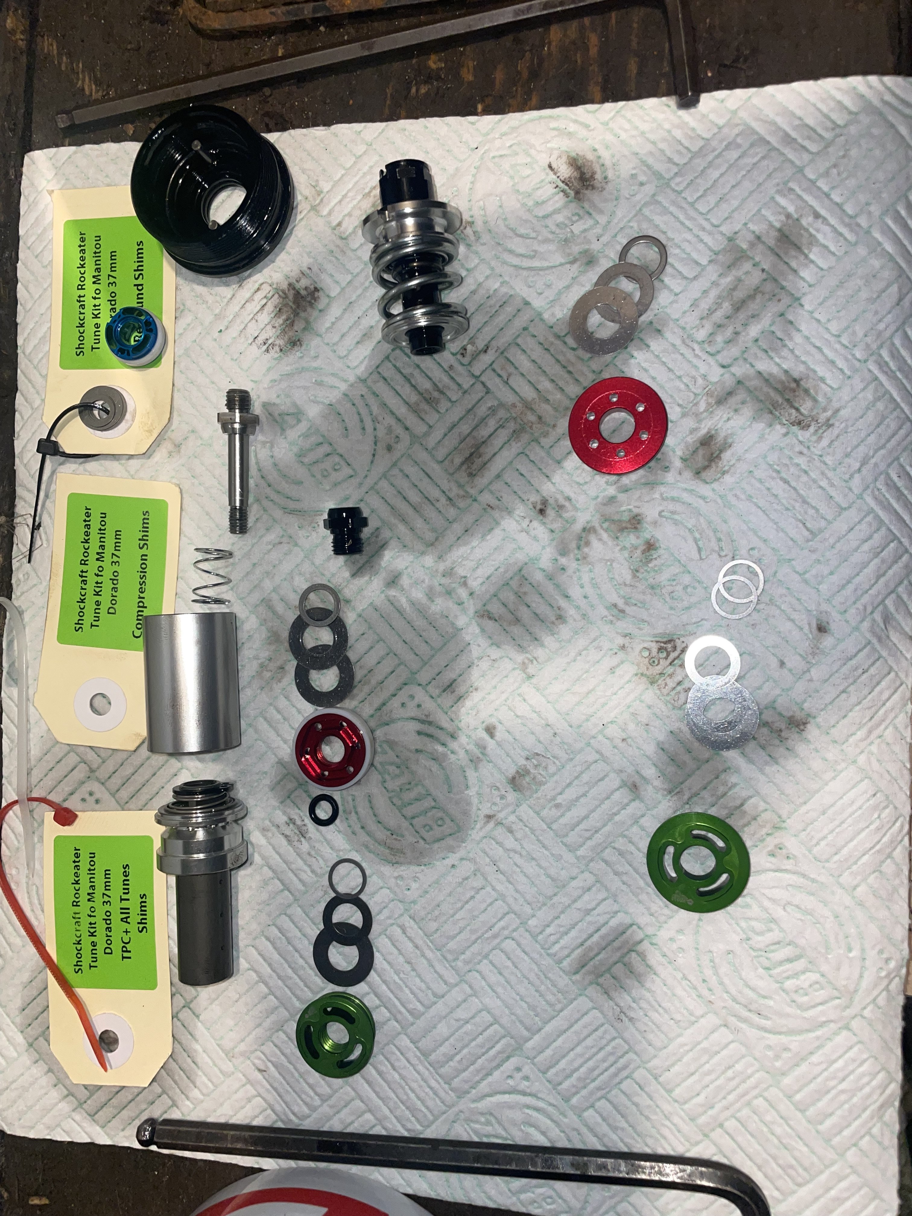

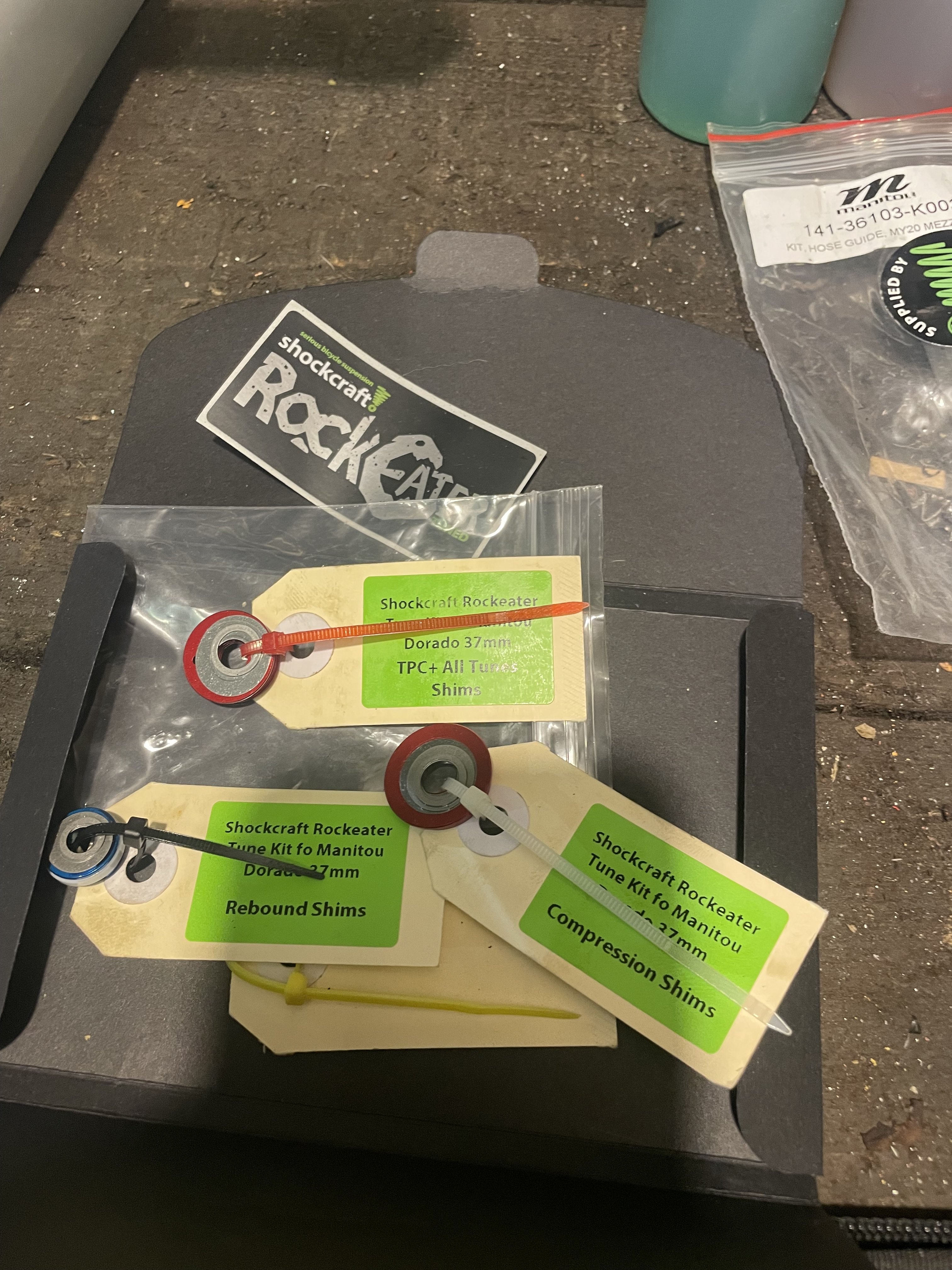

Lastnight I fitted Shockcraft’s rockeater tune (pistons and shim kit) to the dorado damper, easy work with good instructions so tonight fill & bleed with oils and test ride Friday 😎
The ‘old’ original Manitou compression pistons and shims back into the ‘stock’ stash👍

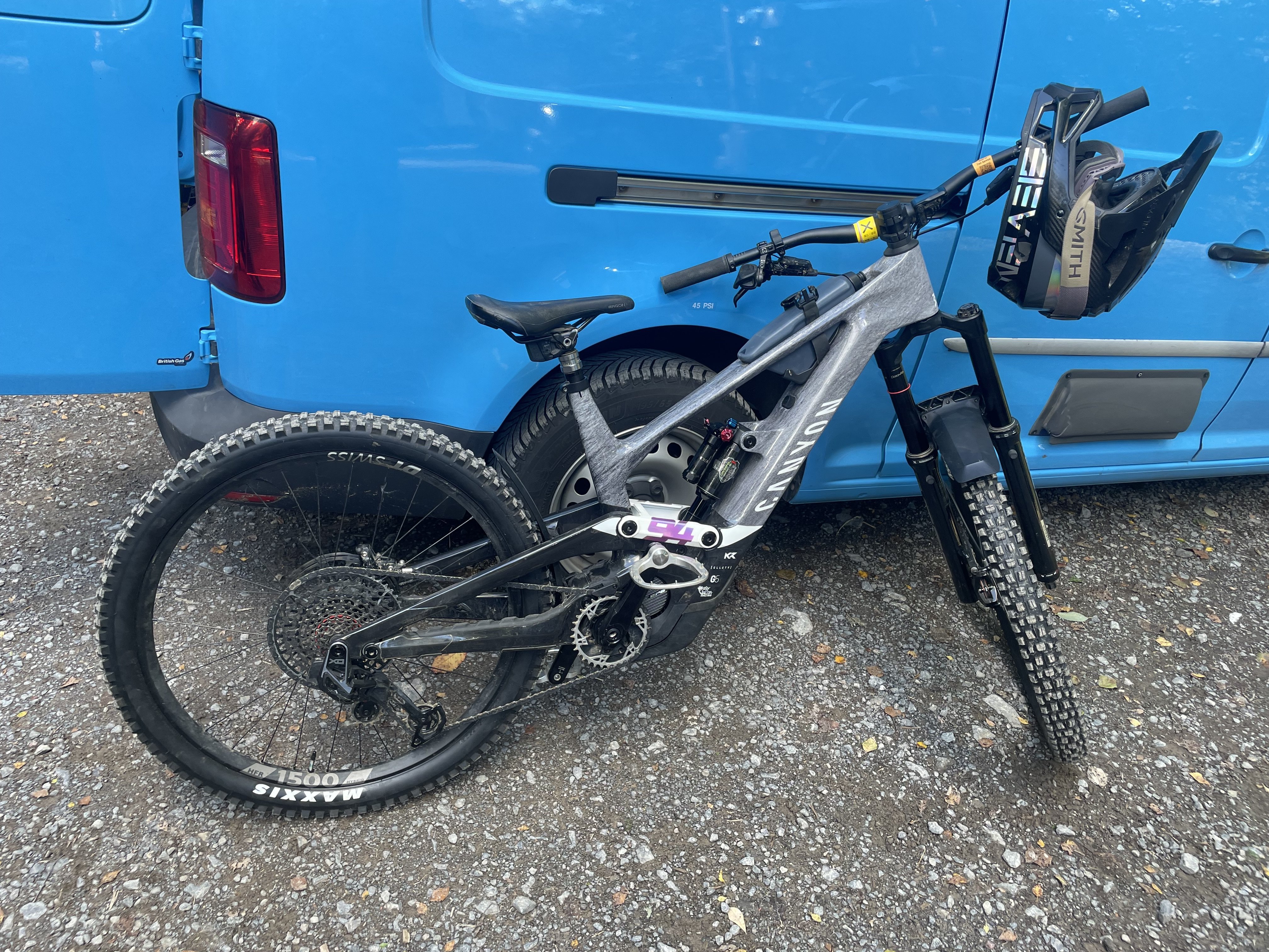

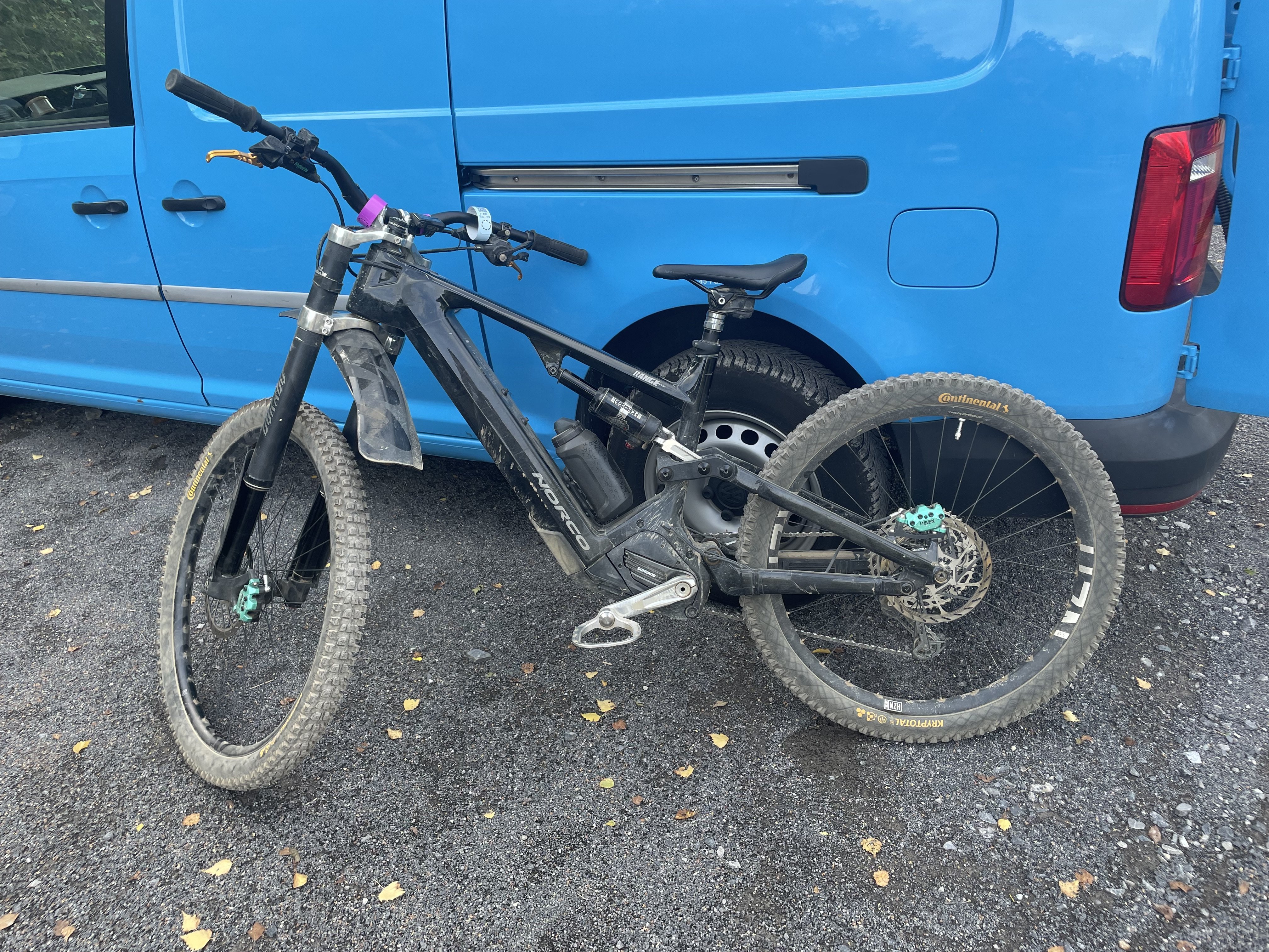

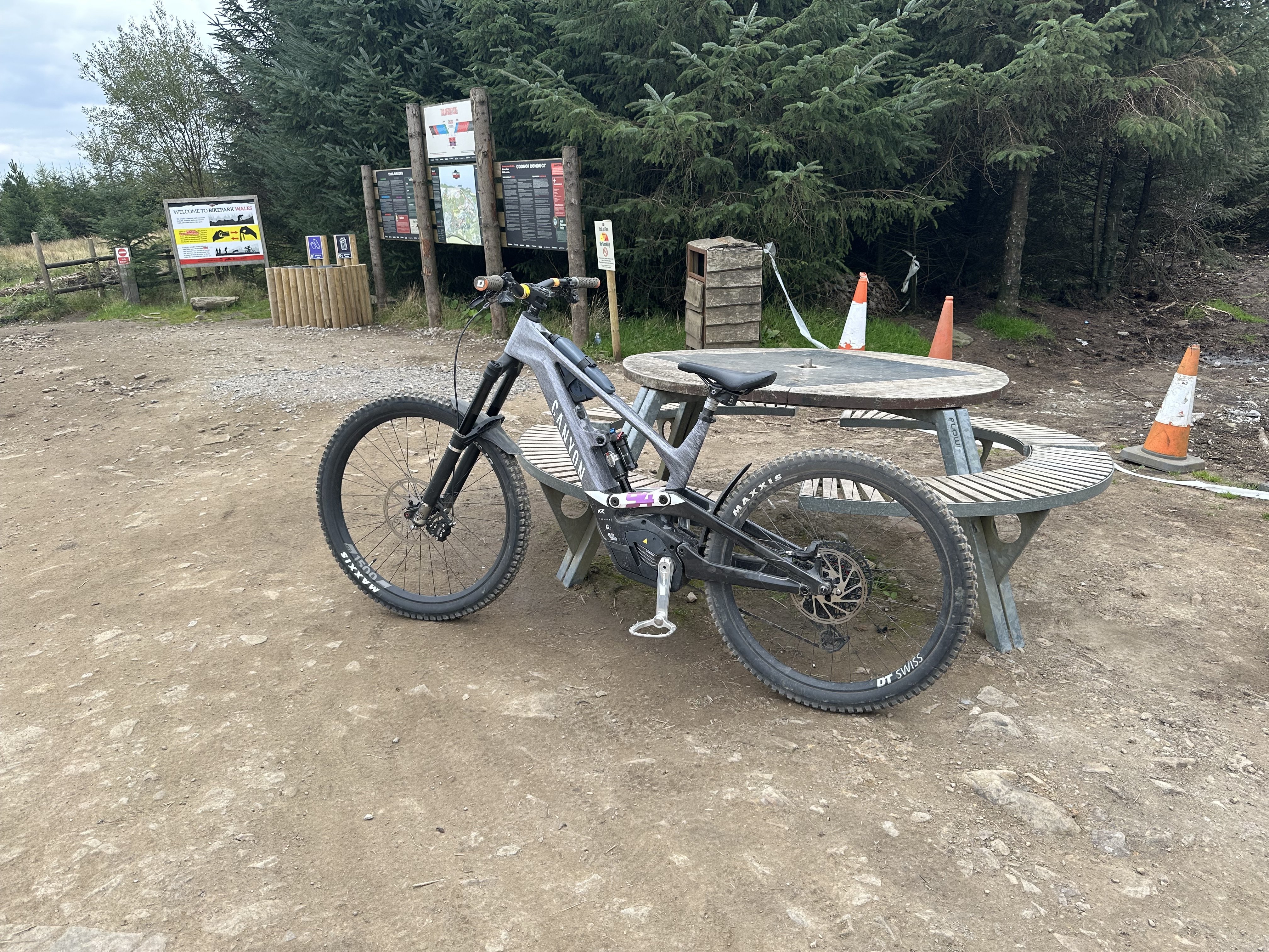

Yesterday I swapped the RS Zeb ultimate charger3 (with buttercups) forks on my Canyon Torque:ON for a recently rebuilt Mezzer pro in matching 180mm travel.
When I rebuilt the Mezzer I removed one shim from the compression stack (as suggested across the internet) so I had to start from scratch with damper settings & this took a few tries but I’m guessing a little more fettling will follow 😎
But I might have bought another example of Manitou’s Dorado Pro forks so they could make their way onto the Canyon 🤡
