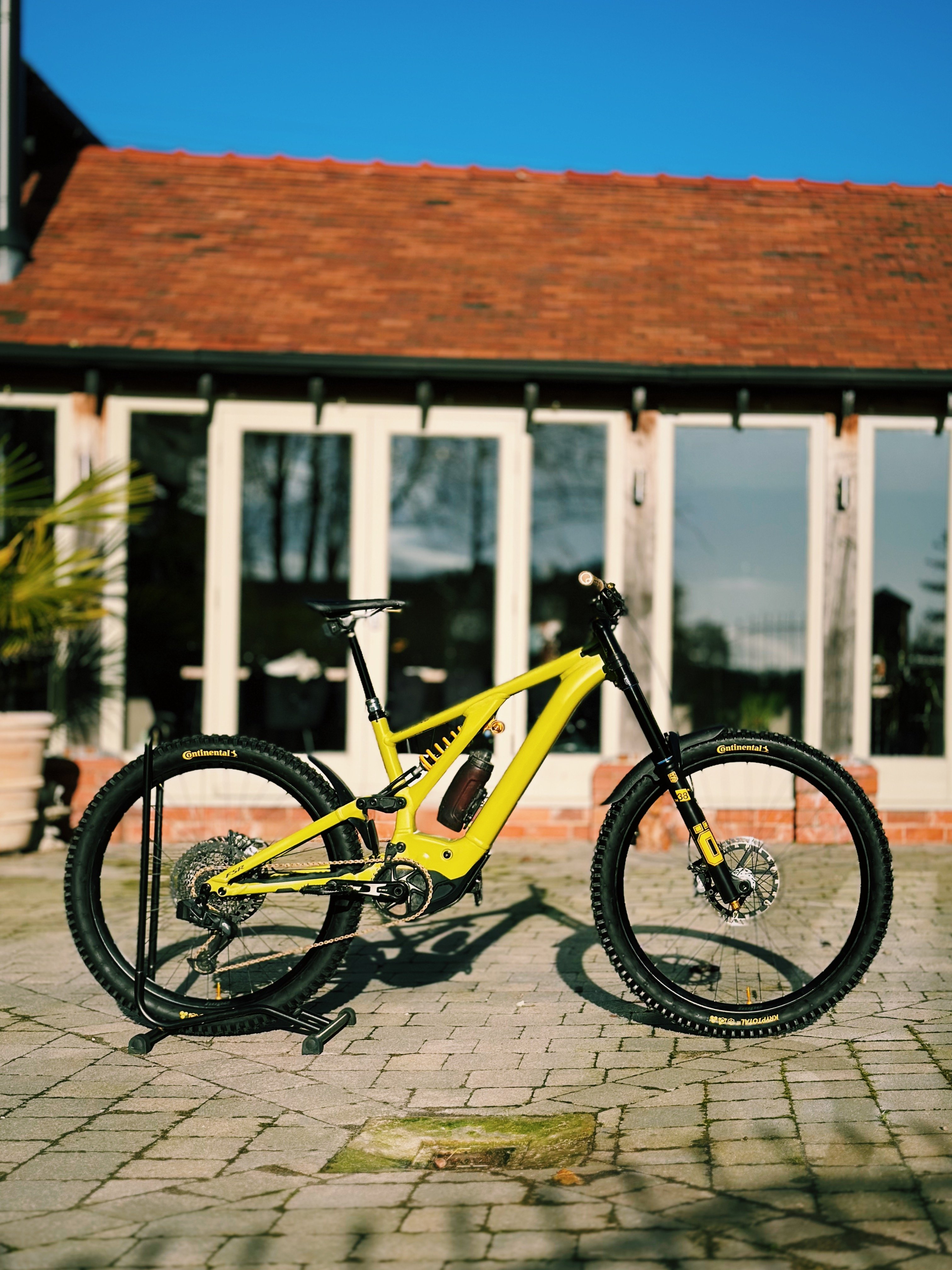

So I moved from Maxxis Assegai / DHR II DD with Cushcore and have been running Kryptotal in DH spec F & R with no Cushcore for over a week.
The setup is c. 500g lighter.
Im not sure if it’s a placebo effect but it feels like it spins easier/quicker but the most noticeable feeling was the turn in. Much more responsive and felt like it can lean in easier than before. Really enjoying it and no punctures / rim dings on the rocks.
