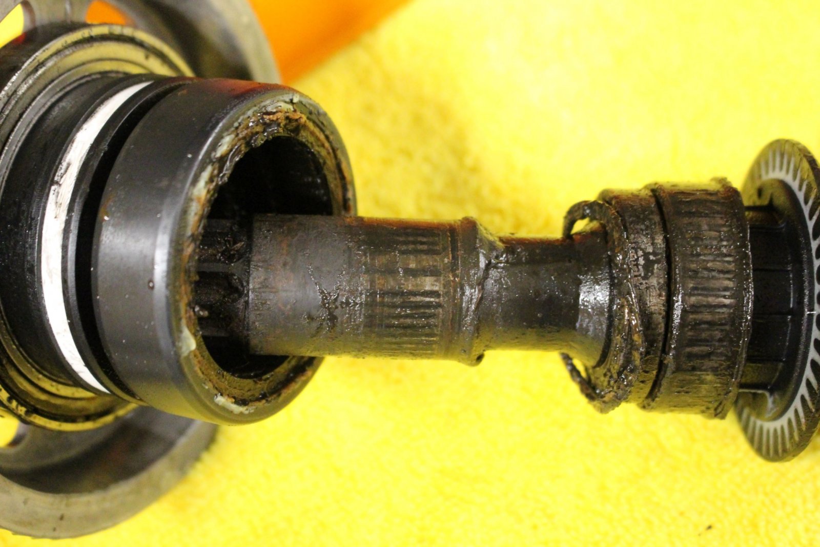

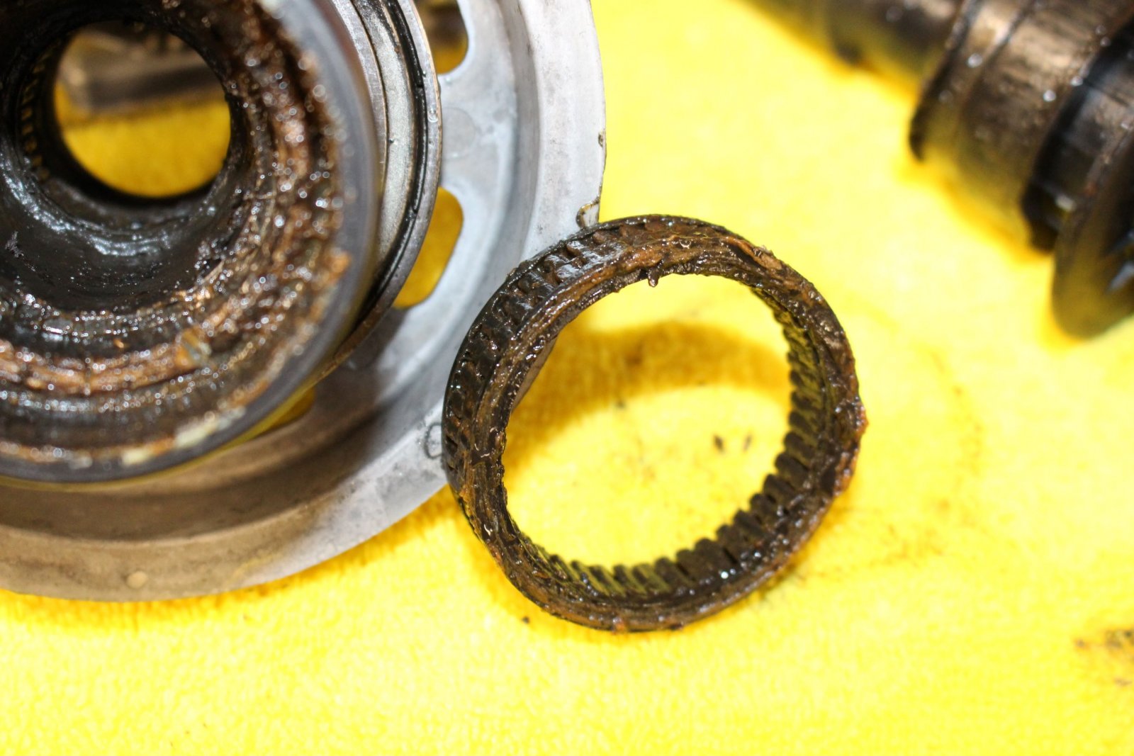

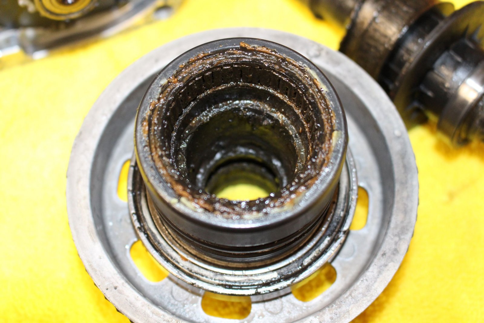

Water ingress getting past the motor crankshaft bearing seals and eventually damaging the bearings. One significant cause of this was pressure washing so that should be avoided.
I am fairly certain bearing seals are primarily designed to keep the grease in and not so much to keep water ingress out unless the bearings have a triple lip seal. It is my understanding that there are no triple lip sealed bearings on the Brose crankshaft. It is also my understanding that there are no proper water seals on the crankshaft of the Brose motor which is why water gets in so easily and destroys the bearings. I understand that @Bearing Man can and does fit an additional water seal when he refurbishes a motor. The big question I have is why hasn’t Brose fitted a water seal on any of their 'replacement' motors? These motors have been out there in the wild for over 4 years now……. Perhaps this is another question @Specialized Rider Care could answer for us?
Other causes may be submersion or general bearing wear which in turn will render the seal inneffective but I would suspect inappropriate washing has been the main culprit.
Submersion will do it for sure as there are NO water seals on the Brose crankshaft so the motor is more or less an open door if the motor is submerged over the motor cranks.

The photos below are a Brose motor that has never been pressure washed or submerged just good old Welsh weather :eek:

1. Deliver a fix for water ingress issue on both sides of the crank shaft.
My suggestion is for Specialized to engage with the 3rd party motor repairers in the UK like @Bearing Man for example. I am sure he would be more than happy to show Specialized first hand the issue regarding how and where the water is getting in. I am sure @Bearing Man could also suggest possible improvements on water sealing the current engines and where water seals could be possibly fitted. Armed with this detailed information, photo’s etc... Specialized could then meet with Brose and come up with a plan to resolve this water ingress issue. It would be good for Specialized to encourage Brose to start releasing service kits and parts to 3rd party repairers rather than existing customers being forced down the route of purchasing a brand new engine without water seals only to have it fail again in 12 to 18 months or sooner.
