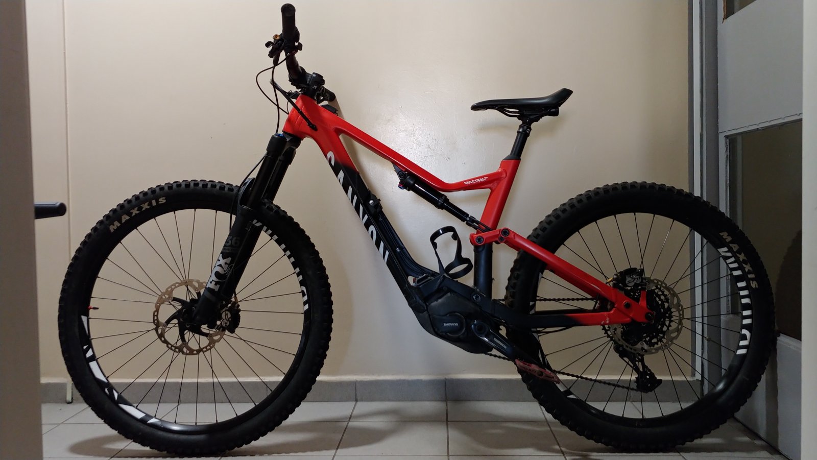

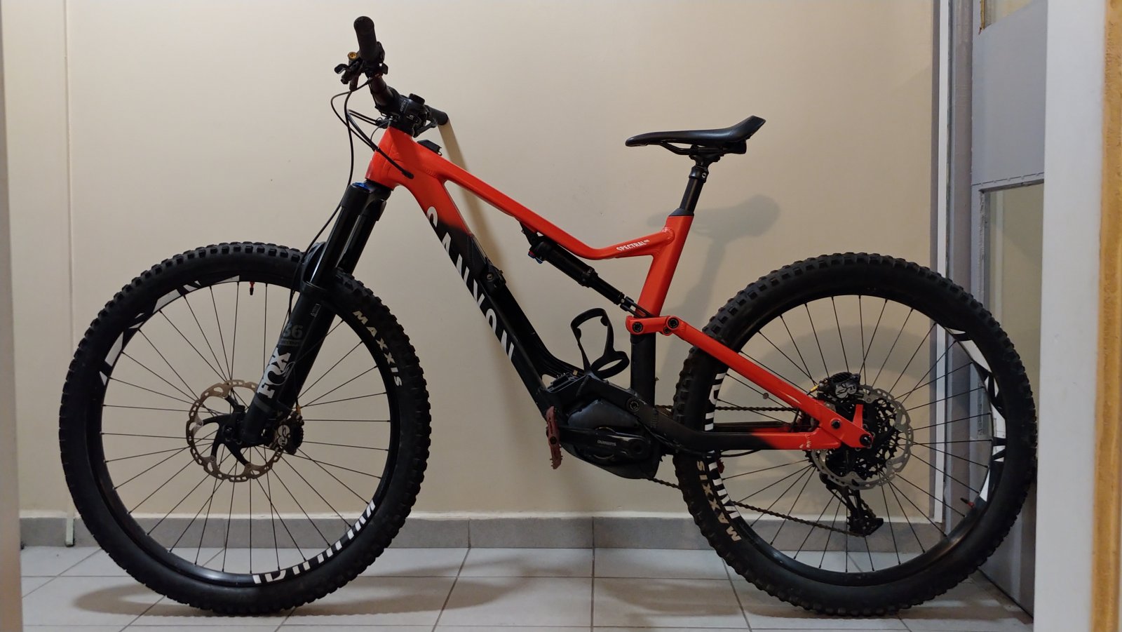

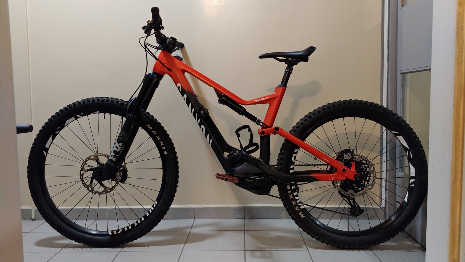

Hello,
I want to share with you with my latest tune for my Spectral:ON AL. This is model year 2020 (frame 2019). I have installed Works Components -2degree angle set. For those who wants to buy this set - this is: "2.0 Degree EC44-ZS56 Angle Headset - Tapered Steerer Tube - Headtube Length: SET 3 110-119mm"
So after installation I have decided to put rear end in upper position in order to get a bit more of Bottom Bracket and seat tube steeper for uphill comfort.
After this setup my geo changed to: Head angle 65,6; seat angle 74,6; Bottom Bracket -26mm. Seems very solid for enduro riding up and down hill and I hope I won't shred my support on rocks so often as it was with original setup.
3 fotos: 1. Original, 2. Angle set -2deg 3. Angle set -2deg rear end in upper position
