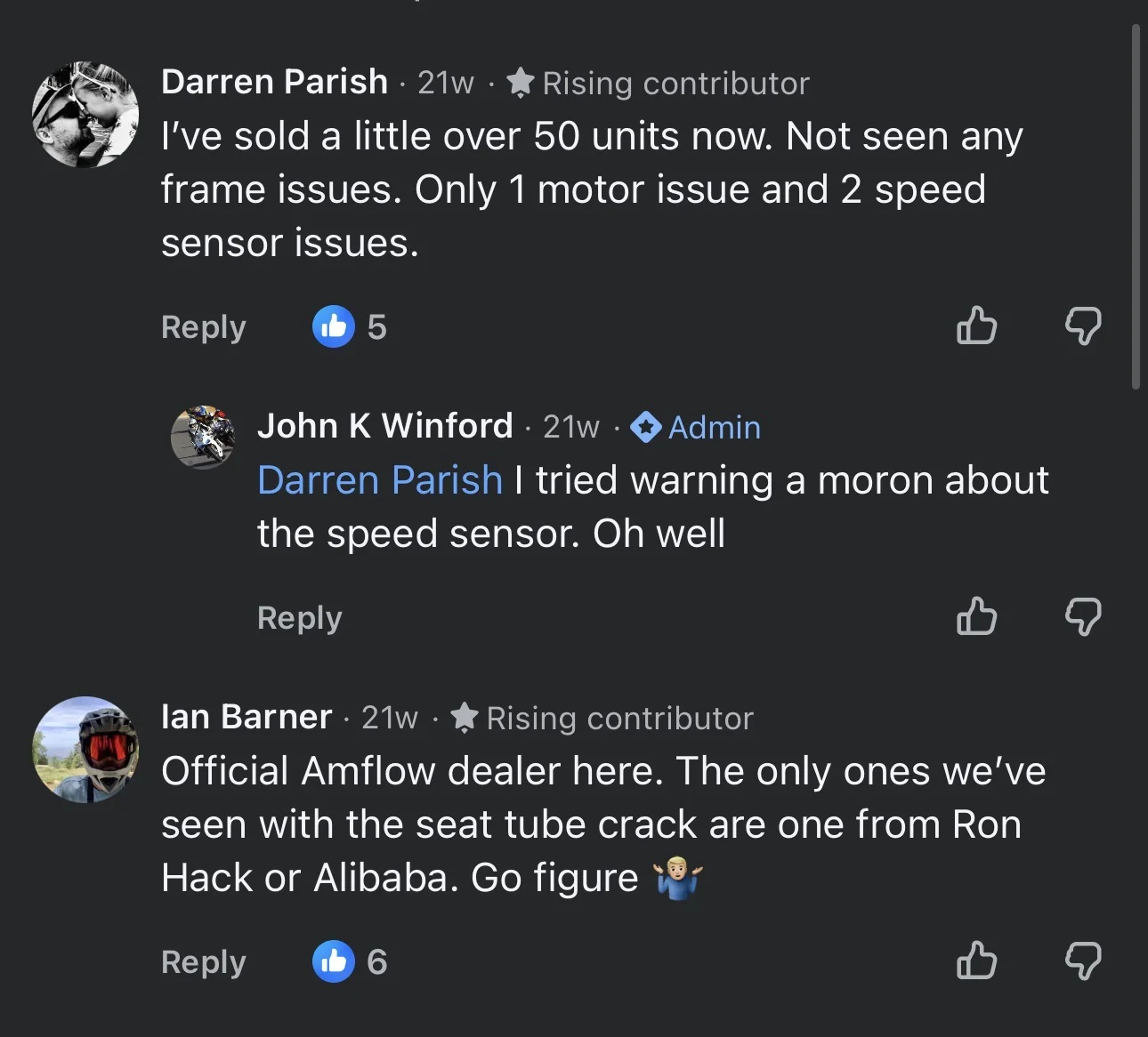

I also own an Amflow PL, and seeing several reports of cracks in the same seat tube area on almost new late-2025 / 2026 bikes is very worrying. This is not a minor cosmetic defect — it is a serious potential safety issue on a high-end carbon e-MTB.

From fb amflow groups. There’s for sure something different in the alibaba bikes. Many reports of this. Not saying all, but high majority.
