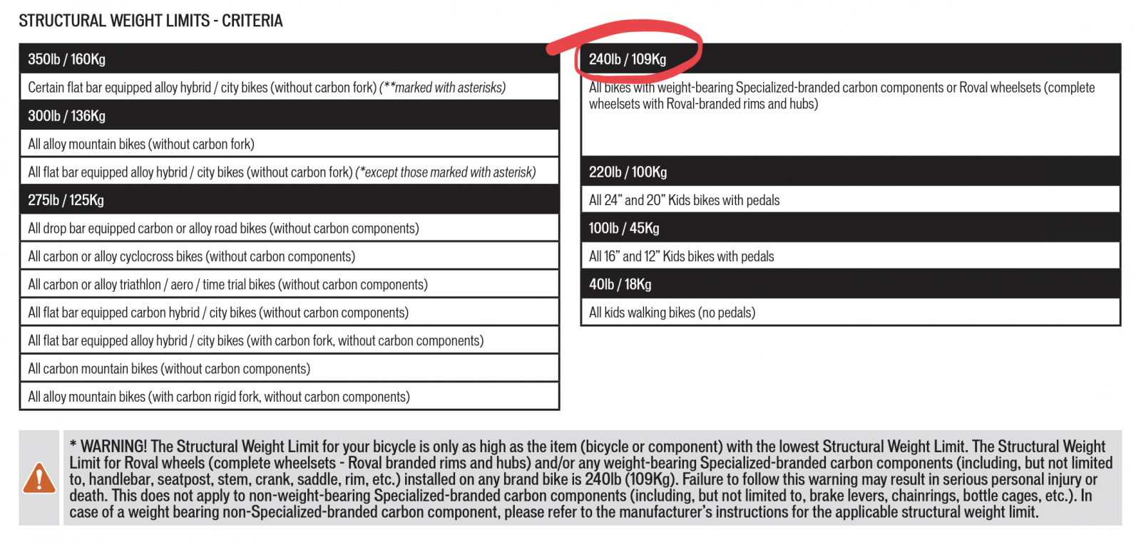

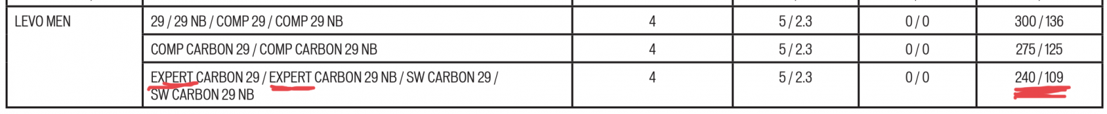

I am 125kg and very worried about maxing out psi on the rear shock. Also, I think I want a 700Wh battery so that basically limits my choice to the Specialized Turbo Levo Expert (which has a weight limit of only 109kg!) I have included soms screenshots from the Specialized Weight Limit PDF. Any thoughts on these concerns? Any insight would be much appreciated.

I weigh about the same and I run my alloy Levo Comp at 250psi on the rear, nowhere near the limit and probably too much sag, but never bottom out. Likewise the forks are at 110 psi instead of the recommended 140 or so, no issues,but I am just trail riding with relatively small jumps and step downs to deal with. As for the 700wh battery, maybe wait to see if any alloy 2020 models come with one?

Have you spoken to Specialized? I ask as when I querying shock travel on my Levo, I was told the rear shock can “easily take 20 stone”... may be worth a discussion but I suspect you’ll be fine.
