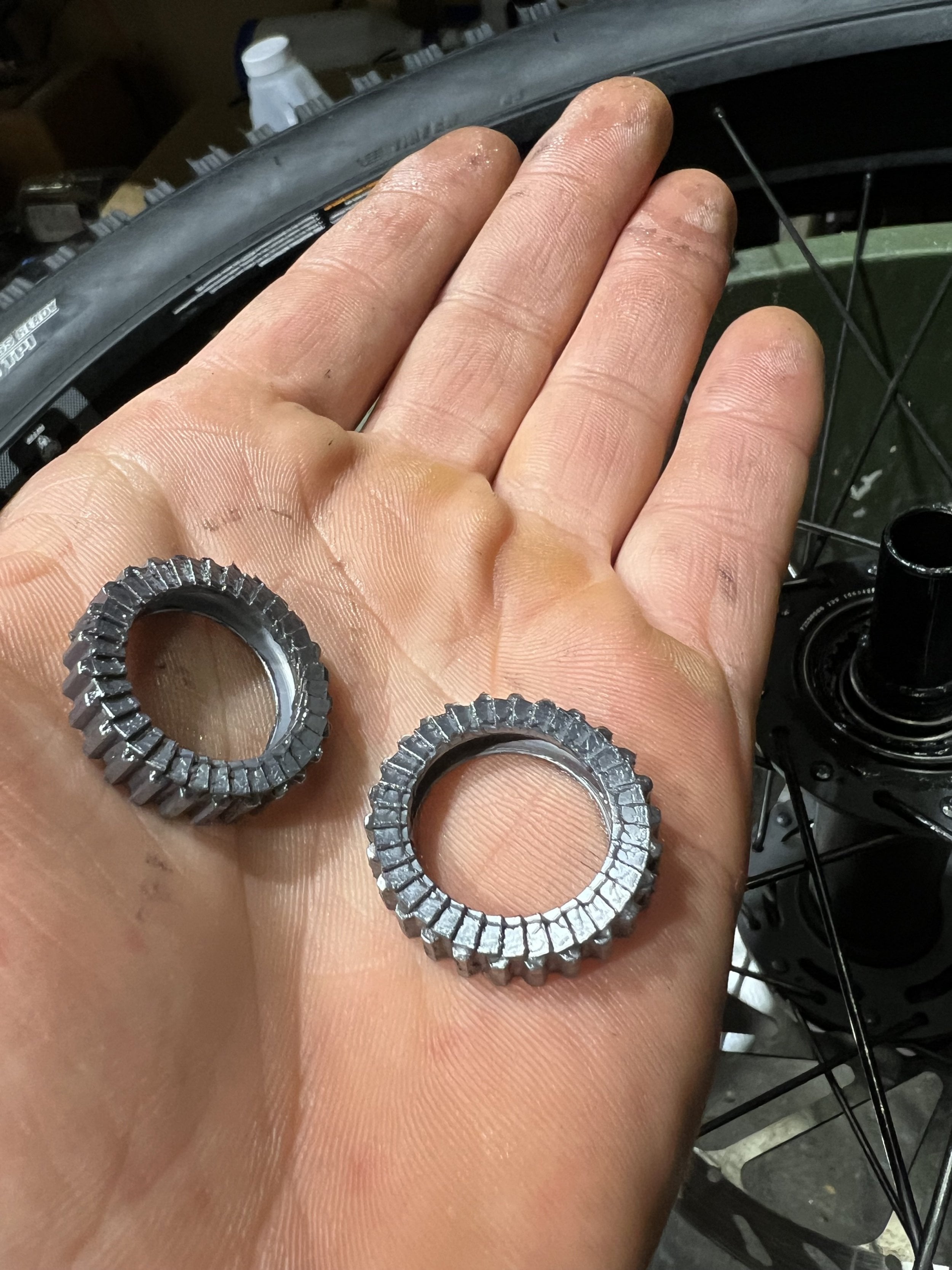

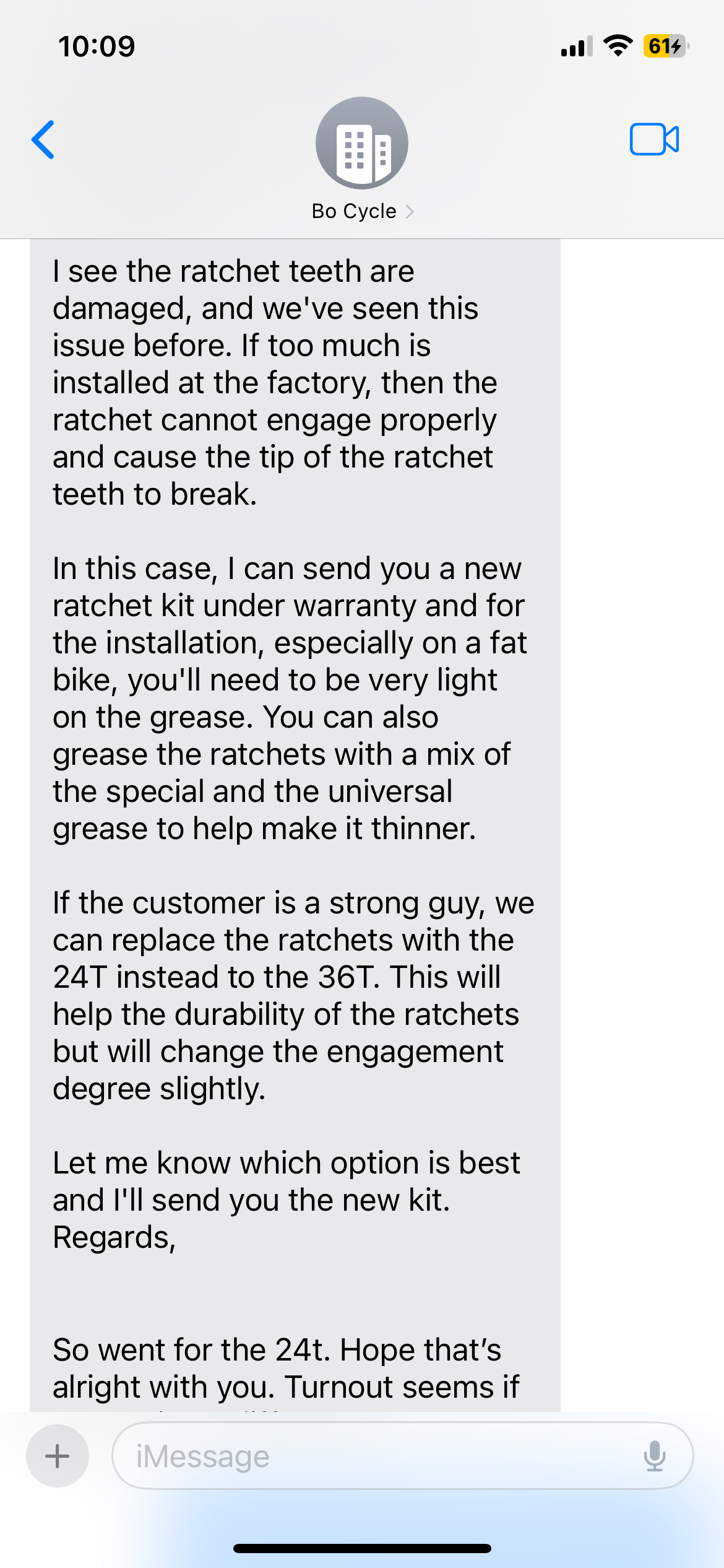

I blew a dt-350 swiss hub on RM blizzard powerplay in 130km. Which is stock on bike. But found out later the problem was the grease was to thick and to much for winter use. The gears were not engaging all the way and just stripped the tips. You might want check how much grease you have in hubs. These are the stripped gears. Actually do not look bad at all just the tips gone. I do agree that fatbike are way harder on hubs. My other gasgas e-bke has 2300km and no hub problems. I do ride off trail lots under high load conditions.
Not sure if this is the stock grease but it should not be that. DT Swiss should comes and use a peculiar red/pink grease. It is expensive but work really well. It also require to not put too much of it.
From stock my guess is that is should not be the case but I also saw people putting the spring in the wrong direction which could just damage everything from spring to ratchet.
I also do agree on the 24T, on my end I usually do the opposite for more engagement or a different sound.
Bike was brand new whatever grease that was in there was stock. Been on two big rides so far pushing bike hard and hub is holding up so far. I went with 24t.
