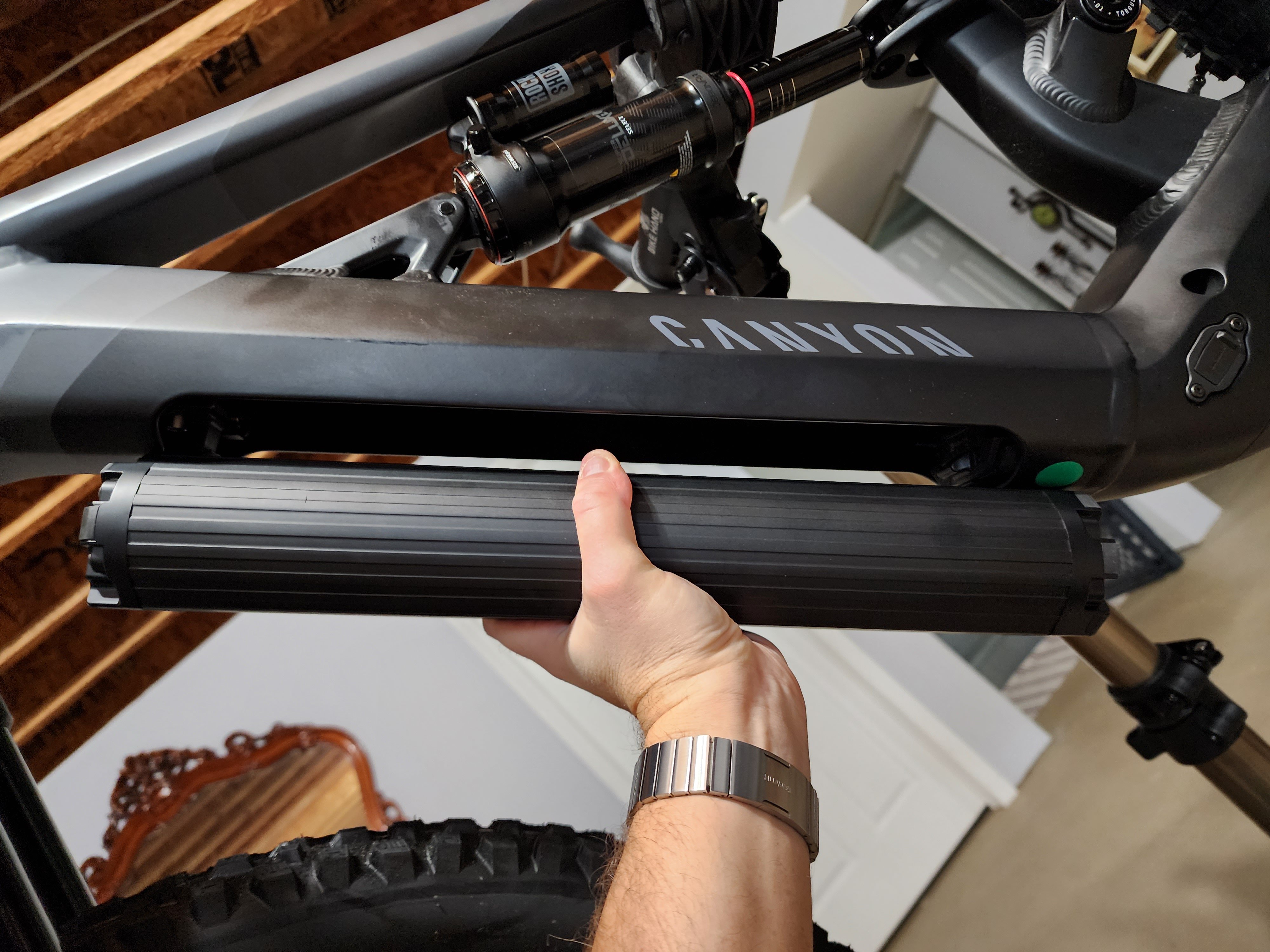

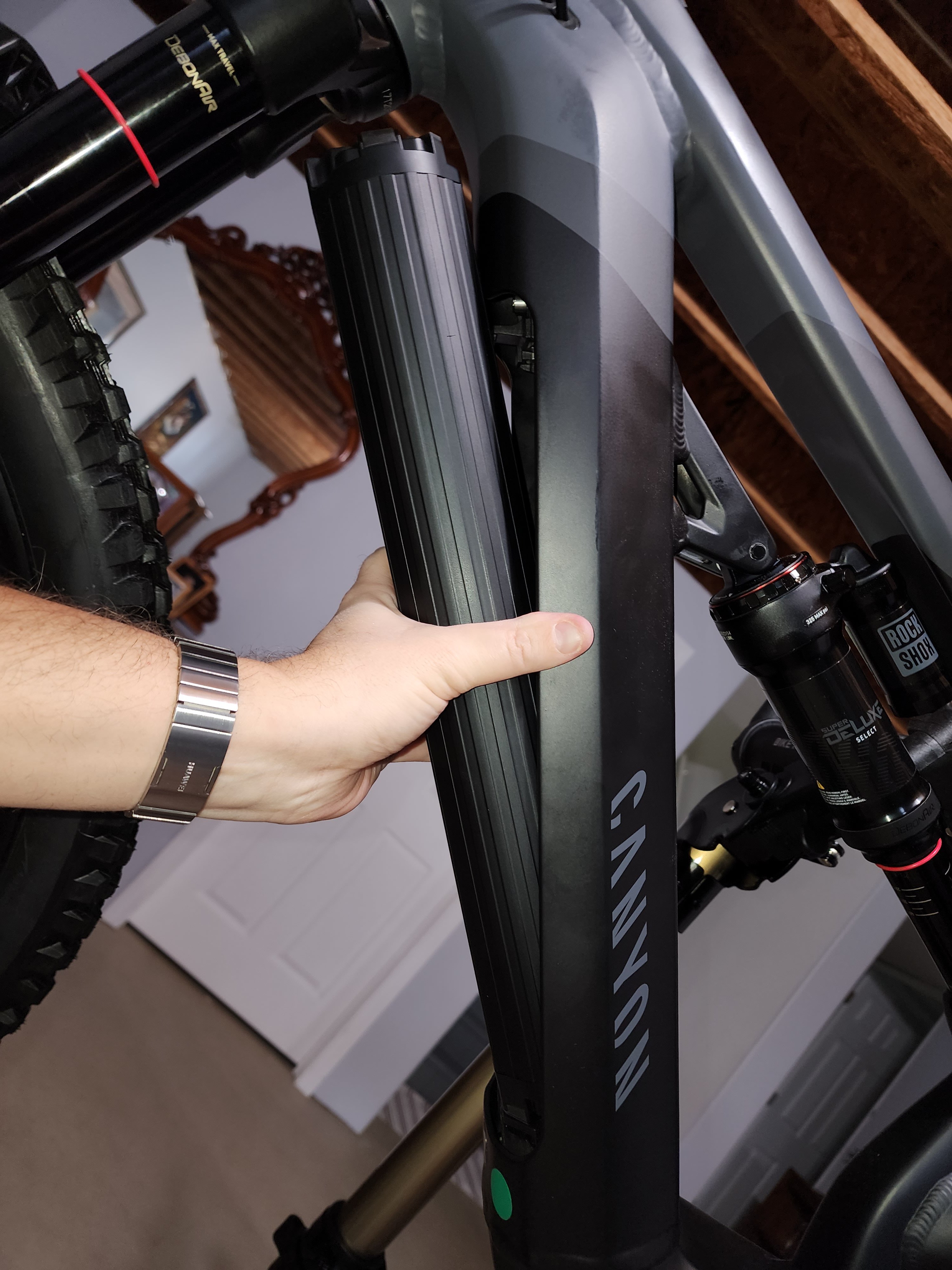

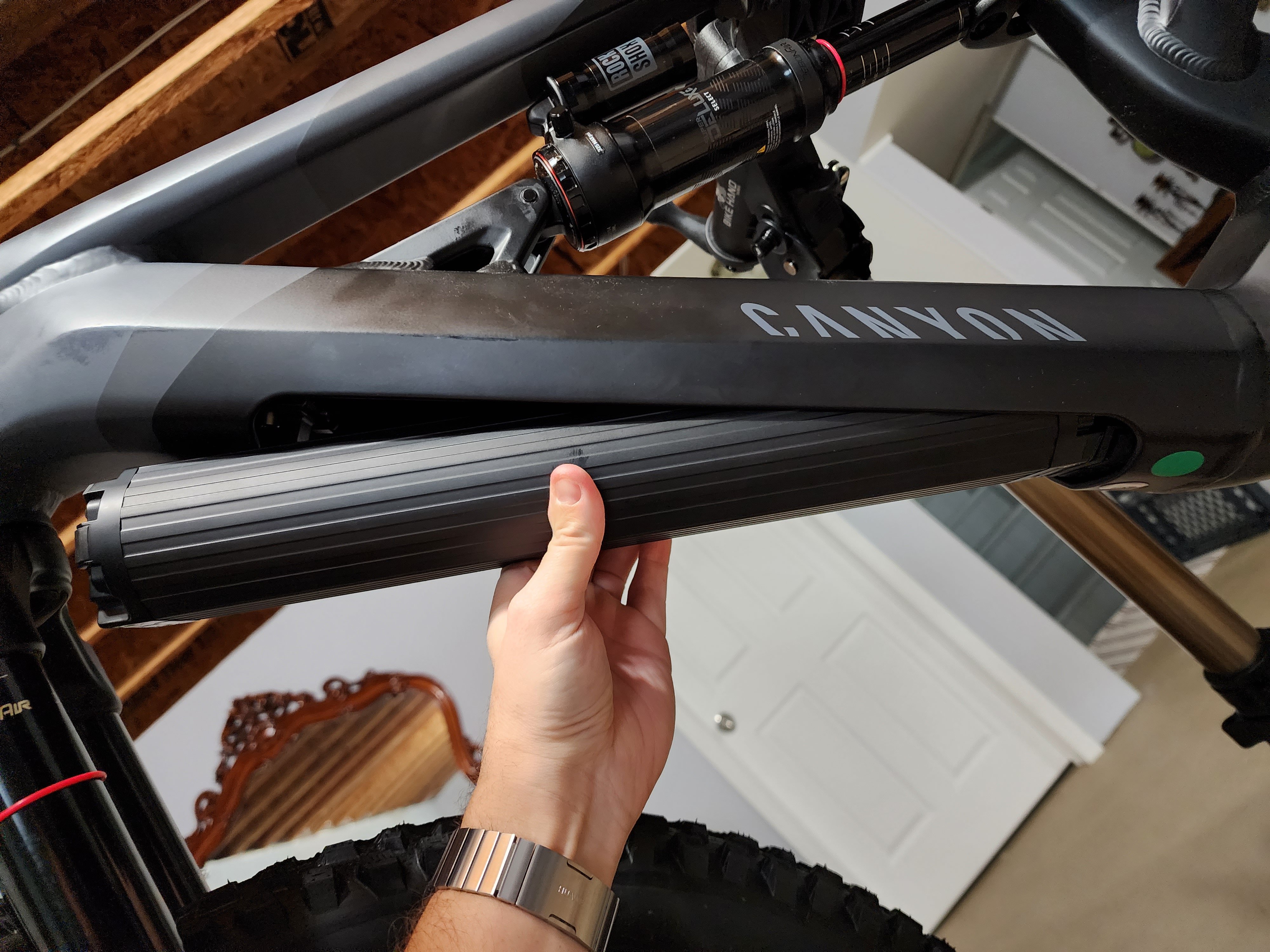

So the battery I ordered just came in (Shimano BT-E8036) with much excitement. But when I unboxed it and held it up to the downtube, you can imagine how quickly my excitement turned to disappointment once again. The battery is way too big! I'm feeling pretty defeated right now. If anyone has the Shimano BT-E8035 battery or the Shimano BT-E8035L one, could you please measure it for me and post in the comments? Thanks for the help everyone. Hasn't been a great start to the year, that's forsure.
View attachment 104487 View attachment 104488 View attachment 104489
Looks like the bike takes the short BT-E8035 battery , and not the long version like you thought.

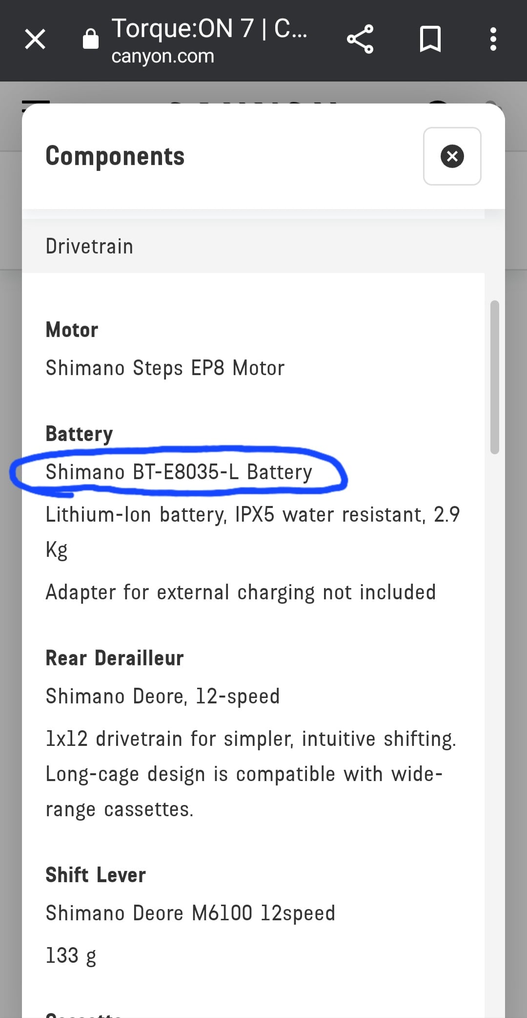

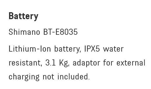

What is really confusing is that this is right from Canyon's website. And from what I've gathered so far is that the 8035-L and the 8036 were the same size and interchangeable. Not sure where to go from here.
looks like incorrect spec on the canyon website in that case.
The uk canyon website lists it as the short 8035 battery
Shimano website says that the 35 and the 35-L use the "same mount". I'm guessing (with hindsight) that this means that the socket they plug into is the same, but this may be info for frame builders rather than meaning they are all the same length etc.
Canyon website says 35 (no L) for me when I look, but this is only since 2021, maybe they used the longer one prior to that?
Either way, I think you are going to need to return this one and track down the E8035 (no L).
Good luck.

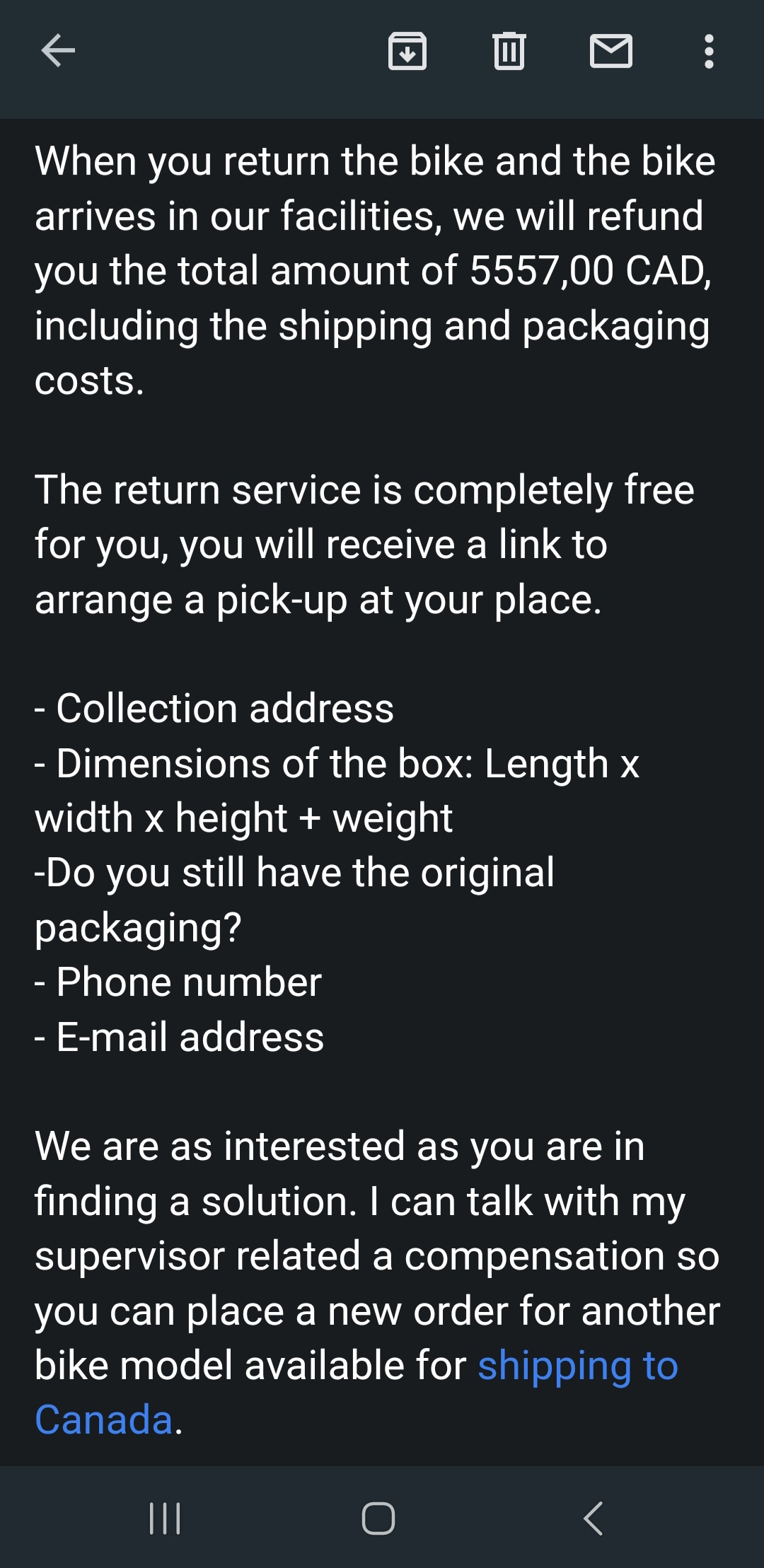

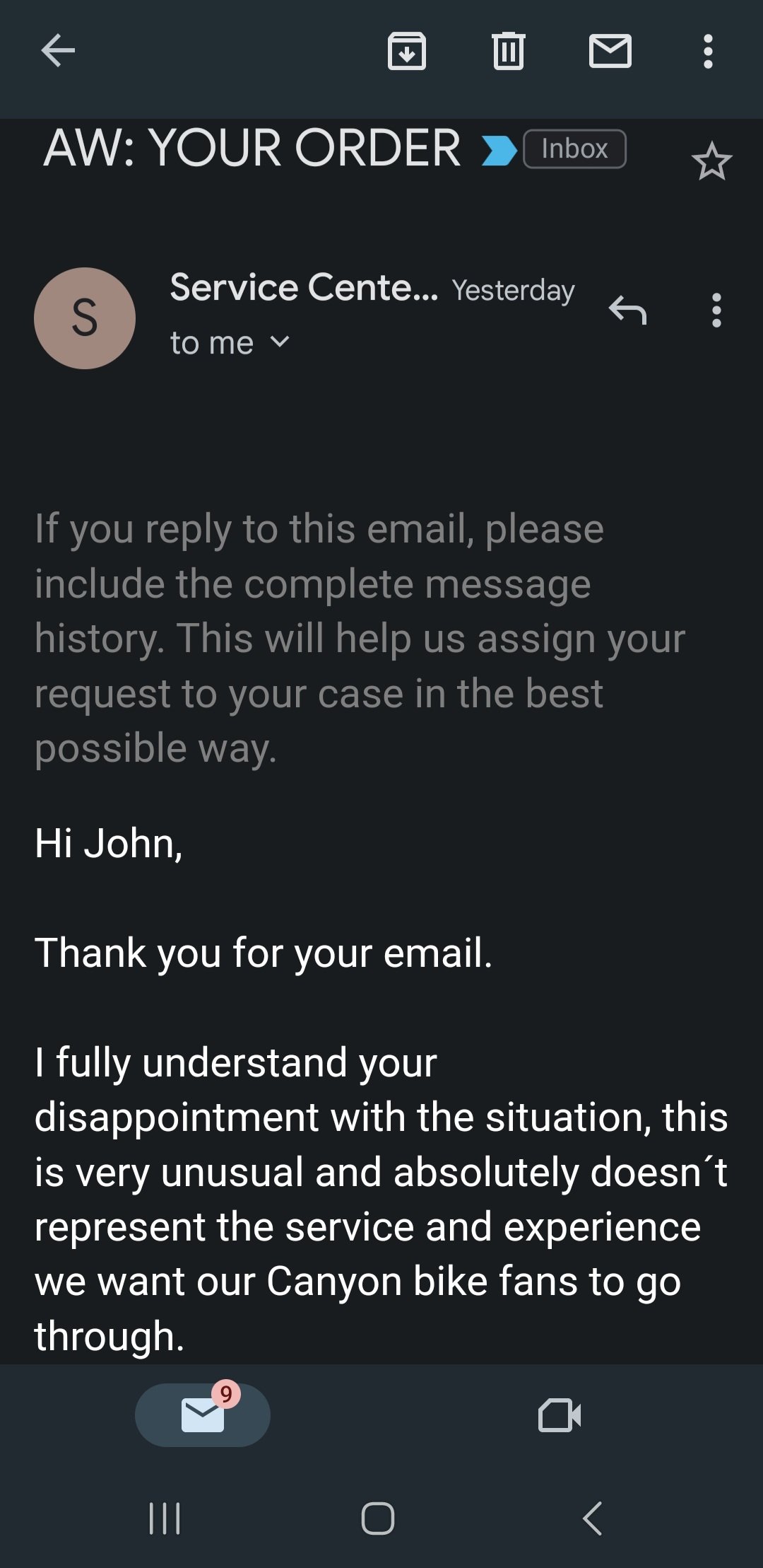

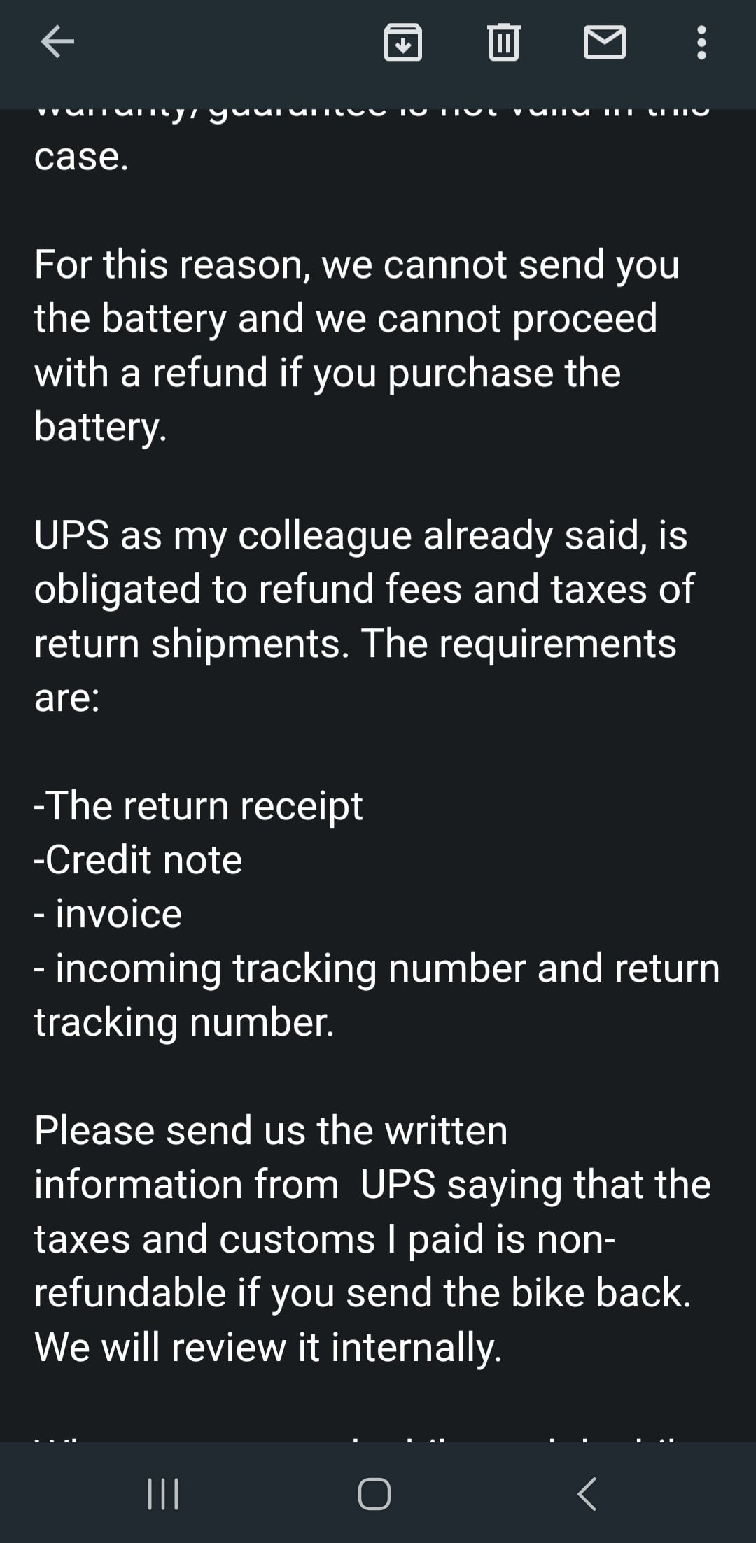

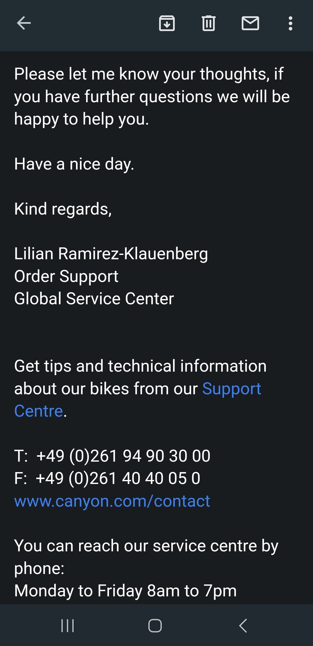

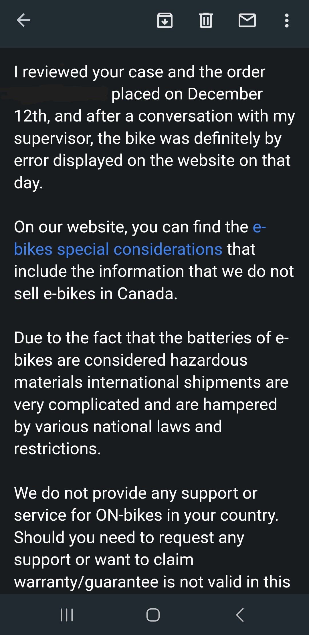

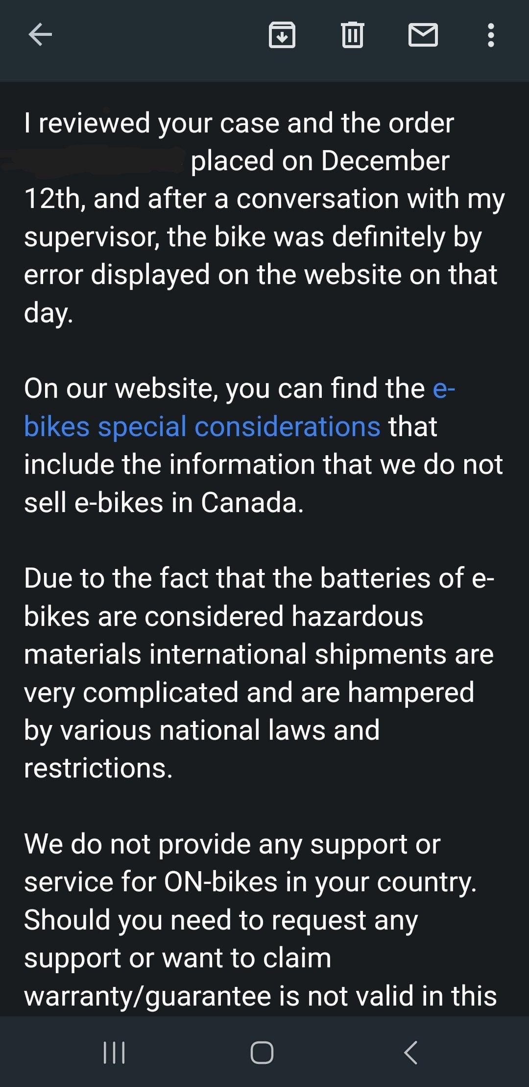

An absolute drama filled roller coaster. After multiple emails telling them that I was unhappy with their decision, I also suggested that maybe they could compensate me for the price of a battery, I could buy one and they reimburse me, or they could find a Canadian supplier, buy it and have it shipped to me. The last response I got was this. Might as well just screen shot the email rather than type everything lol. See pics...
Screenshot_20230112_192923_Gmail.jpg Screenshot_20230112_192934_Gmail.jpg Screenshot_20230112_192947_Gmail.jpg Screenshot_20230112_193004_Gmail.jpg Screenshot_20230112_193017_Gmail.jpg
For anyone who wants the short version of Canyon's answer, it was this: "Get fucked!"
