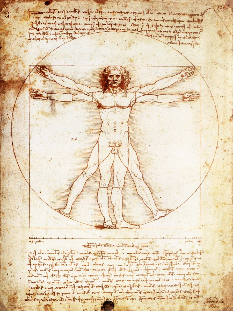

Multiply your height by .44
That might work for Vitruvian man, but it sure does not work for me!
