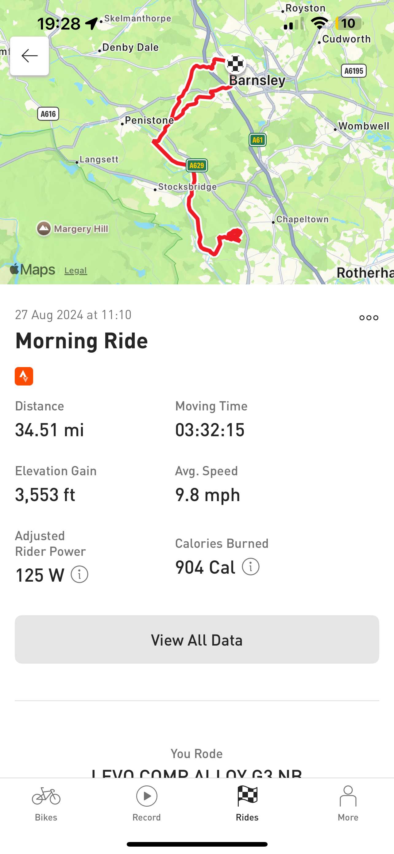

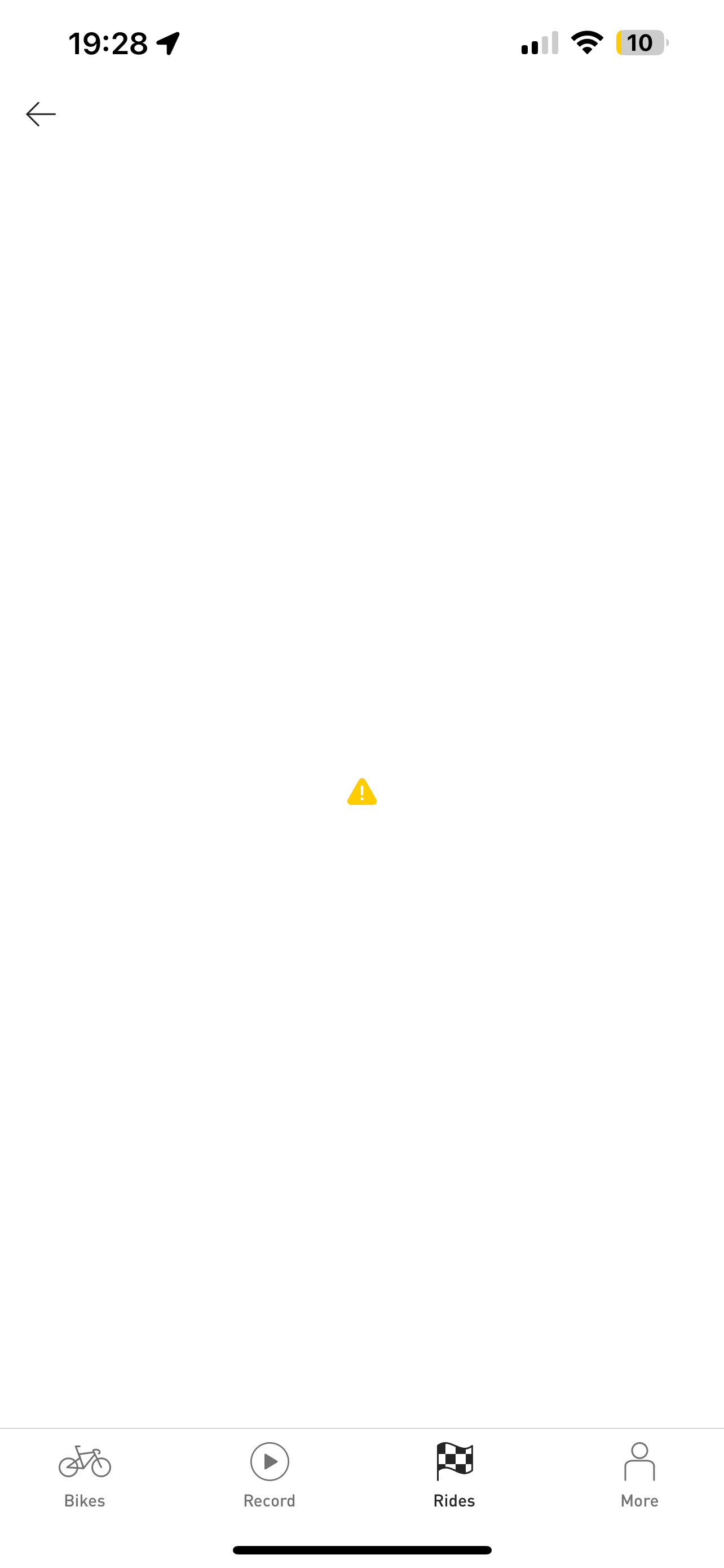

The update seems to have a bug on mine when I click on view all date I get only an error message
Saw the same bug fix message on mine, downloaded the update and... charge limit still greyed out. 🫣
