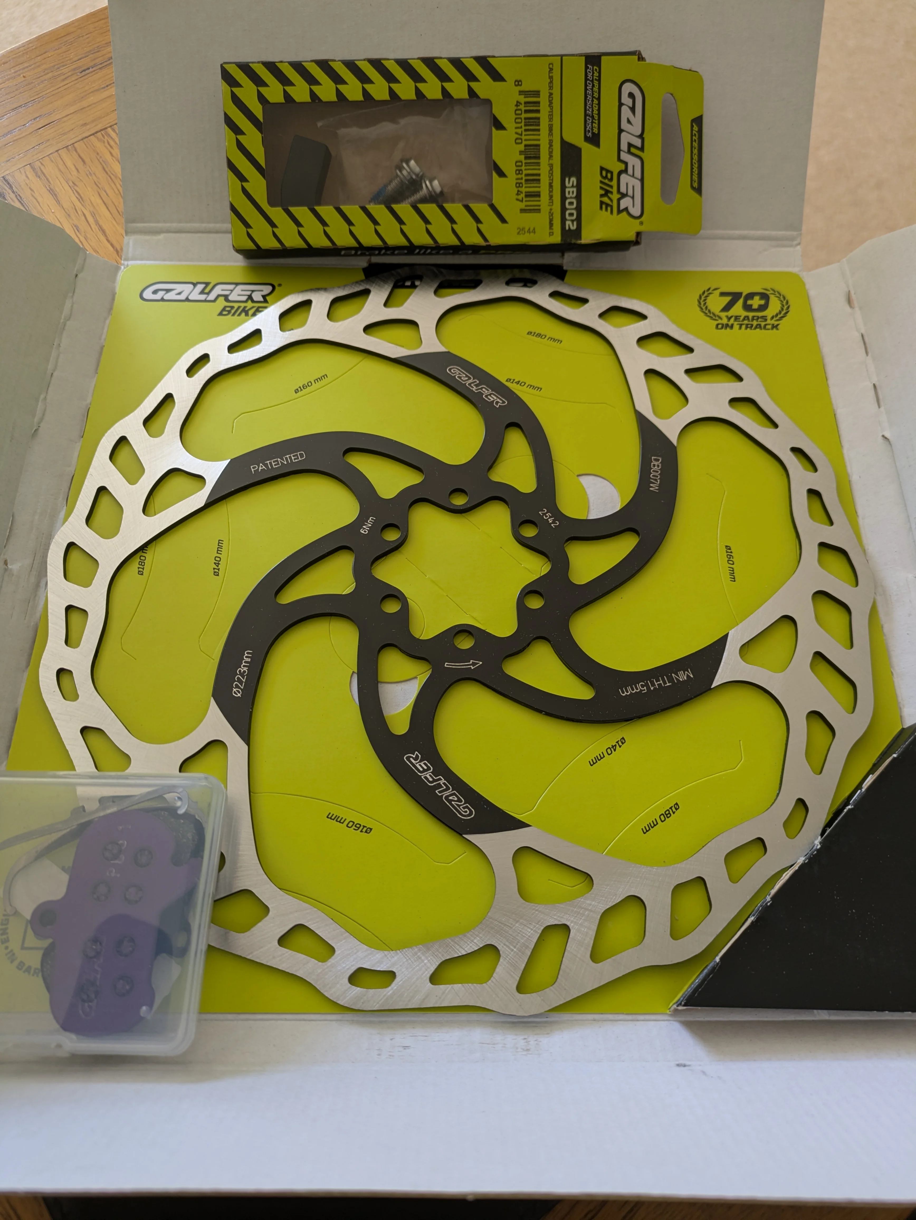

I'm waiting for the postman to drop off a 223mm rotor and galfer purple pads for my mavern bronze brakes on my Mondraker crafty.
At £20 I hope they are amazing 🤔
