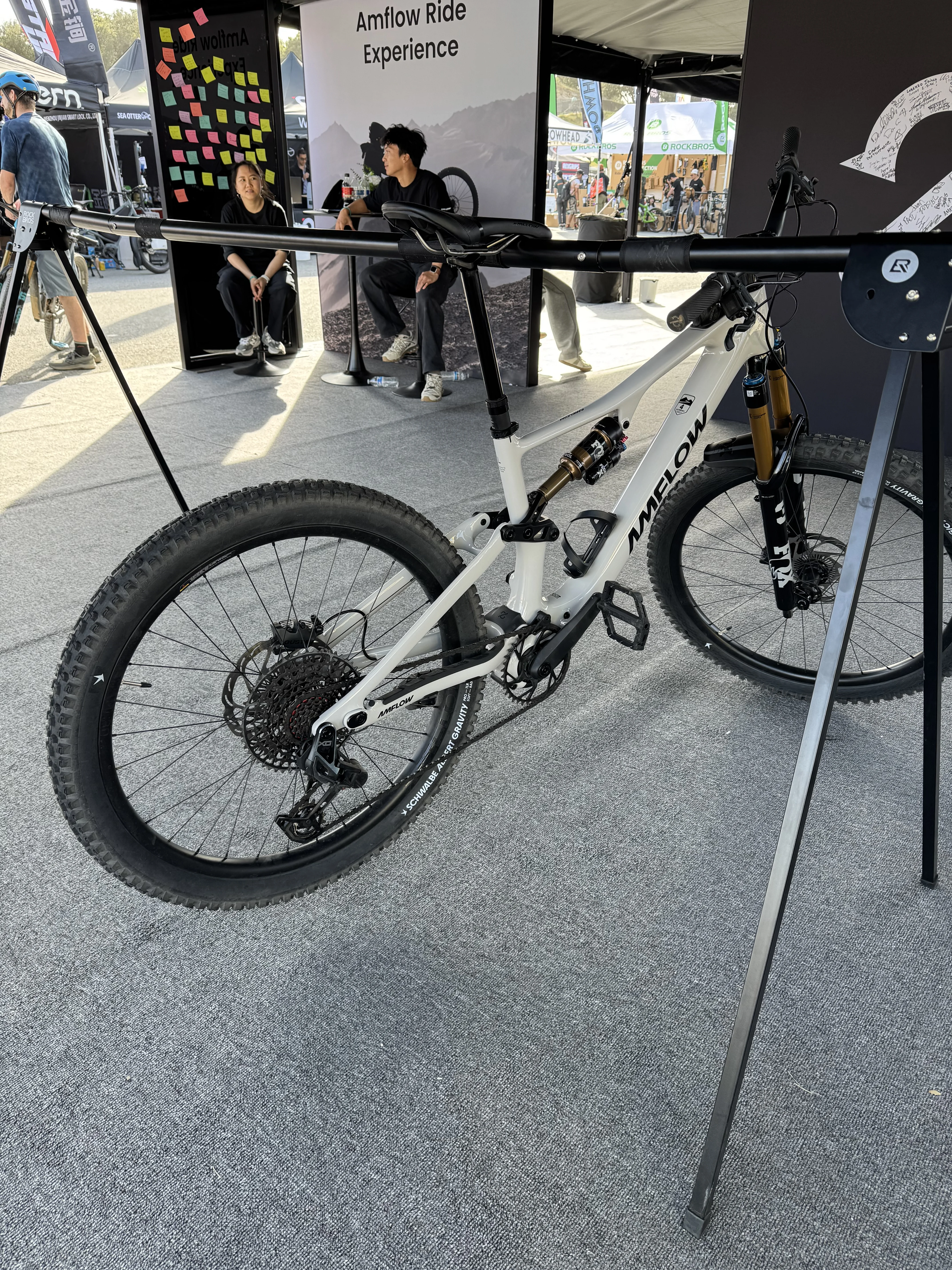

I was also at Sea Otter and this was my first chance to ride the Amflow/Avinox bike. While the motor was amazing I felt the geo and suspension wasn't on par with either the Santa cruz Vala and the Pivot Sl that I rode there as well. I know these bikes weren't set up specifically for me but it did make me think I'd want a more established brand that was running that motor.
Sure wish I could have ridden the Mondraker ...

I feel at this point Amflow is an established brand now, Just not a prestige brand. Tried twice to test the AMP'd but kept getting squeezed out of scheduling a ride. The good thing is that you have wide choice as to what bike you want with that motor (funny that's it's got to this point). One thing I came away with brief demo testing is just how much the experience is dependent on bike fitting and suspension setup. Luckily I was primarily focussed on testing motor versions, so rideability took second fiddle. And I didn't have much choice - The Teewind Flux had an over-spring coil shock for my weight and backing it out can only do so much. Next time I'm bringing a shock pump for air shock setups. The best suspension setup I rode that day was oddly enough the Rivian/ALSO TM-B. It was somehow well-turned from the get go.
